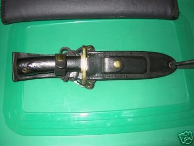

If micarta is burned enough so that there is visible blistering, is it likely that there is significant depth of penetration weakening the strength of the handle. Is the pattern visible going to be destroyed, or will it return once the damage material has been ground away.

Haven't done micarta yet, but it's built the same way as G-10.
I occasionally burned a spot on the G-10, it burns the glue, and the 'hairs' of fiber are frayed there. With Micarta the same would be true, except micarta has more of a pattern usually.
It depends on the burn. Why not sand a little and see? Is it a special piece? Depending on the intensity of the burn and how thick the piece is, it could be 'unglued' all the way through, or just a spot. Give us a few more details.
Ahh...rereading your post, I guess this is a hidden tang knife?
how did it happen? Grinding I assume. Well I can see hesitation in re-doing it. If it's for a customer I'd just grind it until it either looks good, or will have to be redone, and fix it.
Hope this helps, Kinda feel silly though, giving advice without having ever touched the material :rolleyes:

cliff,
Before you grind away, remember what made it burn the first time. Dont want to keep burning the micarta. My guess is a dull sanding belt was used.
Let us know what happens.
Cliff, hand sand the entire handle so it stays even. If you just sand the burnt area, you'll end up with uneveness. More then likely only 1 or 2 layers were affected. Micarta is pretty durable material. Resanding it will bring back the original pattern since micarta is layered. Hand sanding will take longer but will lessen the chance of reburning it. I'd say start with 80 grit and work up to 600 grit. If you put it to a buffer, be careful that can burn it all over again.

Cliff,
What I would do is tape off the harware really good and go to town with 60 grit, the go up to 400 grit blending it in to the non damaged areas. Maybe do the same on the otherside to keep that side the same shape.
It may be in your best interest to send it back to Randall for repair.
Scott

I don't have it, the owner had already contacted Randall. He bought it on the secondary market.
-Cliff

I'd guess the pattern will be fine after sanding 1/16" past the delamination. The bubbles on that knife look to be deep and removing them is going to really mess up the handle. I'm not sure sanding past them is going to work with out really messing up the contours, lines and feel of the handle.
