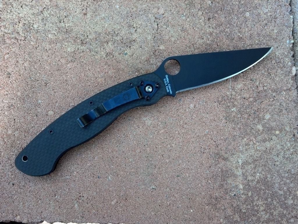

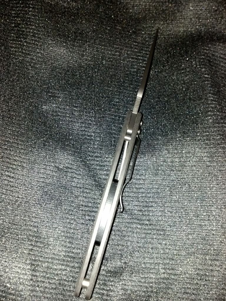

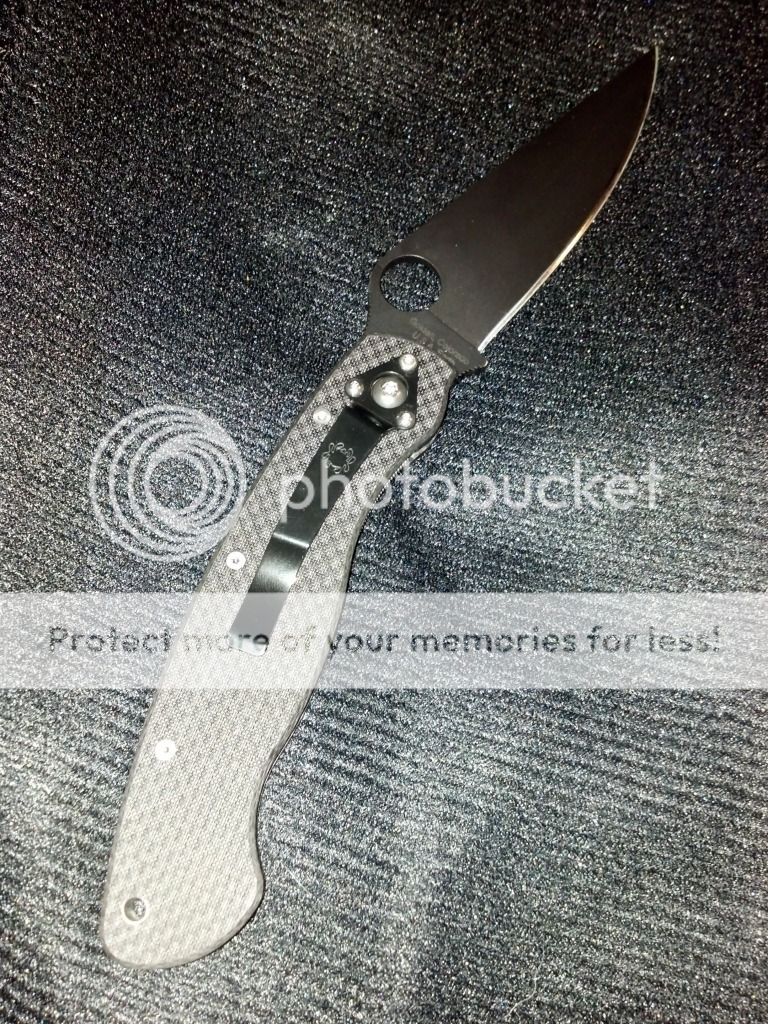

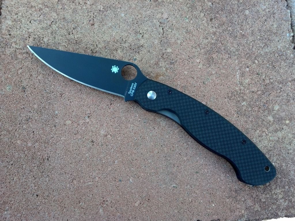

the stock scale screws are T6 torx w/ a 2-56 thread, flathead. I replaced those with T8 2-56 flatheads.
the clip screws are T6 torx button heads. I replaced those with T8 2-56 button heads.
the standoffs are 0.165" in thickness, they are threaded for 2-56 screws.
before:
after:

Does anyone know if the flanged standoffs will work or do you have to use the flatsided ones? In the pics above they look like the fancier flanged type
