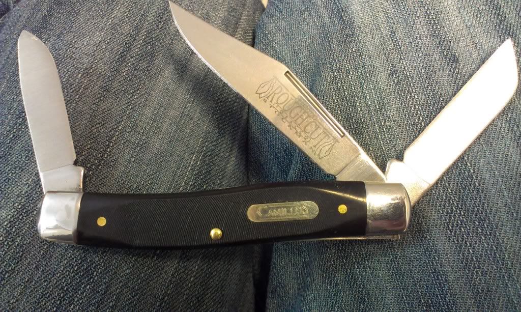

I have the exact same knife 357. :) Well, except that it's Camillus branded and has Delrin scales.
If you have the time would you mind posting a close up of the tang stamp? They ground the stamp off on the Camillus branded knives, but I believe I can make out part of the A and definitely the N in Craftsman.
Either way I'm looking forward to seeing your completed work. :thumbup:
Oh and great work mpp!

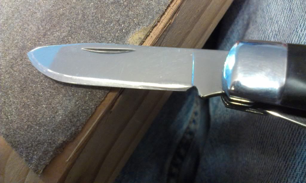

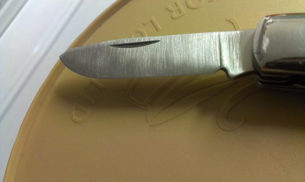

Well I tried pretty hard to get a pic where you could see my ground tang, but light and reflections won the battle.
This is the knife I have.
I like yours better for the brass. :)

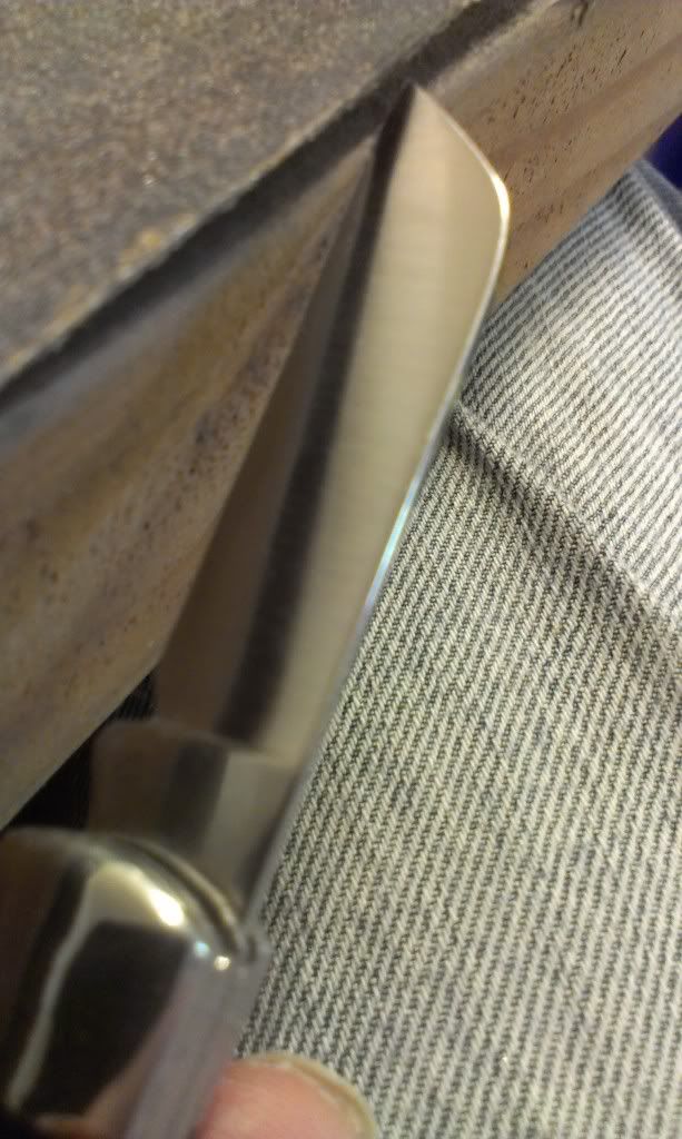

Also, I'm not sure if yours were sharp, but all of my blades we're dull. I spent a lot of time thinning both of the small blades. The blade stock was too thick for my taste so I ground them much thinner.
