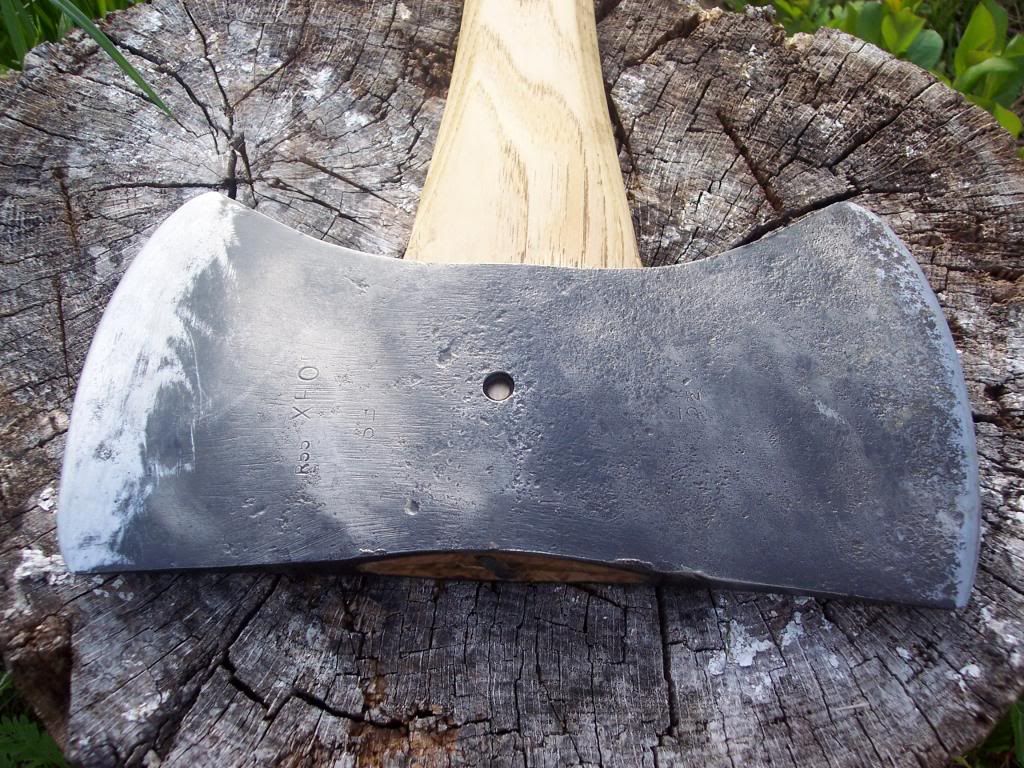

I've cold blued a couple of axe heads with pretty good success. I've been using Birchwood Casey gun blueing. What I do is:
1. Clean off all the rust, paint, or whatever I want removed before I blue the head
2. Use a belt sander to get it really clean (careful not to overheat it, I usually dip the head in water often so it's not hot to touch with my bare hand at any point, this is to protect the temper)
3. Further clean the head with denatured alcohol to get off any residual oils that could affect the finish.
4. Dry it off
5. Apply the cold blueing with a wool dauber or rag, I prefer a wool dauber personally. It helps if it's warm (like sat in the sun for a half hour or run under hot tap water for 30 seconds level warm). I've used hot water and then dried it, that worked good. I've had good luck applying it perpendicular to the bit (basically in a back and forth motion to make smooth lines like you're painting). If it's a little warm, it will get dark... Fast. I blue all sides of the head. Top. Bottom. Left. Right. Inside the eye. Wherever.
6. Let it set for 5 minutes or so.
7. Use a really fine grit sand paper (1000 grit ish) or scotch brite pad with some water to take off a little bit of the blue to even it up. Take off as much or little as you want, you get to choose what you want it to look like, I tend to like the look with a little more taken off, then a second application.
8. Repeat steps 4 thru 7 until it looks like you want.
9. Oil the head with whatever oil you prefer (I've been using 3-in-1 with no issues)
10. Rub the oil in with some bees wax to maximize the protective layer (since honestly all my axes are for fun not hard work :/)
Then I hang the axe. Check out the axe to grind video. It's where I learned to hang one. Works good. I don't use the wood swelling stuff personally. I just use boiled linseed oil. If you take your time, you can get it really tight with just a wood wedge. I save the metal wedges in case I need to tighten it up in the future.
Good luck, feel free to ask me any questions and I'll share any of my limited knowledge with you =)
