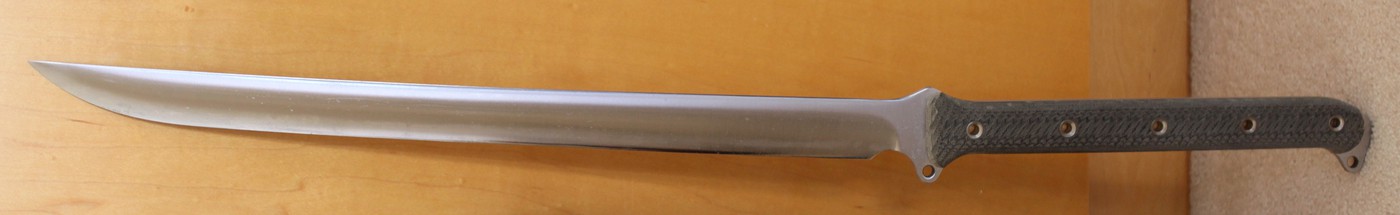

Here is my Banned AK47. I cannot adequately describe to you how awesome this blade is!!:)
It's beautiful! Forgive my ignorance but what does banned refer to?
I think I will use mine, woukd like to , but have lots of new things sitting in the gun safe I thought I would use lol. I have 200 acres with lots of trails and bush so I will try to make myself take it out!!
Thanks guys. Ban's work is fantastic. It totally transforms the blade into a lean, mean slicing machine!:D
