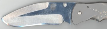

Anyone not too chicken to reprofile the edges on their customs?
I just lowered the angle on this Cucchiara Banshee. It's a massive .212 thick and the edge was WAY to steep for the Sharpmaker, so I fixed it so it would cut better, be more hair-poppin' and be Sharpmakerable.
I know, the edge looks really wide, but it's actually only a little less than the Sharpmaker's 30-degree angle. It just takes a long distance to get to the edge on a blade this thick. Recurves are a bit of a beeaatch on the Edgepro so the edge width isn't quite uniform in that area. The little crescent-shaped scratches on the flats are from grit on the Edgepro surface. I'm sure Matt will refurb those out for me after I work the heck out of this thing for a while.
I've reprofiled customs before, but before now I was do chicken to do it on a custom worth over about $200. I guess I'm keepin' this puppy now!

I have a Bill Ruple wharnecliffe whittler that I reprofiled all three blades on with the Edgepro. When I first went to whittle (Imagine that!) the thickness of the main blade and the steep angle of the edge kept me from being able to actually use it. It would dig in and snap the wood out without being able to make any nice curls at all! I did a double bevel on it and the other two blades and we're happy. It does, however, seem like the primary bevel runs about a third of the way up each blade now! Works well, no chipping (didn't go too thin), keeps a great edge, but I'm not so sure I'd be able to get what it's worth if I tried to sell it. Don't plan to though, so no worries.
Yeah, been there, done that. No big deal to me, whether a knife cost be $5 or $500 I bought it to be used. If I am unhappy with how it is working for me I will change what I need in order to make it work out.

I'd feel silly asking a maker to re-sharpen a knife for me. Besides, I didn't drop the money on an Edgepro for nothing. I'm happy with my results.

Looks like you did a great job! Are those scratches on the blade or just the pic? If the blade is rubbing the handle slab and getting scratched send that thing back to me and I will fix it up for ya! I'll even cover shipping. Hopefully its not rubbing and you just getting your moneys worth out of the knife! :D

Thanks! It doesn't rub the inside of the handle unless I loosen the pivot too much which I don't do. The scratches are mostly because the EdgePro gets some grit on between the knife and EdgePro table if you don't wipe it off often enough or cover it with tape. They're little crescent-shaped scratches (very shallow) from the knife wiggling as I worked. I'm carrying it daily now that I like the edge angle better. It's hair poppin' sharp now and wouldn't shave before. I can also maintain the edge on a Sharpmaker now which I couldn't before. It's just a matter of taste - I like a shallow angle on everything. Someday I'll take you up on your offer and send it in for a refurb and maybe a carved clip, but let me use the heck out of it first. :)
