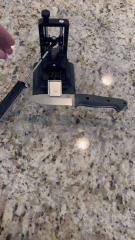

Hey guys, new to the group and I have a question I’m hoping someone can help me with. I’m basically a sharpening novice but have carried knives my whole life. I recently bought a worksharp precision adjust to be able to sharpen more accurately at home. I tried to reprofile my benchmade bushcrafter (s30v steel) and I’m not happy with the result. I set my sharpener to 20 degrees and worked through the stones (220, 320, 400, 600, 800, and ceramic). The knife is sharp, but one edge of the blade is probably double the width of the other. Before making matters worse, I wanted to get some advice. TIA.

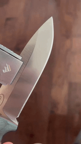

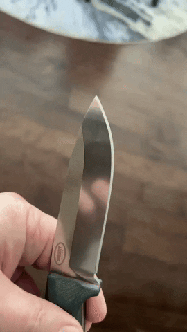

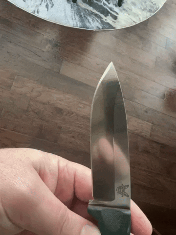

Sorry it took me a while to figure out how to upload pics. Hopefully these will work. My question is if I decide to try to even everything up, what would be the best approach to avoid unnecessarily removing more material.
The right side of the knife (edge down, point away) looks very good which makes me think your setup was OK. The left side has something funny going on at the tip. Can you take a couple of additional photos of that region with slightly different angles and lighting, including one from directly above the spine of the knife as straight and true as you can manage?
I was trying to check for errors in the blade grind from the manufacturer. I cannot be certain without examining it myself, but I cannot see any so I will assume that the asymmetry is due to the edge grind.
On many knives the edge thickness increases as you approach the tip, as the edge moves up toward the spine into the thicker part of the stock. This is countered by the primary blade grind also sweeping upward but typically not at the same rate as the edge. This keeps the tip of the knife stronger—good insurance for most production knives—but it creates a complication for sharpening. If you want keep the edge bevel angle the same throughout then necessarily the bevel will be wider in this thicker area. Conversely if you wish to keep the same width of bevel throughout then necessarily the edge must be at a more obtuse angle in this thicker area.
It appears to me that you ground the right side of the knife to produce an even bevel width, then ground the left side in order to finish the apex. The tip region, being thicker behind the edge,* required more grinding which resulted in a wider bevel there. To correct this you would grind only on the right side near the tip, taking care to progressively blend this back through the belly of the knife. This will widen the bevel on the right side in that area, while narrowing it on the left. When complete the bevels on both sides will still be wider at tip than the rest of blade, especially since you have taken off some extra material near the tip, making the behind-the-edge thickness greater. There is nothing wrong with this but it may not be the look you desire. If you do fine cutting with the tip I encourage you to accept this look and enjoy the improved cutting performance of a lower angle edge.
If you desire an even bevel width from heel to tip then you must change the sharpening angle along the length of the edge, with understanding that this will reduce the fine cutting performance near the tip. In a clamped system this is done by the position of the blade in the clamp. Since I do not use a clamped system myself I am not practically familiar with the amount of angle-change heel-to-tip that is readily produced. Nevertheless even if you cannot attain a perfectly uniform bevel width it would still be more even than before. I am embedding an image from another BladeForums thread for reference, the specific origin of which I have sadly forgotten. You would want to create the situation shown in the third image from the top, where the marker is being removed from the shoulder of the flat and the apex at the tip, so you would reverse the correction given in that frame and reposition with the tip CLOSER to the clamp.
I do not recommend that you attempt the differential edge angle before, without, or as part of the correction proposed in the third paragraph of this post. The reason is that making the angle more obtuse will initially narrow the bevel on which you are grinding, until the grinding reaches the shoulder of the existing bevel. This in my opinion will make keeping any sense of how the edge is centered difficult. If after performing the centering correction you choose to apply a more obtuse angle near the tip you can count strokes on each side to keep it centered.
