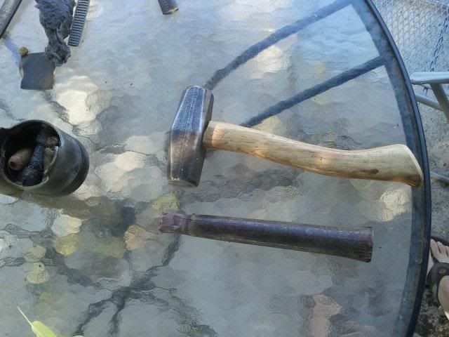

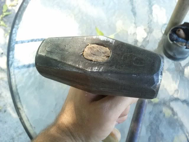

So the haft that came on my hatchet was broken at the shoulder. It was a good play toy for my son when I was in the garage working on stuff, but other than that it was serving no purpose. Well today I grabbed my 3# sledge and noticed the head was loose. I tapped the butt on the bench and smaked the wedge a bit. It came right loose again. So I decided to try that broken hatchet handle as a sledge handle. I just cut some off the front to make it the right size, cut a new wedge slot, made a wedge out of some myrtle I had laying around and you know what, it sure is a darned comfortable handle! I find that holding it out on the end positons the head for harder blows and when turned around and choked up it works well for more delicate work.
Let me know what you think...
I may just go get a metal wedge to add to the handle to help fill the eye a little bit better, but it feels rock solid for now.
