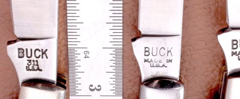

FYI Next newletter will have a history article with photos on the 311. Heres photo to tide you over.
300Bucks
These are the only two tang stamps you will see, every other difference will be somewhere else on knife.
