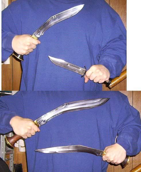

Just for fun, I got some comparison pics anyway.
Top: 12" Ka-Bar (old and with no handle) and 15" Sirupati
Bottom: 18.5" Chainpuri and 21.5" Chitlangi
AKs would be much broader than all of the above, of course.

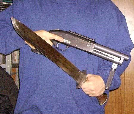

And just for even more fun, this is a pic of my EDC. ;)
