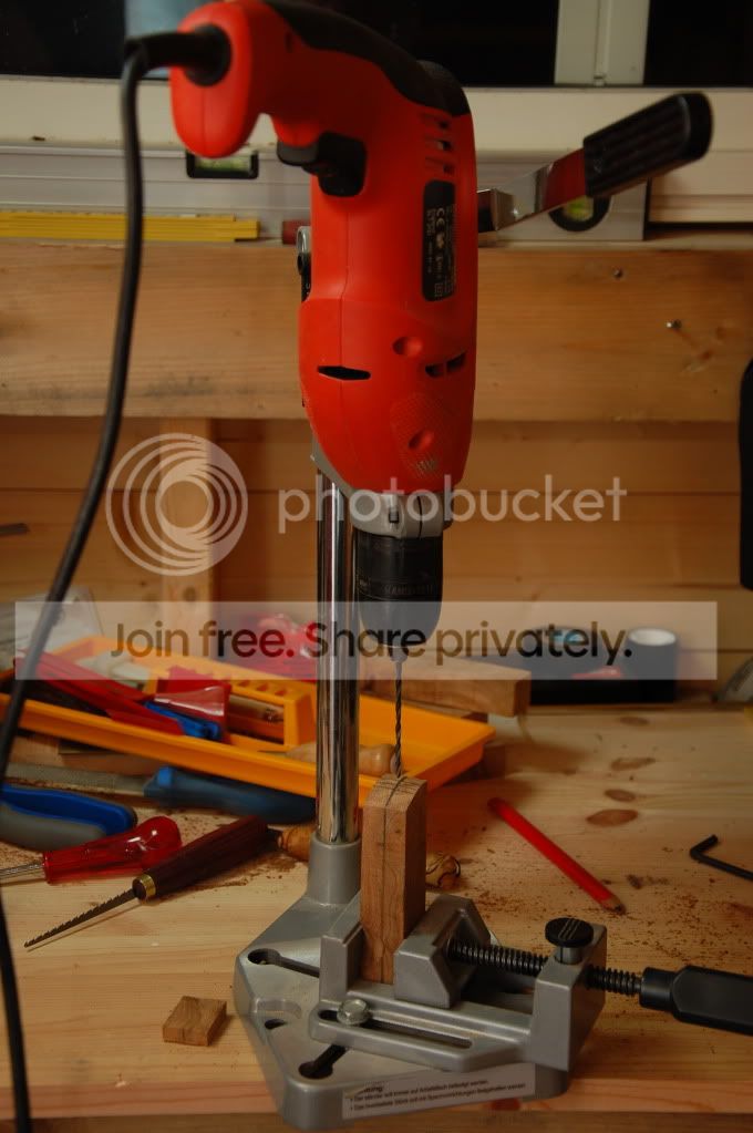

1) As I want to make an all wood handle first (no bolsters, guards, or spacers) - To drill out the wood from the front - I would need something like a 3/32nd drill bit that is about 4 inches long. Do they sell such a thing - and does it make sense to use it? (i.e. does it bend or warp in the wood due to it being so thin and long?)
2) What files and saws do you recommend for doing the work inside the wood once i have drilled it out. Bruce Bump uses a 'broach' but I don't even know what that is! ;) Bergman uses a small saw blade - does anyone have a source for such a small device?
3) What rasps and files would you recommend for finishing the handle once secured.
4) As the knife i am using does not have a tang long enough to peen - I will be epoxying the tang in place - or in this case adding a pin or two to the knife for security.
5) The tang I am starting with appears to have an annealed tang as it is easy to file. It also already has a hole in it. Can I simply use a brass rod that fits this hole - or would you recommend another type of material or device?
6) Is one pin enough - or should I add two if I can?
7) Once I have the pin in place - I am sure it will grind and sand at a different rate than the wood around it - any advice on making sure the pin doesn't stay 'proud' of the wood.
8) I know many people talk of using a slow curing epoxy for these applications - any brand names of places of purchase that can be recommended?

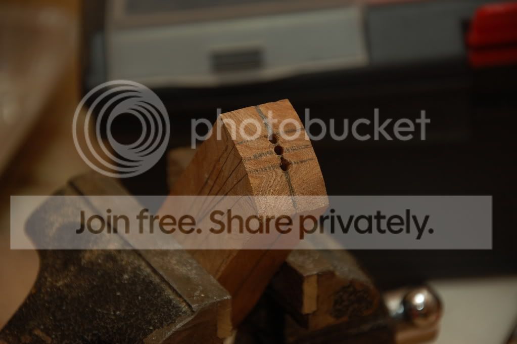

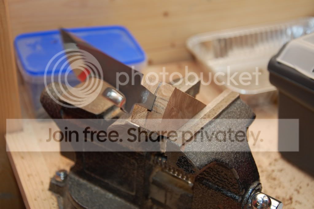

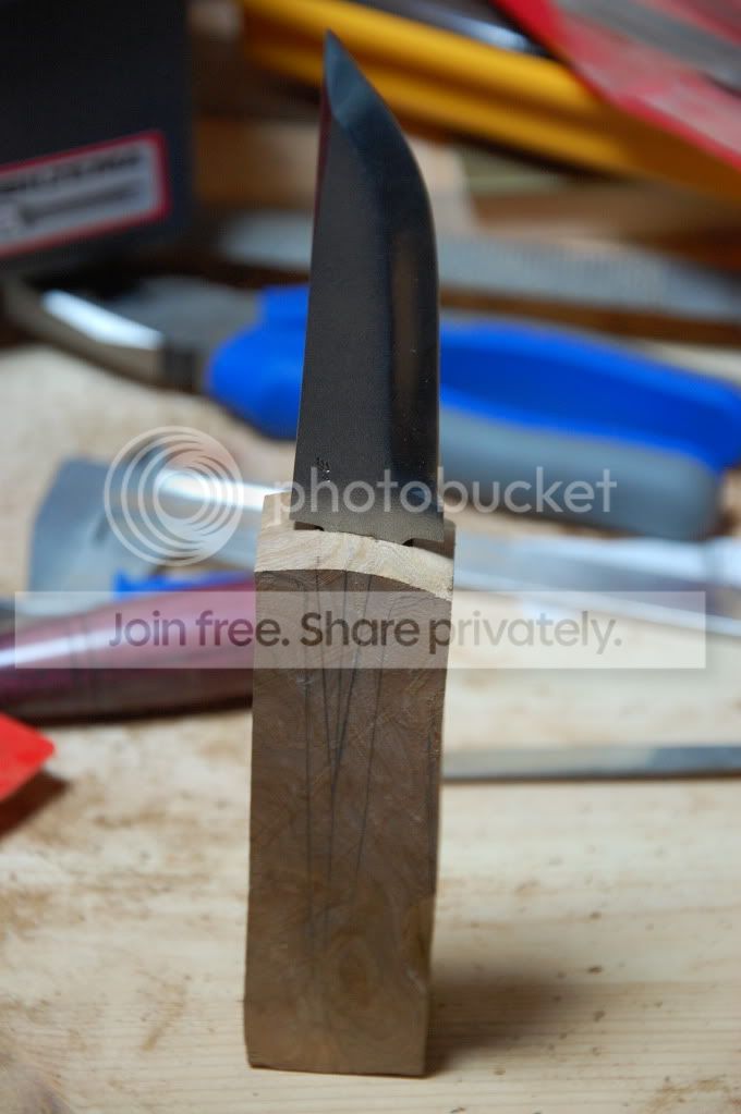

If you want a simple wood handle without any kind of guard or bolster then you have 2 choices in the construction. 1) Keep your block whole and drill/rasp a cavity for the tang, or 2) do a mortised handle (similar to a full tang with 2 piece slabs, except the tang will be hidden when done).
A broach the way Bruce Bump used it was basically a saw with a wide kerf that cut on the pull stroke rather than the push. You can make one with a hack saw blade that is ground to fit the tang hole.
Here's some tutorials that might help on the first method I described: http://home.comcast.net/~bradjarvis3/knife_instructions.html
http://www4.gvsu.edu/triert/cache/articles/gl1/knifemaking1.htm
And the mortised tang construction: http://www.americanbladesmith.com/i...nstalling-a-guard-and-mortised-handle-how-to/

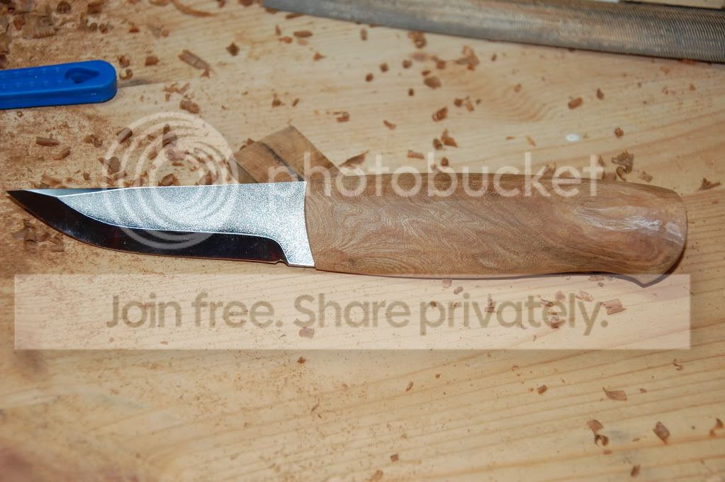

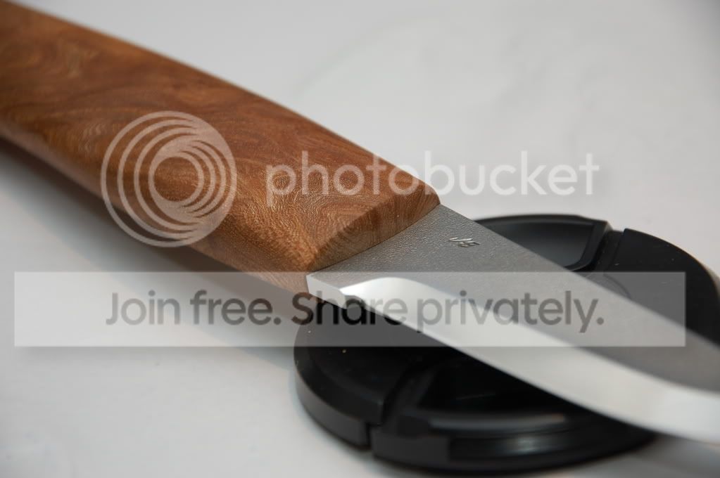

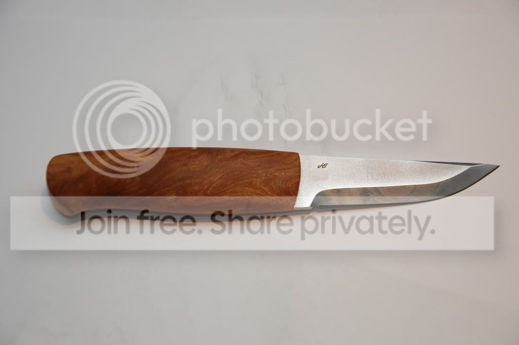

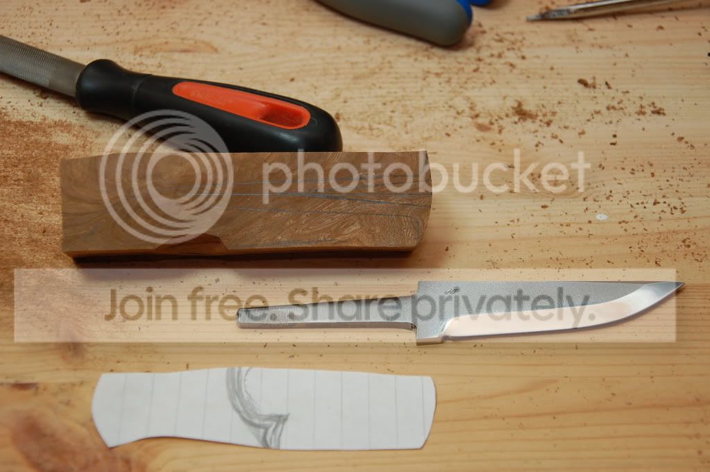

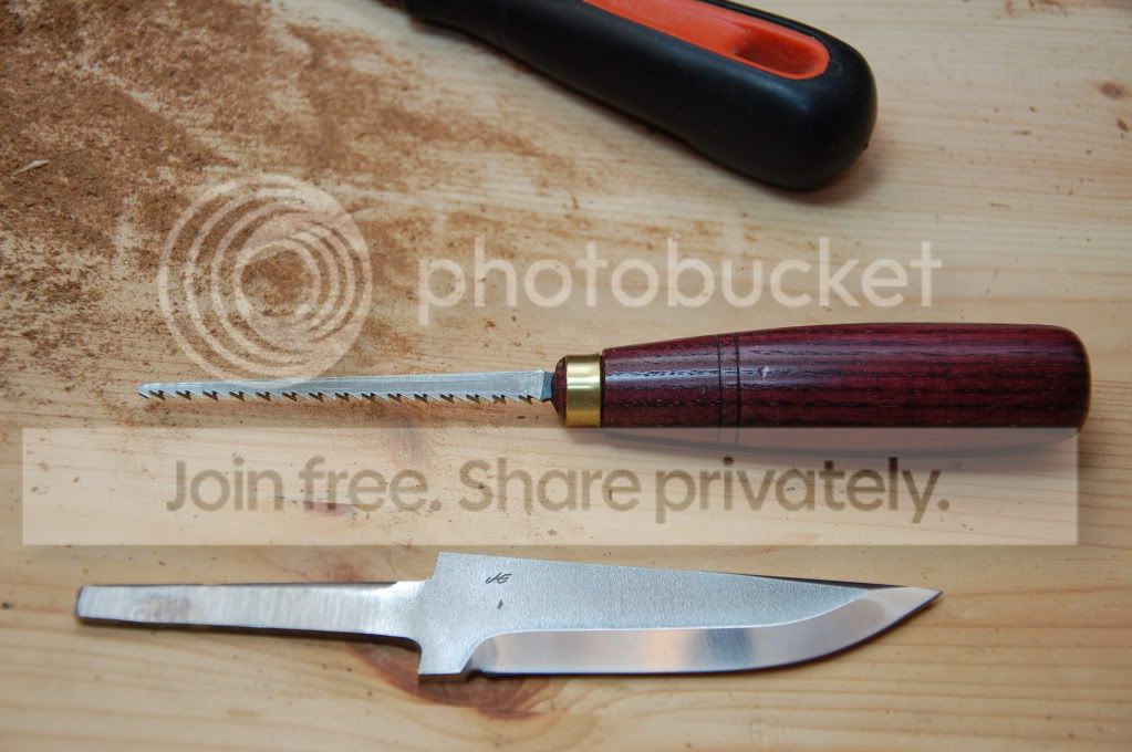

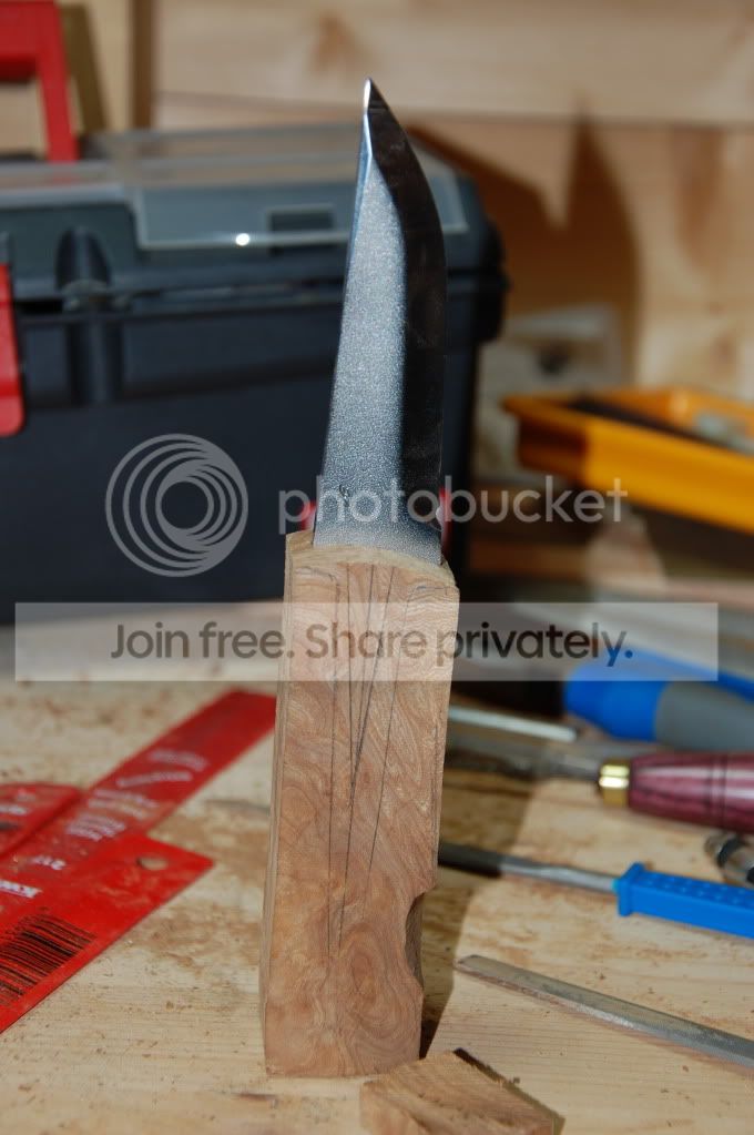

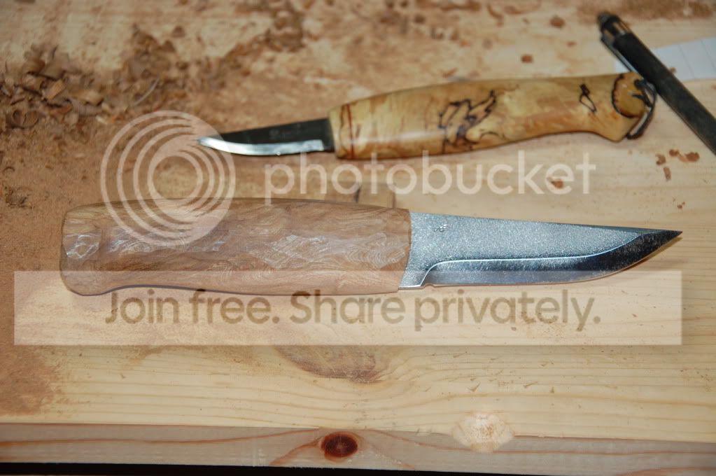

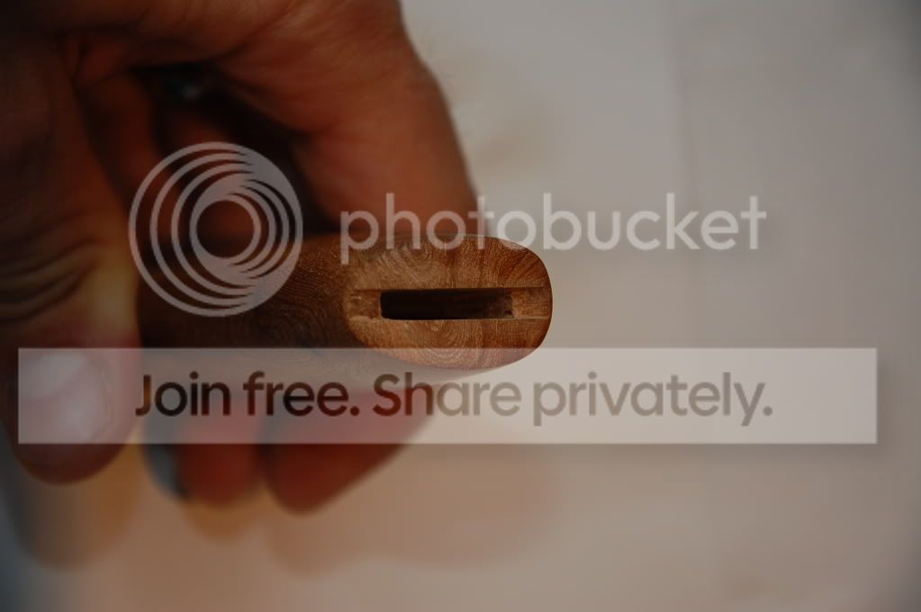

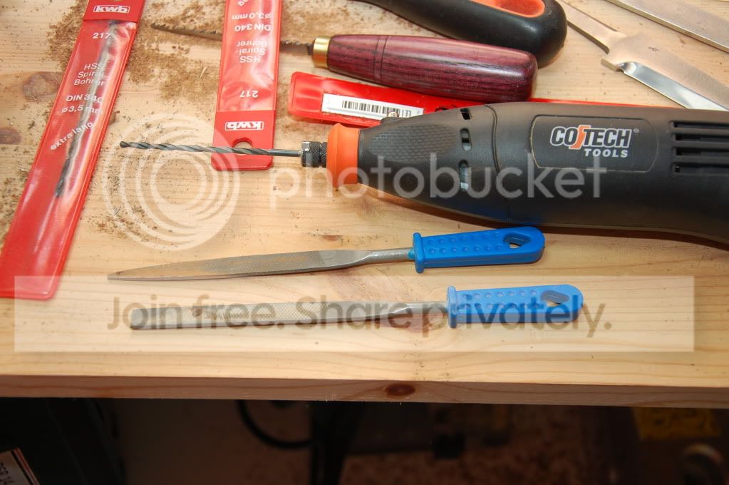

I always thought this was a great step by step example of what you’re looking for. Forgot who the maker was, but he did a great job....
Good luck Tal, and great work on those sheaths….:thumbup: - Larry

For the clamp, use a woodworkers two jaw hand screw clamp.
http://www.woodcraft.com/Category/2082689/Handscrews.aspx
Make a shallow depression, about 3/4" round in one jaw, about 1.5" in from the end . Set the butt in this and the tip on the other jaw. Position the tip so the clamping force is straight down the knife. Check before the epoxy cures that the handle in straight to the blade.You only need to clamp hard enough to hold things in place....don't over clamp.
Cutting a 1/4" wide slot about 1" deep down the other jaw can make it ,more versatile, as it can clamp against a guard, too.
