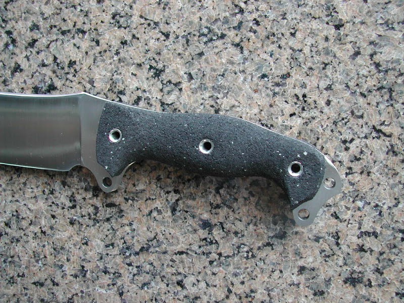

Anything like this:
CHECK OUT THIS THREAD:
http://www.bladeforums.com/forums/showthread.php?t=577706
Nice Will! Is that a competition type chopper? The scales look hand friendly...:)
That was a Randucci brainstorm that turned out looking great--see link to his thread at the bottom of my post above. Never heard a review from him after he did those--I'd be interested to know if he was happy with the result after giving it a workout.
Yes I remember Randucci doing those .... the material is some sort of stable matting used on competition blades ....
If you wanted the grip comfort of Res C without disturbing the balance point of the blade then going down this route would work.
My enjoyment of the Res C knives though comes a lot from the weight saving in the Knife ..... the hidden tang which when balanced with the right blade gives a weighted forward feel to the knife enabling chopping ability to be the same as heavier blades with a full tang ....
For me Res C blades maximise the performance to weight side of things as well as being very comfortable ...

You can buy horse stall mat at the local feed and farm stores, its a compressed rubber so it cuts and machines pretty easy. Since Res-C is "cast" onto the grip I'm not sure how it would work on a full tang knife.

Not scales, if the tang is exposed you lose all the shock absorbing qualities.
