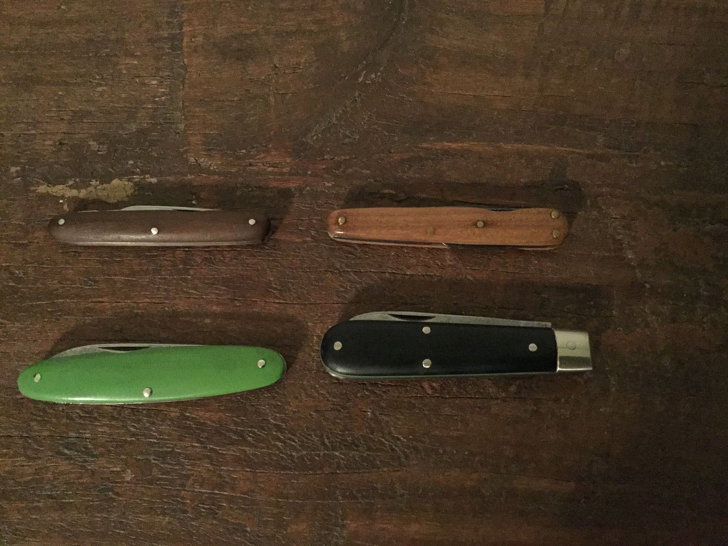

If the springs and blades are in good condition (they appear to be from the pictures) you can just remove the hollow bolsters and replace them or make the knife into a shadow pattern.
Not the best picture, but top left knife was a shell knife before I put on some new “Texas Ebony” covers. I don’t have it after giving it to my brother or I would take some better ones:)
