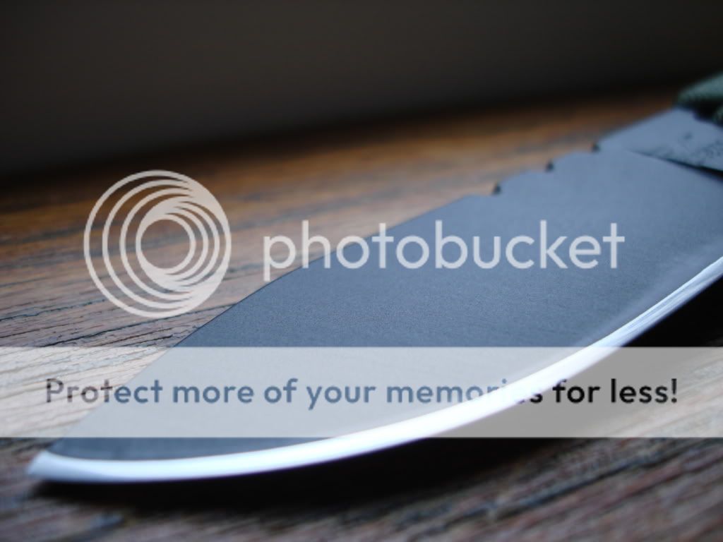

I'm guessing you've learned the basics of sharpening by using the Sharpmaker, so I would suggest learning to freehand on stones and sandpaper.
I've used alot of sharpening mediums and I've narrowed my favorites down to folding double sided DMT stones, and sandpaper/strop.
Here are a few pics of my BK-11 that I convexed with sandpaper/strop on leather backing...
...my camera has trouble focusing on tips, but I can tell you that the tips of all my knives turn out very well with this technique. :)
By the way you can find plenty of how-to's on youtube, as well as on the maintenance sub-forum right here on BF.:thumbup:
