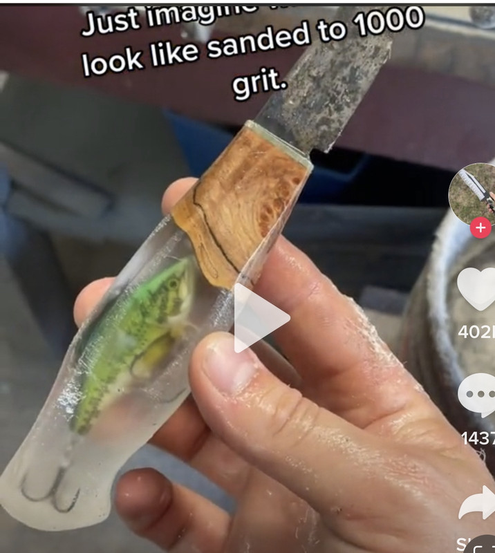

Good morning, I received a request recently to make a fillet knife with a resin handle with the tang of the blade inserted into wood and a fishing lure placed inside the handle below the tang.
I’ve never made a resin handle before, so any tips or tricks would be appreciated.

So the handle would be half wood/half resin? You will need to plan carefully how to set the tang and the lure in the same handle. Live edge burl with a partially inset lure and a light blue or clear cast could look nice. Shorter tang in the wood part and two pins to make it strong. You could make the lure look like it is swimming out behind the reef. If inset in wood lure would make the resin part also stronger.
Something like this one
You need something mechanical going through the wood/acrylic joint, or it will break under pressure.
I suggest using Casting Craft acrylic from Hobby Lobby. It dries clear and hard. You can use multiple layers, and it can be mirror polished.
