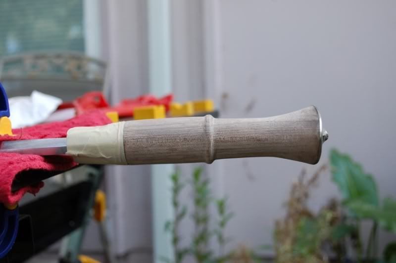

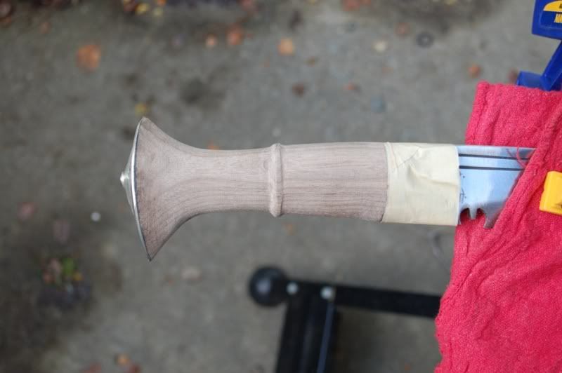

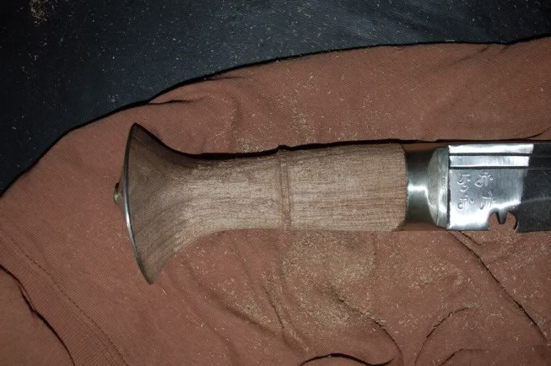

I just received my first khuk from H.I. and overall am really pleased with it. It is a Bhakta GR/BC from a DotD from earlier this week. It's 18.5" and started out at 34 oz. The one problem I was having with it (and going through some of the older threads noticed others have felt this way about some of the bigger khuks) is that the handle was big.
This morning I started to take it down a bit, and am getting to where it fits much more comfortably (and firmly) in my hand. With this, I have two questions. Any input is appreciated.
Q1: Which fingers should the raised handle ring fit between? I am thinking the ring/middle fingers, but was wondering if anyone has any different ideas/reasons for something else. I haven't completely decided whether to keep it or not. Besides tradition, does anyone have an opinion about keeping it or not?
Q2: I have seen where people recommend tung, mineral, and various other oils for wood handles. Is there any particular treatment that works with neem better than something else?
I have added a few pictures of what I have done so far. I have spend about 3 hours today (it's been raining, so couldn't play if I wanted to). Any comments or critiques on that are appreciated as well. I will add a few finished photos in the next few days.
I am trying to keep much of the original shape/style, just make it overall smaller and more fitted to my hand. I have taken off about 1/8"-1/4" around the circumference (I didn't officially measure it before I started). Some of this was done by making the handle flush with the bolster. I also moved the raised handle ring up closer to the center of the handle (about 1/4" toward the blade) because it sat right in the middle of my ring finger. It is still rough as I need to get some fine grit sand paper, but wanted to get treatment suggestions to save myself a trip to the store.
