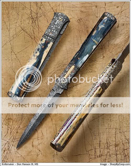

I used a latch or rocker bar release. I didn't machine any parts, but did use a mill to cut the slot in the bolster for the rocker. Here's one of the last ones I made.
