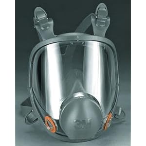

I know that the positive air respirator would be about the best I could get, but its just a touch out of my price range after building my grinder. I also know that I need some sort of protection till I can afford it, that or let the grinder sit unused for a few months. What I am looking at is this respirator and this face shield to do me for now. I know the shield will work, but I am unsure of the respirator. Does it meet the requirements of what a knife maker would need or does it fall short? If it will do the job I don't look at it as a waste of money even though I plan of getting the positive air unit in the future, I look at it as something I can let others use when they are in the shop while I am working or as a spare if I have problems with the better unit after I get it.

Hey man - Been there, done that. Didn't work for my big nose, and it always seemed to let stuff past. I bought a 3M 6900 full face respirator for @ $100 and it has worked flawlessly. I always have it on in the shop, and I never notice it.
George, I also tried many respirators. But I think the last few warnings on here finally hit home. A positive air one like the trend might run what 350-400$? I'll take out a loan for 25 years if I need to but I am getting one. We pay more than that for my wife's car each month and don't even think about it twice. Just sayin'
Next to a positive pressure mask, a full face respirator is the next best choice.
The mask and shield you linked to will certainly work, but probably cost almost as much as a full face mask.
Before I got the Trend PAPR but after I had a piece of grinding grit fly off a belt and around my glasses and get stuck to the surface of my eyeball I used a flip up shield similar to that which I cut at the bottom to exactly fit the half-mask respirator I was wearing when grinding so the shield was still properly in place while wearing the respirator. Better than just safety glasses and mask

The items you linked to are fine.
On the respirator you linked to the key is NIOSH P100 filters
The photo they show has s big M - Medium
Be sure you try it on in the store for size and comfort.
I have the large North they are very soft and fit well.
After you use them for a while, you have a much better idea of what you like and don't like.
The trouble with the no name like that is getting filters later.
3M and North 7700 are the most common of those masks
You will have to shave to get a good fit and test it each time by blocking the intake and breathing in.- or exhaust and breathing out
If it sucks in against your face in a vacuum, fit is good, if it leaks adjust it or try a different size or brand.
