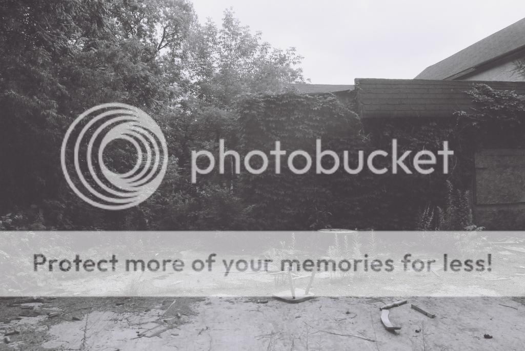

Finding no apparent opening in the front, we walked around to the back, spent fireworks, broken bottles, and the pieces of a smashed chair, some of them evidently used in an attempt to start a fire on the driveway.

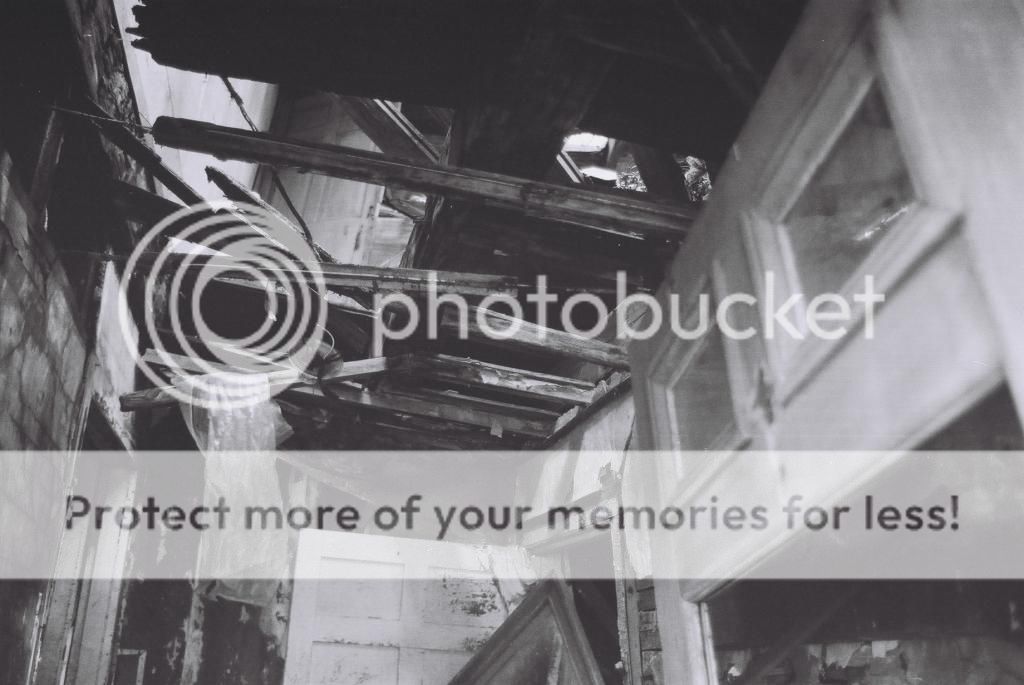

The roof had partially fallen in, and was littered with random garbage, a torn up old pair of overalls, broken fluorescent lights, assorted chunks of rotting foam, and a trio of old white doors.

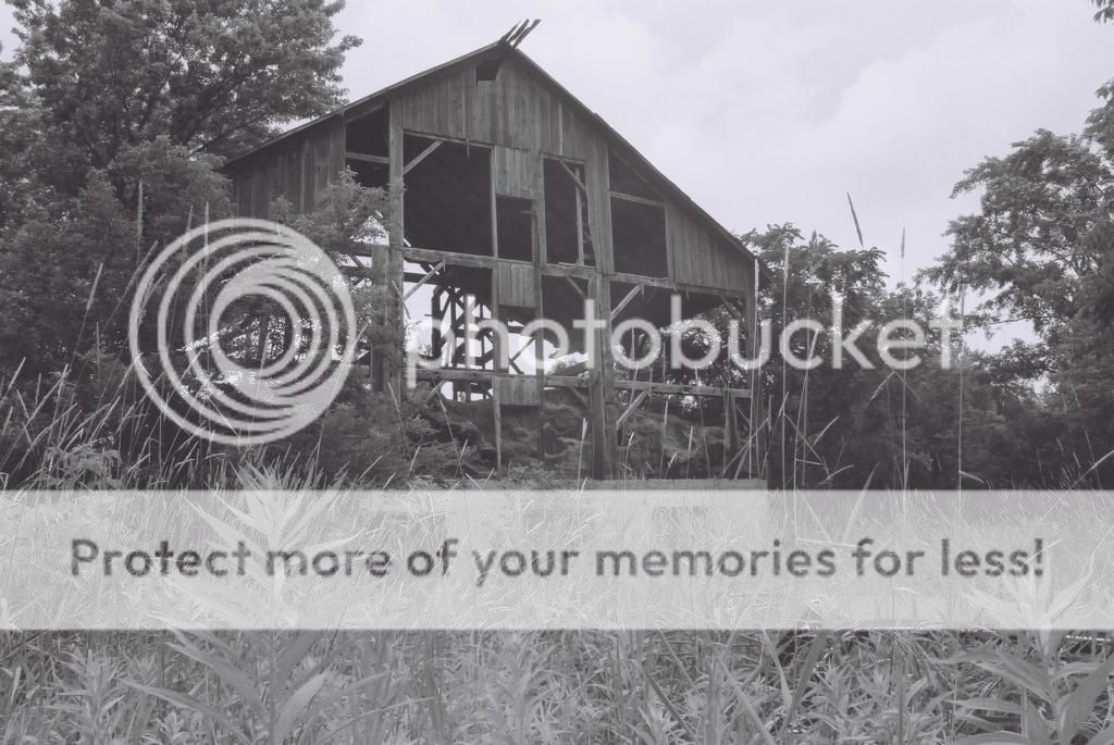

Behind the garage, was the barn.
(the roof of the car bottom right shows how high the brush was)

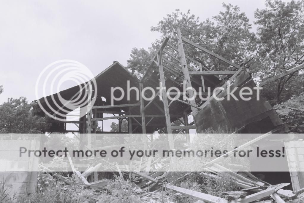

Another collapsed roof, leaving pockets of space for the many untouched bags of fertilizer and old farm equipment abandoned long ago

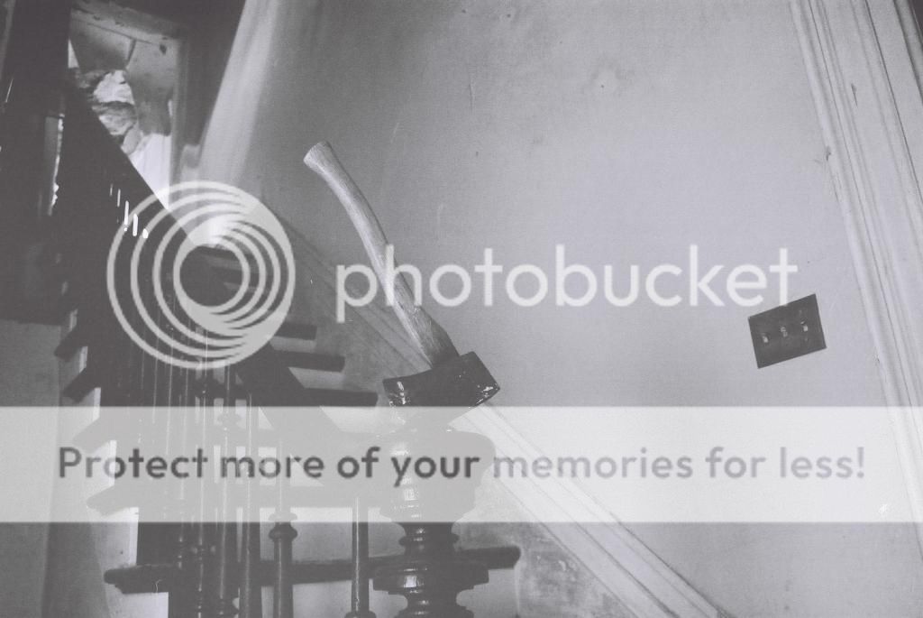

We were greeted with this sight.
obviously the adolescents responsible for the pyrotechnics in the driveway had forgotten their hatchet.

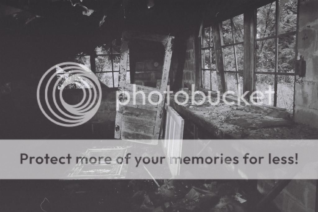

And after a short look around the rest of the house:
I bagged the axe and we headed out for some much needed lunch.

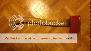

This is how the axe looked when I first brought it home.

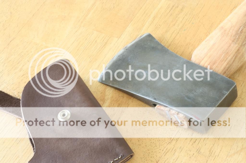

The adolescents apparently had elected to use the sides of the hatchet, rather than the poll, to smash the sides of a couple hundred nails over the course of its life, so I used my disc sander attachment for my drill to sand out the majority of the impressions left in the soft steel of the body.
The old handle had rotted almost entirely through of the eye,
But, the bit was tempered nice and hard, and in good condition, and the edge only had a few medium sized dings in what looked like the (crap) factory edge, so I ground those out with the sander, medium-thin convexed the edge and polished the whole head to 400 grit and gave it a splash of cold blue before taking the new edge to the buffing wheel for a final stropping.

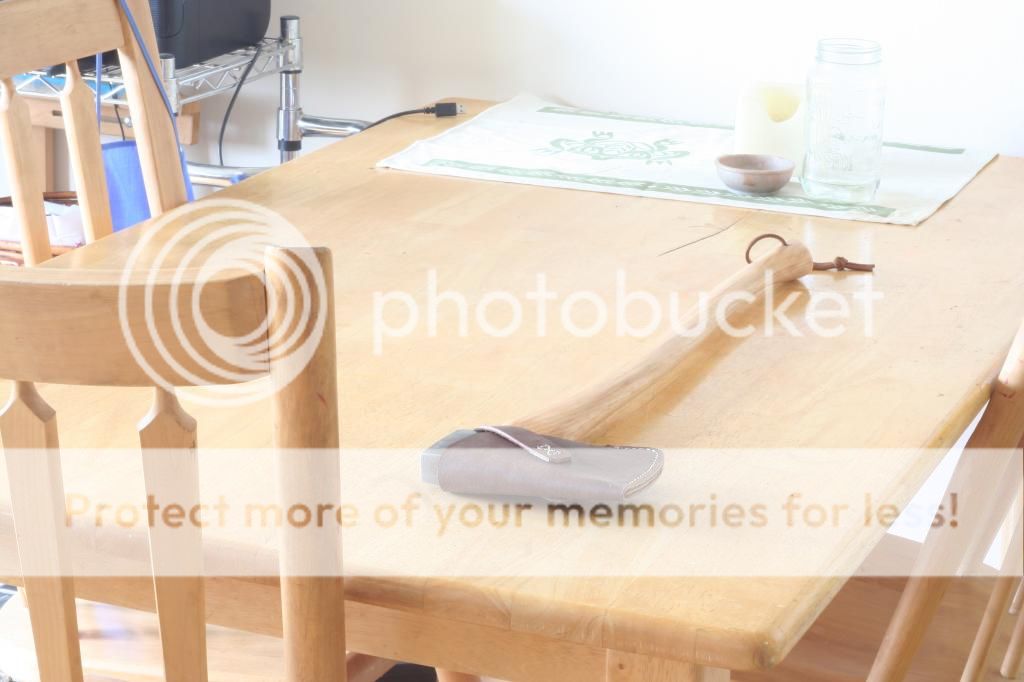

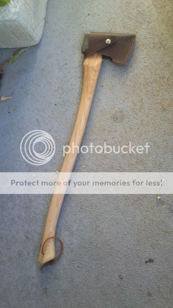

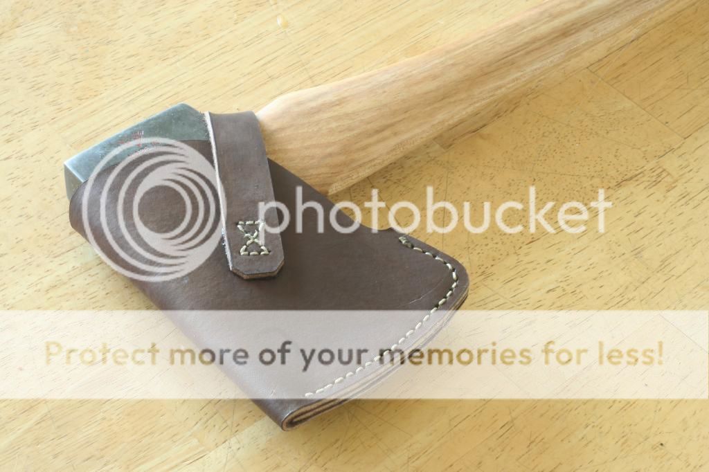

New handle, and used some leather scraps I had sewed up a sheath for it, and this is what I ended up with.
#2 head, 28" hickory handle with boiled linseed oil, and full grain leather sheath.

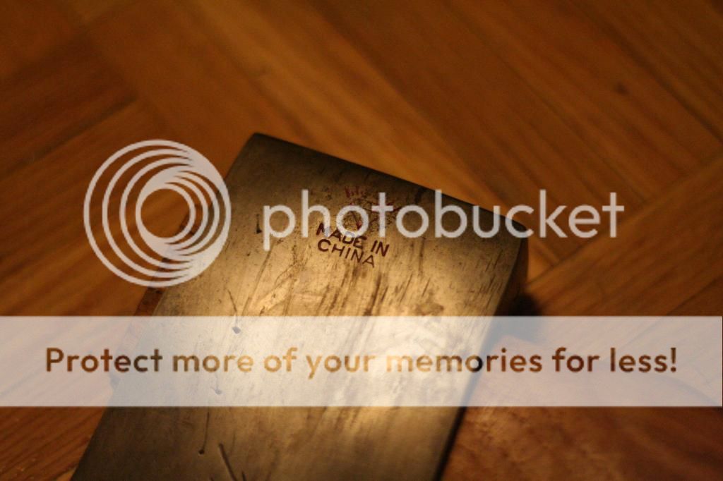

And the funniest part is....
My favourite axe was made in China.
Once in a while we forget that an axe is nothing more than a slab of metal on a wood stick. It may not be the prettiest, or most prestigious, but the edge shaves even after chopping down and processing 3, 6-8" birch trees used for firewood in the camping trips which followed. And that's certainly nothing to scoff at.
Lesson to the younger folk starting out in bushcraft: Steel technology, even in Chinese hands, can make an axe more than good enough for your needs. Don't get intimidated by people with expensive gear, and feel like you need to compete right off the bat. If it means you can get save some of your pocket money and get out there more often, go with what you can afford, and a little elbow grease goes a long way. You learn from, and appreciate items a lot more from making something than you do from buying it.

Nice story and pictures and you did a real nice job of cleaning up that tool. My only question is; how does it feel to be swinging a light head on a long handle?
I actually quite like it, the balance is still only about 2 inches below the head, so the swing is effortless and the bite is still crisp and deep, more like a golf swing than an axe swing.
Canoes and backpacks almost always figure into my camping trips, so having something this light is nice. The extra handle gives you extra leverage when you need a bit more power behind the stroke.
That "diamond brand" seems to have made machetes as well--I've seen the mark before.
And yeah, Chinese tools may usually be crummy, but not all are! I have an American pattern eye hoe made in China for Seymour Mfg. and it's actually a very nice hoe. Hard steel that takes and holds an edge well, and the forging is fairly crisp.
