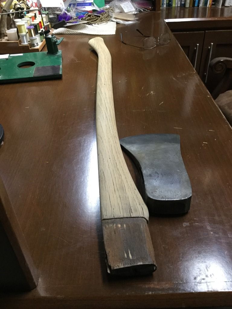

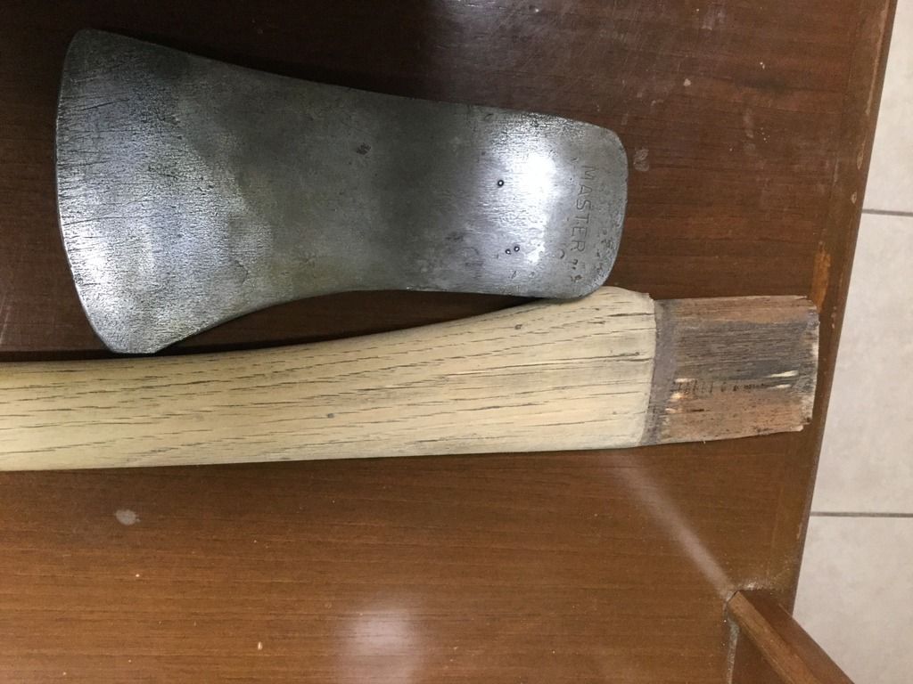

Here we go again, I am trying to restor a handle. I already sand it and removed the brown paint that was on it. It looks good but, where the head rests, seems to be drier. should I apply BLO on it? If I do, when I try to glue the wedge, would be a problem?
What would you do?
Thanks in advance for all your comments

I'd stick that end in a cup of blo then measure it until it stops drinking , But I wouldn't glue in the wedge as it makes it harder to remove if you run into any issues with the hang.
And yes I assume the blo would affect the glue ( if it's still dripping with blo when you hang it the wedge will drink it up and swell , negating the need for glue anyways )
Not sure how snug a fit the handle is at present but if you soak it beforehand you might not be able to get it back in. Right now it's perfect- 'dry as a bone' and were you to hang and wedge it (don't glue the wedge or you'll never get it out, (or be able to drive it further in, again) and then soak the assembled head in a pan or pail of oil for a week or two it'll draw up the BLO plus swell the wood too.
That is exactly the type of haft that benefits GREATLY from multiple coats of BLO. Brush on the first few coats. 5-6 coats will make that haft better than new. It'll look and feel fantastic.
Be sure to rasp the ledge off the shoulder with your 4-in-hand. Set it 1/8"-1/4" lower on the haft and coat the wedge with Swel-Lock or DPG if you have them.

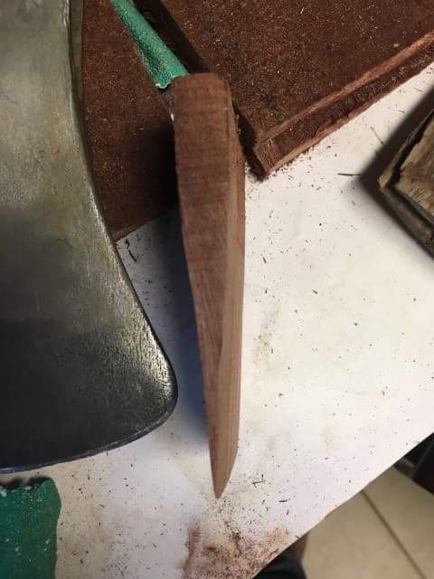

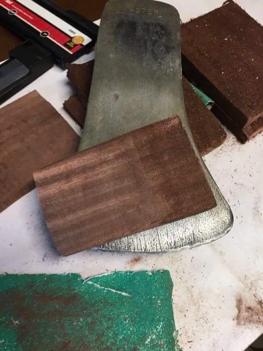

Thanks for your comments, I've been reading them as well as the thread about wedges. Somebody said poplar do good wedges and there is a species of poplar that grows here, i hope the wedge will do good

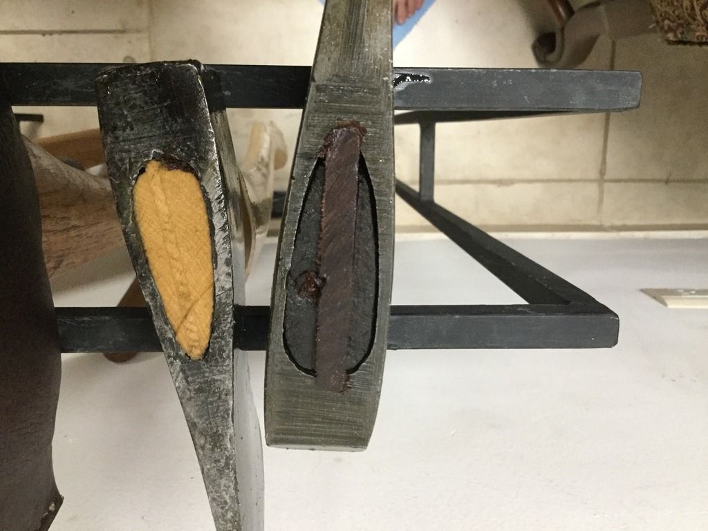

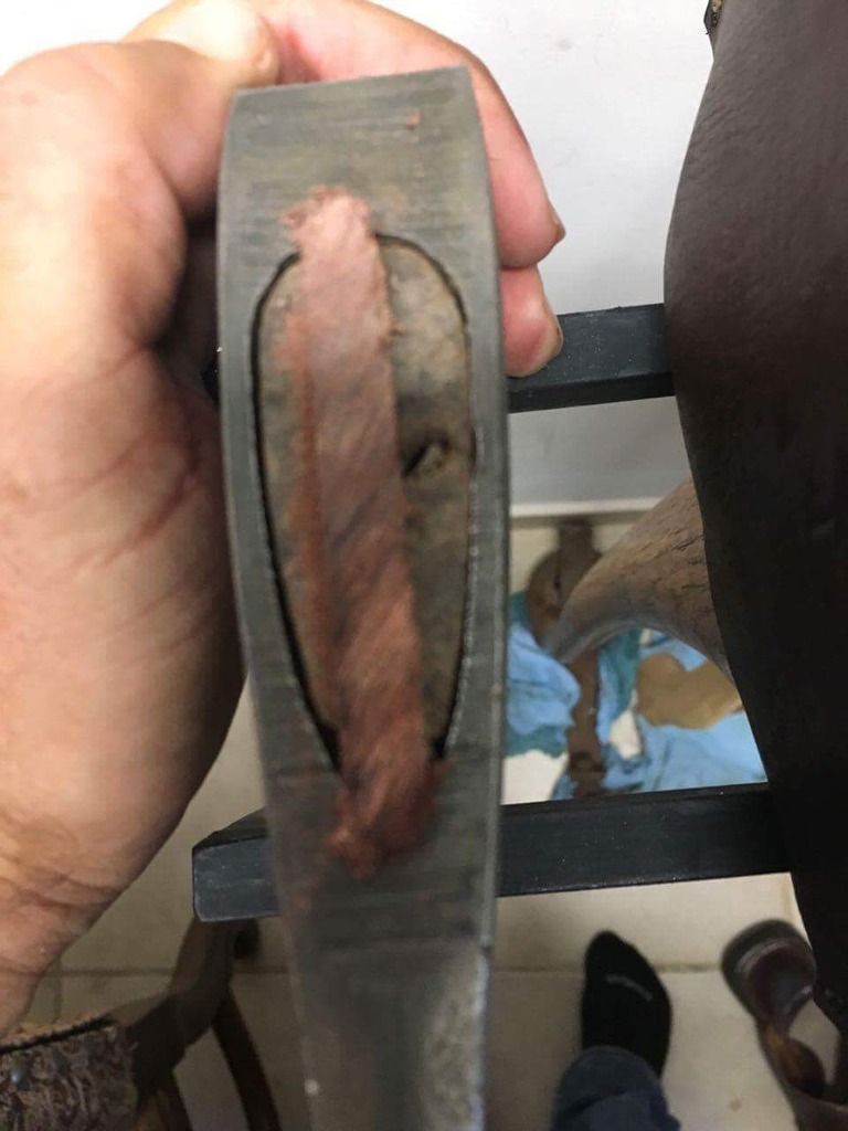

Axe head is deep into BLO, tomorrow I will take it out
So here are some pics, let me know your thoughts
Thanks again
That wedge definitely fills the void! If you have the patience don't trim it just yet and get out there and use the tool as much as you can. Over the winter you can then try tapping the wedge every now and again to see if it'll go in any further.
