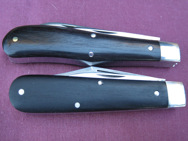

I have a GEC Boys Knife that got a small shallow ding in the ebony. I took some 400 grit sandpaper and gently worked most of the streak out. Sanded the other side for uniformity. Wood loss was minimal, but now the ebony has a dull appearance.
Any suggestions as to how to get that original GEC luster back onto the scales? Polyurethane? Acrylic based, water based, or otherwise?
Would anyone know what GEC uses to finish their scales?

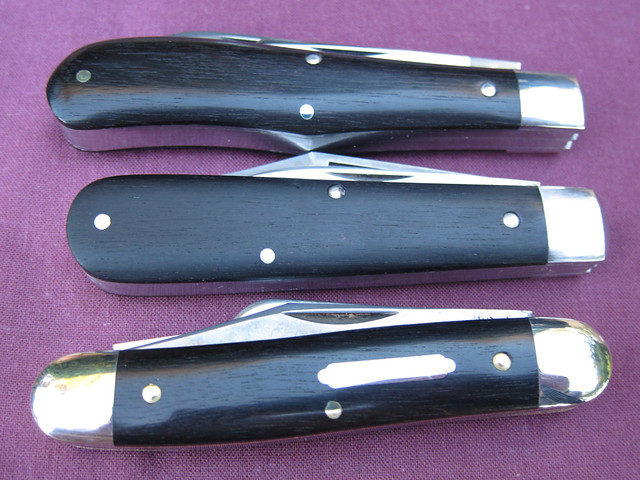

Here are a couple of pics. thanks!
With the Eureka...
With Eureka and the Calf Roper...
Peter

Personally, I think it looks great as it is but you might spruce it up a bit by rubbing some mineral oil into the covers or a light touch of black Min-Wax.

Great everyone... Thanks for the input. I'll try a finer grit and then oil & wax.

The factory finish is done by buffing on a buffing wheel. You can use 0000 steel wool to refine the 400 grit finish, then use Simichrome polish on a rag in "shoe shine" fashion to polish the ebony.
Then, a coat of wax will help.
