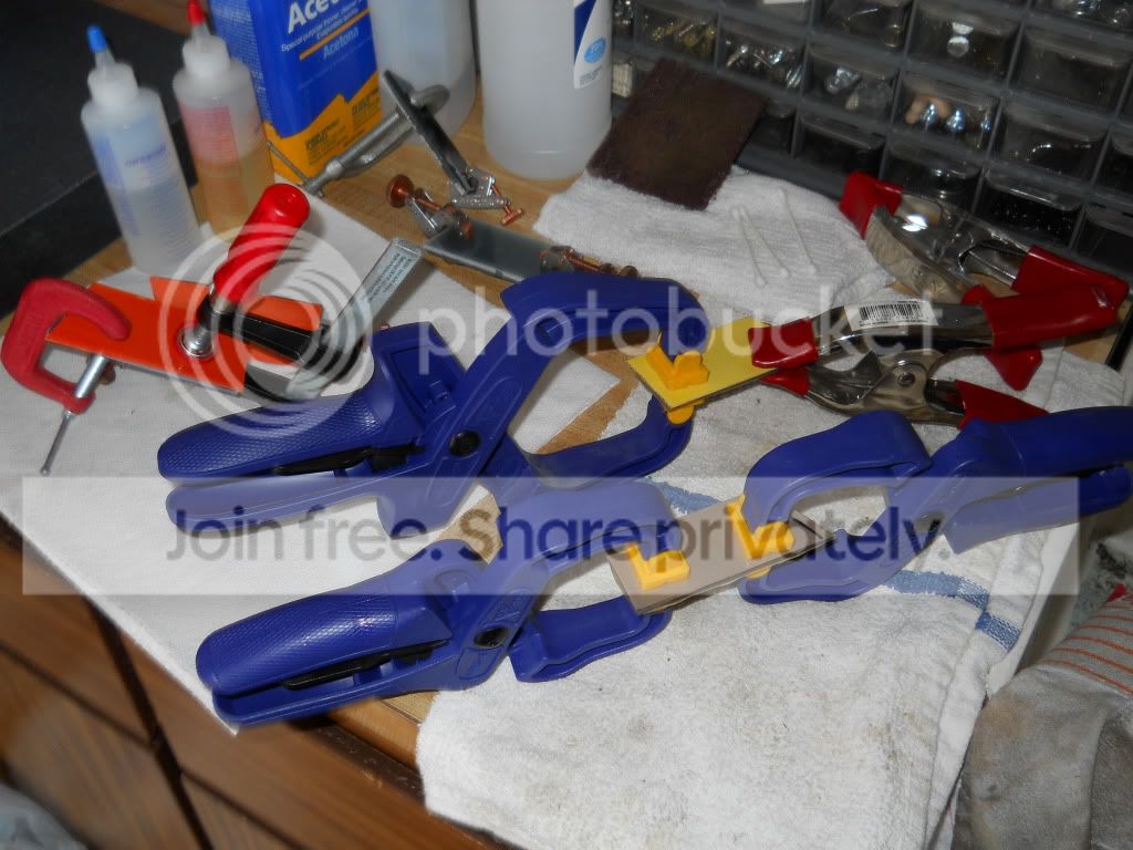

Well, it's not forged, but you asked so this is what I was working on today. Got these five blade cleaned up post heat treat and I have a bunch of handle slabs and liners all glued up getting ready to put on. This was a really fun batch to work on.

I like your clean grinding, Jon. Those look great. Also quite the motley assortment of clamps you have there. Those little Kant-Twist clamps are swell. Is that a little kiridashi-type blade over on the right?

LOL, yeah I've got a nice eclectic clamp collection:D I have five of the Kant Twists, and would love to have a couple dozen more but they are pricey little buggers!!
