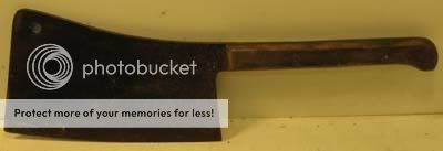

I once restored a jumbo sized vintage Brickell cleaver. The blade is 11" and hair shaving sharp now. It looked like scrap metal with a handle when I got it.

I have a Briddell vintage cleaver that will I'll restore soon also. Blade is close to 11" with a handle length to match. WIll be pretty crazy when it is cleaned up.
