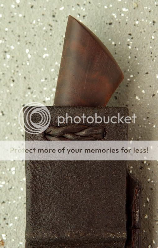

When building a sheath that requires a retention strap like the one below, how do you atach the strap to the back of the sheath? I've seen some that appear to have the strap integrated into the back peice of leather, but others like this one appear to be stitched onto the back of the sheath. How do you guys do it and make it look clean? Thanks in advance.
(Please excuse the rip off of this picture from the show off thread)
I've seen them stitched on, integral, riveted, bolted, and snapped. My favorites are rivets and bolts. They allow for the strap to be pivoted away from the blade edge. And thats a good thing. :D

A picture or two could be worth a thousand words, so.........
The first two photos show my "bow tie" retention strap which works with any knife, but does require the use of a Sam Browne type stud instead of a snap. It is very flexible with regard to use. Relases either right or left, can come off completely, or left hanging on the front of the sheath by one of the button holes if the knife is going to be in and out of the sheath frequently.
The third photo is of the attached single strap and can be used with either the standard snap set up or the SB stud. This one is installed in a slot between the lining and the sheath exterior, or it can be one of the welt wedge pieces and come out of the welt on either side.
Paul

So the bow-tie never attaches to the sheath other than securing to the SB stud?

Bingo! You got it. Easily replaceable if something should happen to it.
