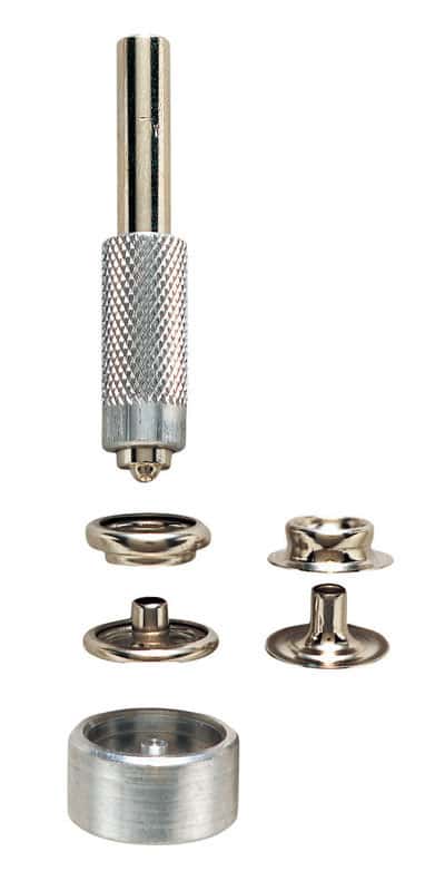

I'm looking at modifying my sheath that an RD7 rides in. It has a velcro strap as the retention and I want to replace it with a button retention strap or maybe two of them. Anyone know where to get a leather or nylon button strap?

in the required "snap button fastener kit"

General Tools Brass Snap Fastener Kit 6 pk - Ace Hardware

What I did in a similar situation: (1) buy leather (6oz or so should work), (2) snap fasteners + riveting tool as shown in post #2, and (3) a 1/8th hole punch. You can find all easily on ebay or amazon, not expensive. The leather you can cut into a stripe with a good knife.
