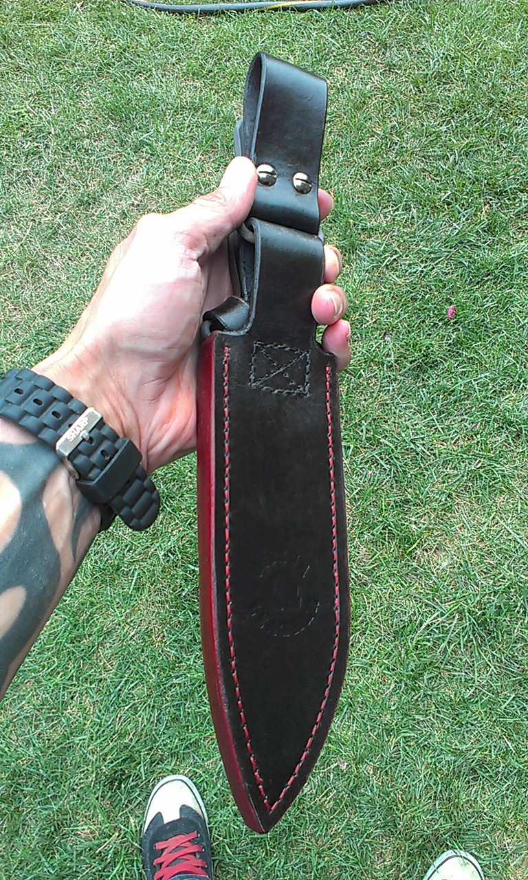

I'm about to start a sheath for this knife and I've hit a mental roadblock. I want to add a retention strap and was looking for some suggestions.
I have snaps and was thinking about adding a strap over the top of the guard and having it snap to the front. I can't for the life of me figure out how I would attach the strap to the back of the sheath.
My other thought was to add a stud to the front of the sheath and have a removable leather strap that holds it on.
Any suggestions?
Here's a picture of my project so far. I'm planning on sewing the belt loop to the back as a seperate piece.
Maybe I'm not understanding, but couldn't you just sew it on the back of the sheath before you sew the sheath together? Otherwise, you could use a short chicago screw, rivet, or use any of the above to attach the strap to the belt loop as well. That with a snap/sam brown stud on the front should work. Again, maybe I'm not understanding the question. Good luck.

Thanks Paul, that was one of my ideas for the strap as well. That would juat mean another trip down to Tandy.
As for sewing the strap to the back of the sheath, I guess I just can't visualize where to sew it. Maybe I'm over thinking it. It seems that the belt loop would get in the way.
Does anyone have a photo of the back of a sheath with a sewn retention strap?
Paul's way, as always, is best and will likely yield you the most professional looking sheath. For a few alternative options, you could narrow your loop down a little and sew the strap on next to it and you should have clearance for the belt to pass over it without much issue. You could also make your belt loop piece wider, split a narrow section off the one side and fold it the opposite way for your retention strap. Also, you can cut the top layer of the sheath with the strap coming off the top on the spine side. It would then wrap all the way around the knife like the removable strap and fasten back in the front. I looked, I can't find photos of a sheath with this design.

I have once made the retention strap from the same piece as the belt loop as suggested above. It doesn't need to be cut at an angle as leather will adjust to shape. The only issue with that might be that your belt loop might end up quite narrow.
If you want to go with a single strap it can be inserted between the tails of the belt loop, cemented and then the same stitches that secure the belt loop will also catch the strap. The "bow tie" is much simpler and just as effective……maybe more.

Here's one where I stitched the strap in.
I made it so that the end of the strap was the shape of the stitched box. It's skived to match the taper of the inside belt loop.
After seeing a post by Paul I changed up the way I do it. I no longer stitch them in. I take great care in prepping the strap for cement and I tried it on a scrap. The fact that I can not pull the strap out without destroying something, and coupled with Paul's advice and experience, I'm convinced it's the best way for me.

jdk1, I didn't say the retention strap was not stitched. What I said was the stitching for the belt loop would also lock in the retention strap. The cement will hold most of the stress for sure, but the loop stitching insures it won't break free. We'll go over this in detail when you visit my shop.

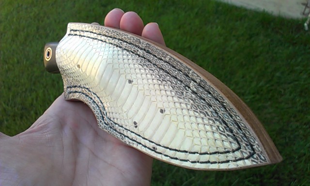

Snake is nice because it's so thin and can flex and stretch a little when needed. It's also relatively inexpensive depending on where you get it. Shark is by far my favorite exotic, but I haven't tried many others.
Obviously this is an overlay versus an inlay, but the thinness makes it very easy to deal with.
