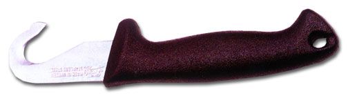

any gutting blade should do...
Frosts of Sweden makes this nice one.
look at the benchmade rescue hook as well.
around 40usd gets the knife, kydex sheath and metal belt clip.
I was using mine to cut 1/2" wide nylon banding, up to 1/4" poly rope, and trimming sheets of material down...
gonna send mine in to BM for the sharpening service, can't get it sharp to my satisfaction myself.
