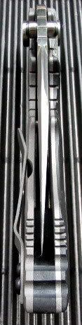

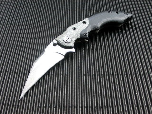

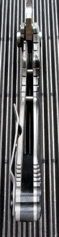

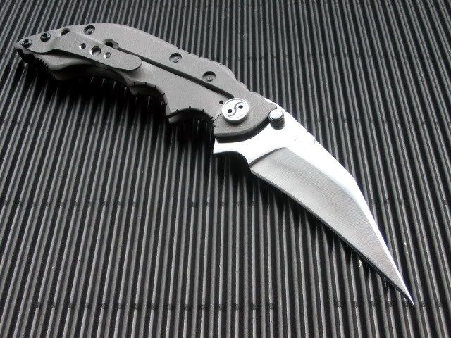

Hi all,
Just finished ! The frame lock Zen. The spec is:
Blade shape : Reverse Tanto
Blade steel : CPM S30V, hand rubbed satin finish.
Blade length - 3 7/8 "
Opened length - 9 3/8"
Thickness - 4.2 mm.
Widest - 3.5 cm
Handle - Silver twill & Black G-10 connected in Yin Yan style
Frame - 6AL 4V titanium 1/8" thickness
Clip - 6AL 4V titanium
Pivot - Hardened 440C in Ying-Yang style.
Washer - Teflon
Thumb stud - Hardened SUH3 dual thumb stud.
Thanks for looking.
Yun
