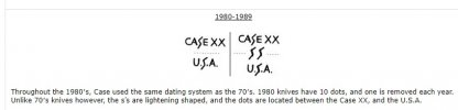

I can only comment on the blade steel and I'm not even sure if this pertains to your knife because I don't know exactly when Case started doing this:
At some point in time, Case began identifying the blade steel by the shape of the letter "S" in the word CASE on the tang stamp. The lightning shaped "S" signifies stainless steel and the regular "S" signifies CV steel. There used to be a paragraph about this on the Case College page but Case seems to have done away the Case College so I can't link it.
Anyway, here's a photographic example of what I'm describing. Both knives are from the 2000-2009 era. In the top pic the knife on the left has stainless steel blades and the knife on the right has a CV blade. Note the different shaped "S" in the word CASE.
IF Case was doing this when your knife was made then the "S" on your knife signifies stainless steel.
