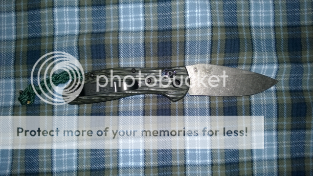

As with many of you, I too have purchased RSK Lg Mk1 (552-1401). I must say RSK design is outstanding. Concept of having improved design (Close to Full Flat, but it is Saber grind) blade on Production Griptilian blade is genius. (Thank you, Doug! :D )

I am guessing that because of labor complexity and need to keep the cost down, production line must not have too many multiple tasks. Consequently few of the points in fit and finish areas were omitted. In my opinion, I think it can be improve by following simple "do it yourself" tasks.
* Polish:
By completing this, Blade swing is substantially smoother to operate and such, I can tighten up pivot screw enough to have zero blade yaw angle play.
Because the blade was stone washed, I can see some of the points are not as smooth as other counter parts.
I have used 1000 grit paper and then 2000
* Each phosphor bronze washer, both surface.
* Partial liners: Inside where phosphor washer meets
Outside where AXIS lock glides
Also rouge-ed surface of the blade
* pivot face
* Pivot surface (glide against AXIS lock bar)
All surfaces, including AXIS lock bar are cleared with alcohol and then coated with Slip 2000 EWL and heated to adhere coating.
This is before polish. Blade rotation has "hesitation" as AXIS bar rubs against Stone washed surface, in which it acts like grinding stone. (Unless AXIS lock bar is much harder than M390)
After polish.
Here is phosphor bronze washer. Unfortunately my washers were scratched out of the box.
Left is before and right is after running washer in circular motion on 1000 grit paper.

I have recently purchased REI edition of 551 (551-1401). It has G10 handle and it has solid feel that is similar to Rift 950, or 810 class.
Here is red line indicates balancing point.
(551-1401 above, 552-1401 below)

I agree with this, but I'd rather these issues be fixed by the owner rather than come this way out of the box and than increasing cost. I look at the Griptilian as a great, affordable user and not a meticulously crafted custom. I know you agree with this - I'm just adding to your thoughts.
How did you polish the blade where it meets the axis lock bar? By hand or mechanically? I've thought about doing what you did, but I've always been scared of jacking something up.
You got it right out of my mouth. I have been... tinkering with Benchmade, so I feel comfortable with it. The key is patients, carefully disassemble and reassemble, keep parts in a place not to be lost.
I have hand polished with 1000 grit and 2000 grit wet sand paper. Gently remove the burr as AXIS pivot area tolerance is high. I have also used Dremel buffer wheel with rouge compound to have it smooth out the surface as well. No need to accomplish flawless mirror finish, but enough stone wash scratch is removed. Take your time and invest in very strong and no cheap torx screw driver. If you strip it, you have no choice, but beg BKC for "replacement repair".
In addition to polish, I have used Slip2000 EWL that is meant to adhere to the metal to form protective and lubricated surface after heating up.
Good luck and have fun!
Great Post.
I just tuned up my Mini Ritter in a very similar fashion. I concentrated my polishing efforts on the blade and washers. The stone washed finish definitely affected the blade swing. Before I disassembled, I thought there might have actually been some kind of grit in the pivot. It was really just the texture of the stone washed finish. I used Red the White Rouge, by hand, cleaning with alcohol between polish applications. I didn't want to get the washers out of round, so they went on my extra fire stone, and I just took off the grooves that I found, exactly like your picture.
My Mini--which is S30V--now has as smooth an action as any Benchmade I've tried.
One thing to add, when I adjusted the pivot, I tightened up to tighter than I wanted, and then backed it off to looser than I wanted, and then dialed it in. I think that tightening it down--NOTE--Don't go all HE MAN on it--just more snug than you want--and then backing if off before dialing it in helps in keeping the pivot screw at the proper tension. I haven't had to use Blue Loctite on it yet, and I did this over a week ago.
