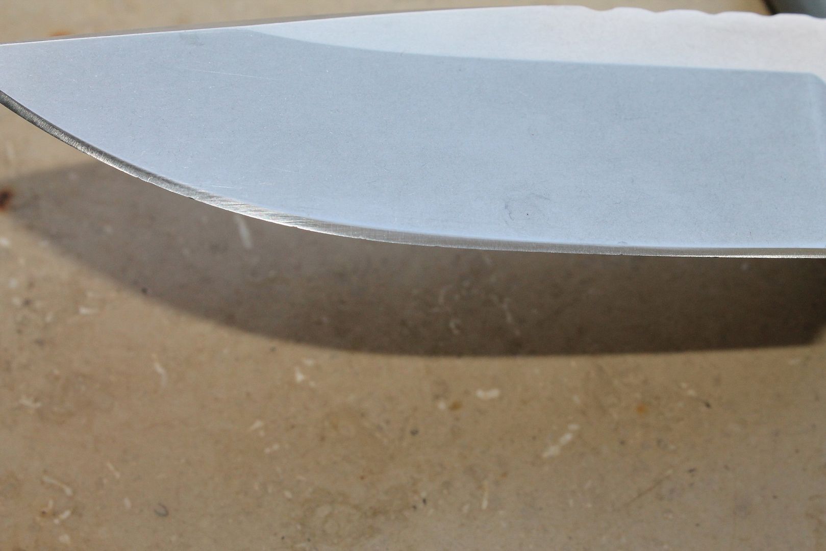

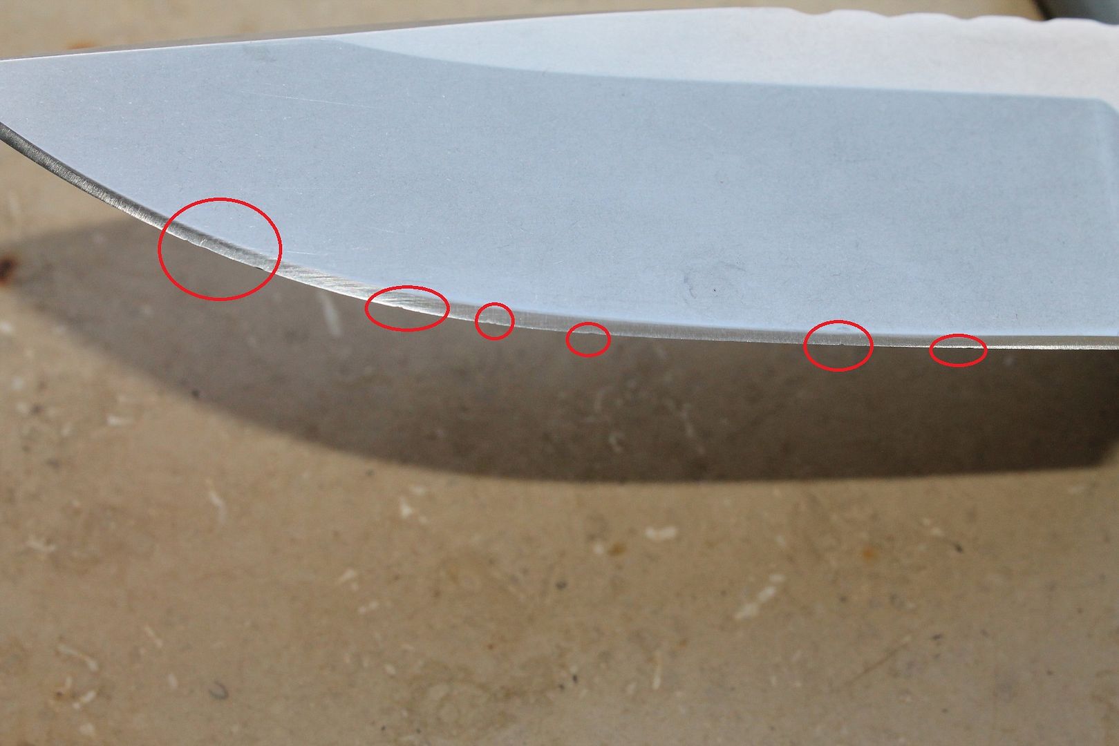

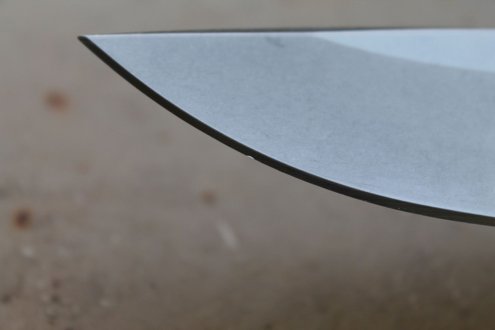

This is the big one. If I could go back in time, this right here would be the one thing that would dissuade me from buying the knife. To start with, the edge came ridiculously sharp. Too sharp for my tastes. I haven't measured the angle but in my opinion it's just too fragile. That being said, I have horsed on a few knives with an even steeper blade geometry (Spyderco Mule Teams in several steels come to mind), and despite the angle making me nervous, they performed flawlessly and didn't chip.
This is where the Nyala has failed, miserably and repeatedly. I have had the factory edge roll/chip several times. The first time I used the knife in the kitchen, the edge rolled when cutting carrots on a plastic cutting board. That's just flat out unacceptable. It has happened several times since in the kitchen and when doing bushcraft work. I hate to bring up J Davis because of his colorful past in the knife community, but for all of the nasty things he ended up doing, I think he was right about CRK knives being hit or miss with their heat treat. For the record, I have not had any of these issues with my Sebenzas. I will probably have to end up re profiling the knife to a slightly more obtuse angle.

That's my review, I don't have photos of the edge right now but I will take some tomorrow when the light's better so you can see the rolling and chipping I was talking about. I hope you enjoyed and I hope I didn't open up a huge can of worms regarding the CRK heat treat.
