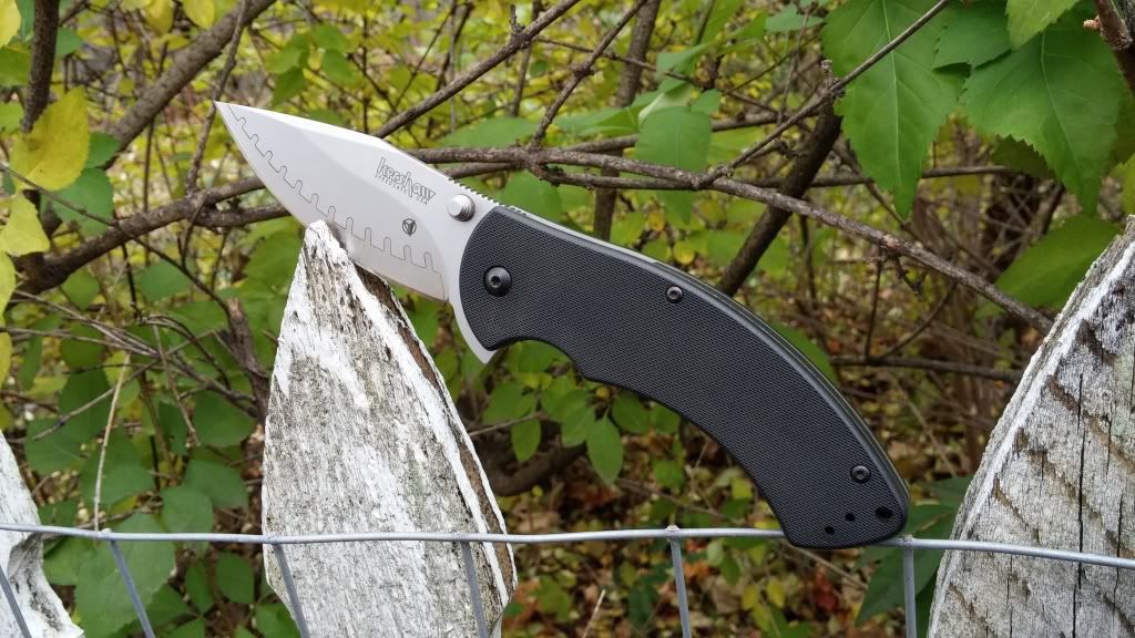

Kershaw Rake​
Specifications:
• Overall Length – 8.12”
• Blade Length – 3.5”
• Blade Thickness – 0.12”
• Weight – 4.80 oz.
• Handle Thickness – 0.54”
• Handle Length – 4.625”
• Liner Lock
• Clip Point blade shape
• Flat ground
• Four-Way positionable pocket clip
Materials:
• Black G-10
• Bead Blasted CPM-D2 Cutting Edge
• Bead Blasted 14C28N Spine
• Stainless steel liners
• Stainless steel clip

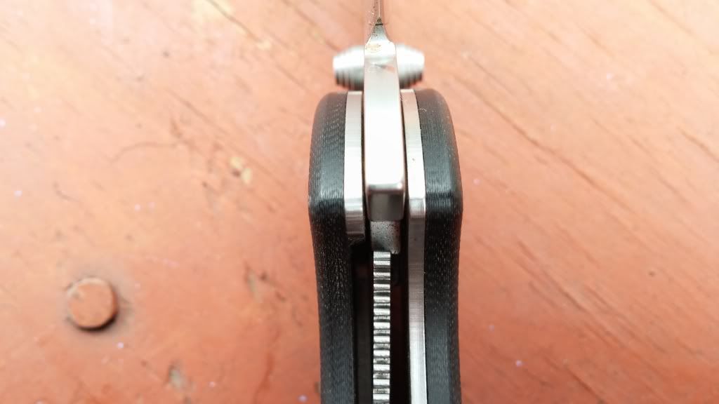

Blade Centering:

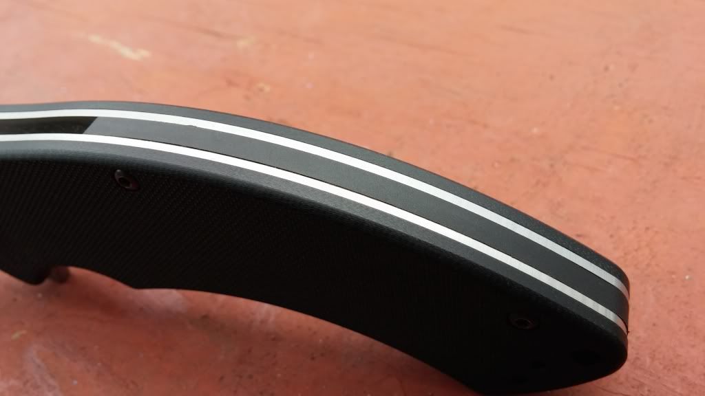

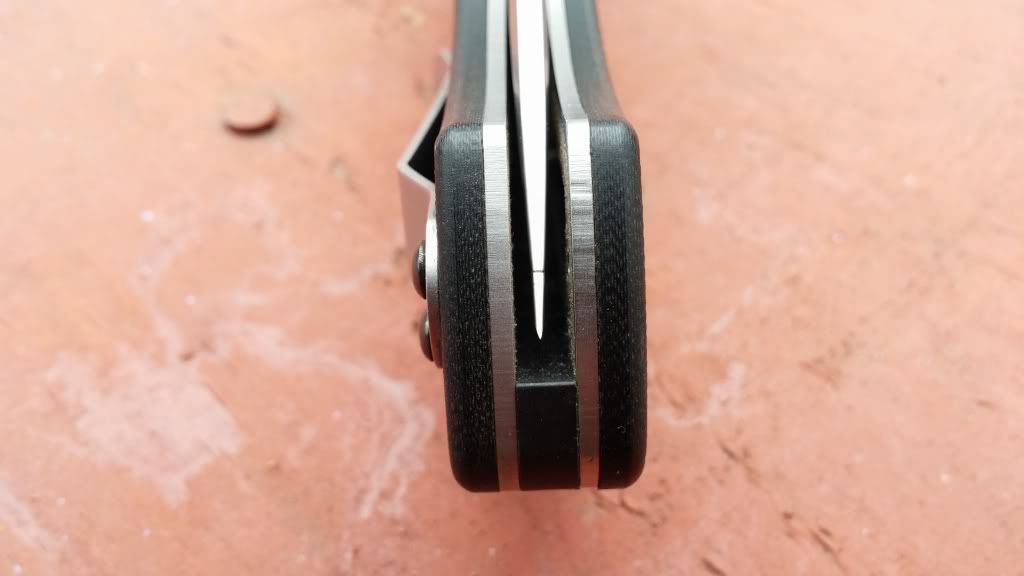

The blade centering on this example was perfect. Right down the middle.
Lock-Up:
The lock-up on this example was just like the blade centering, perfect. I couldn’t detect any movement in any direction.
Construction:
I didn't take it apart, but the pivot uses a T8 torx bit. The body and pocketclip screws use a T6 torx bit. The Rake also has a backspacer.

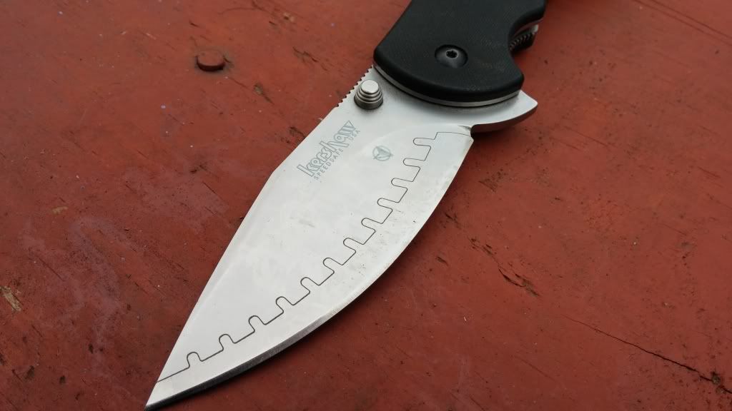

Blade Shape:

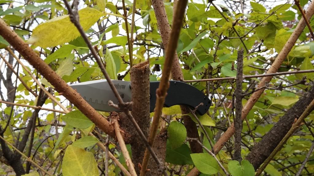

I really liked the blade shape of the Rake. The tip was very pointy and was very easy to use in delicate cutting tasks. The rest of the blade was also very useful and proved adequate in cutting materials like wood.

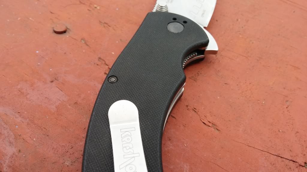

Pocket Clip:
I found the pocket clip on the Rake to be normal. It wasn't a funky shaped pocket clip that made the knife sit weird in the pocket, although the natural shape of the Rake does make it sit "odder" than most knives. The pocket clip didn't protrude out of the handle far enough for me to feel it during cutting, which is a good thing. I didn't find any pocket shredding either. Overall, It's a nice standard pocket clip.
Ergonomics:
The ergonomics of the Rake were very good IMO. The combination of the blade shape and handle shape made the knife feel like an extension to your hand. Because of the handle shape though, it made the knife sit funny in your pocket.
Blade Steel:
The Rake sports Kershaw's patented composite blade. The spine is Bead Blasted 14C28N, and the cutting edge itself is CPM-D2. The CPM-D2 performed phenomenally! I could've cut and whittled branches for days. I also cut through a few shingles and it still sliced through phonebook paper afterwards.

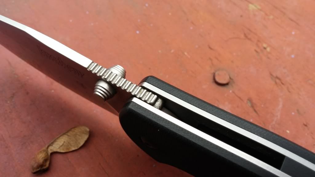

Deployment:
Deployment of the Rake is easy with the SpeedSafe. A light push of the flipper propels the blade forward in a nice positive locking position. I did however, find the thumbstuds hard to access. They're tucked up against the handle, which makes it difficult to get your thumb in a position to push on the thumbstud. I think a little chamfer in that area would solve that issue, and also improve handle comfort when gripping the knife.
[video=youtube_share;NQuO0Q98p7c]http://youtu.be/NQuO0Q98p7c[/video]
Other Notes:
I honestly didn't care much for the composite blade design. It's sort of a combination of dulled saw teeth and puzzle pieces.
Any questions or feedback is greatly welcomed! Thanks for reading!
