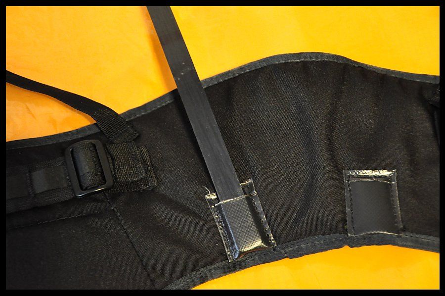

changing the waist belt or stays is as simple as undoing the 3-bar on each side of the lumbar pad.

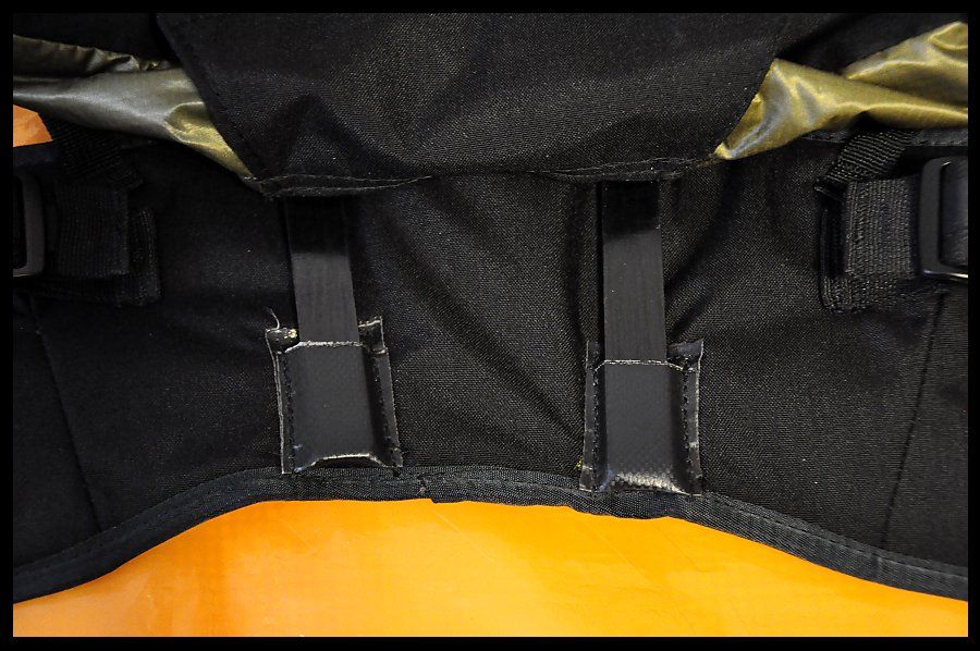

the waist belt is completely off here, exposing the composite stays...you can't use this pack without the waist belt by the way since the stays and shoulder straps connect to it.

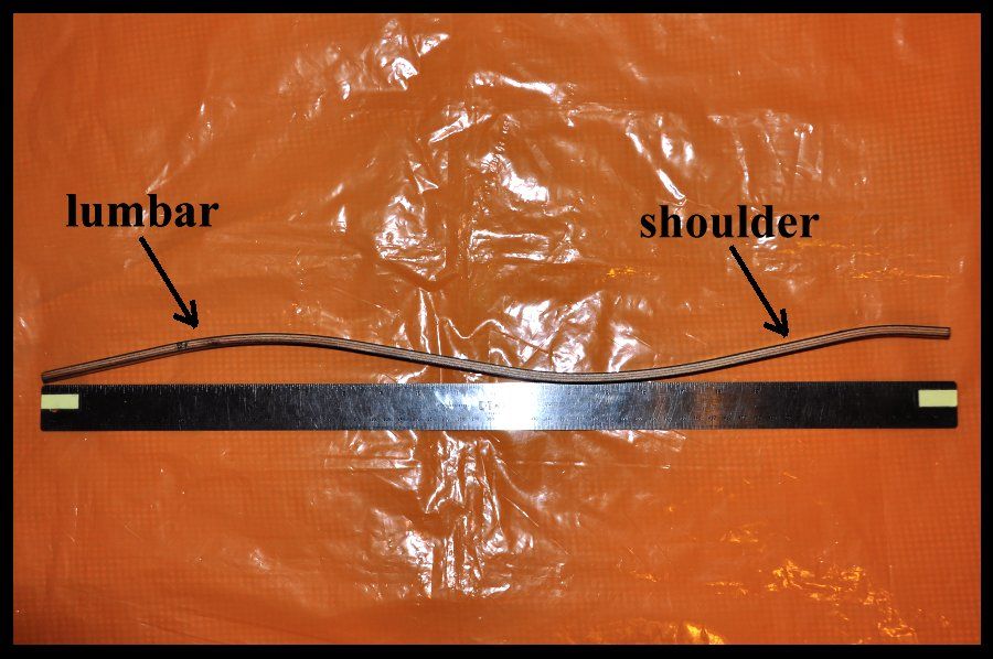

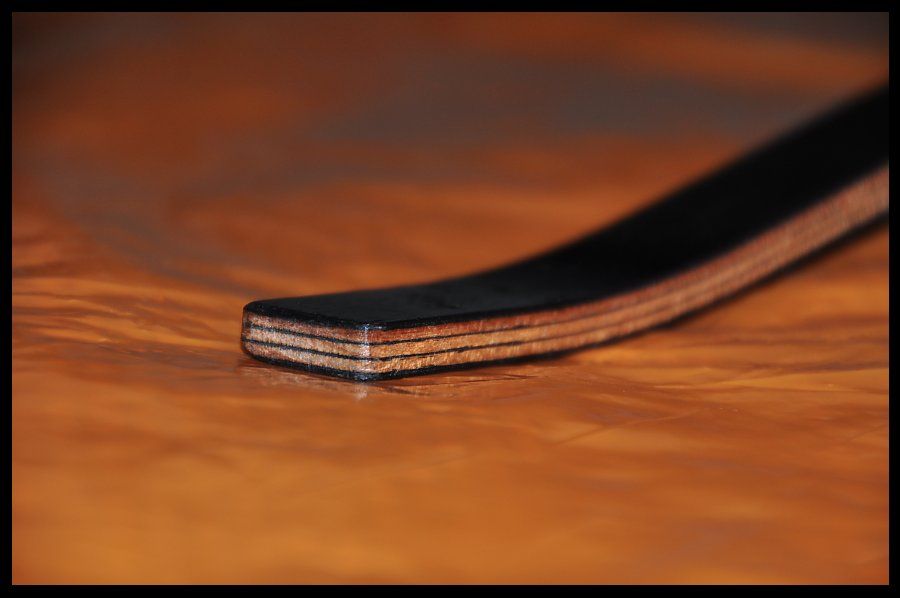

wood and carbon fiber composite stays...i opted for the 24" (you have an option of 22" or 24" aluminum or ultralight composite stays). the only downside with the composite stays is you can't custom-bend it to your back unlike the aluminum ones if you have a weird shaped back.
the back reflects the stays' highly contoured shape.

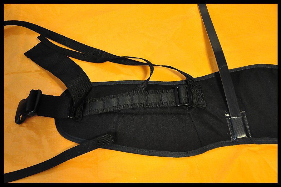

the waist belt is completely off the pack...you can order a different size in case you gain/lose weight down the road.

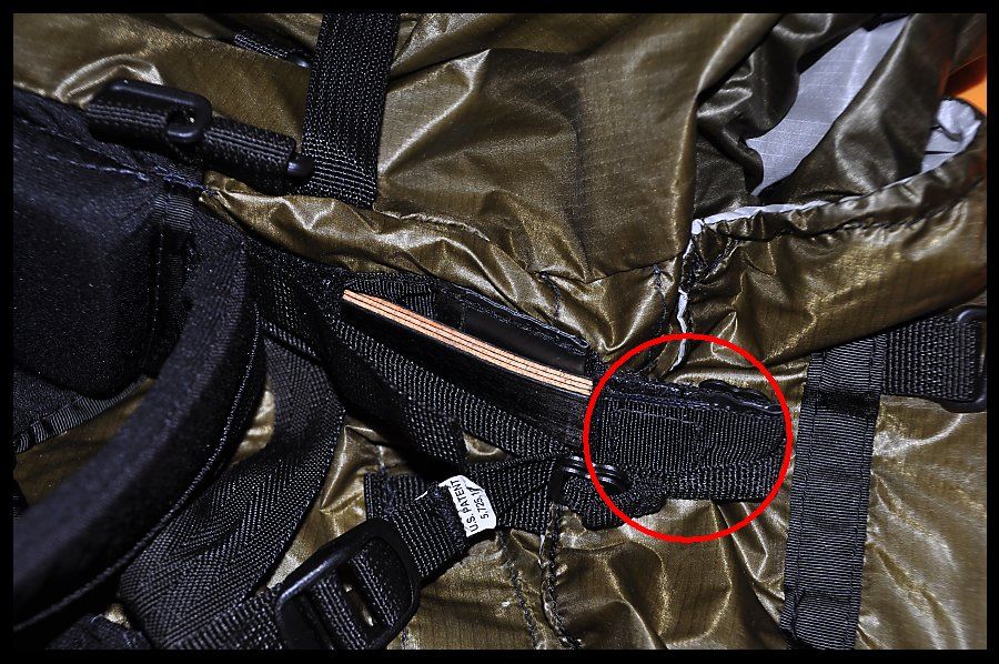

at the top of the pack, here's the slot for the 22" stays.
and the slot for the 24" stays...you can always re-adjust the torso length.
