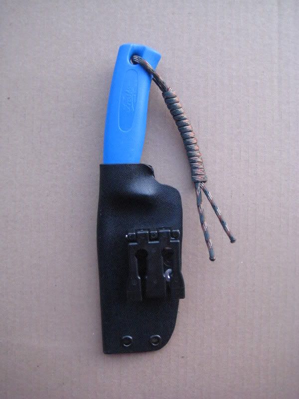

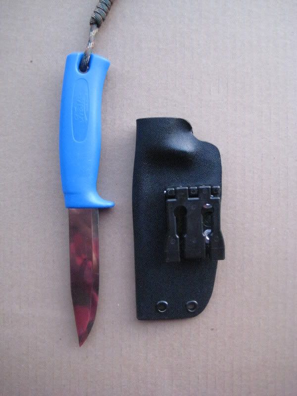

Here are some pics of the Kydex sheath I made for my Mora 760, which will also fit the 740 and 780. It can be used as a neck sheath, or worn vertically or horizontally on the belt due to the Tek Lok. It also rides higher on the belt so you can sit or drive with it on the belt with no discomfort. It also has a drain hole and can be worn on the right or left side like the original. I wanted to keep all the versatility of the original, but rectify most of it's deficiencies.

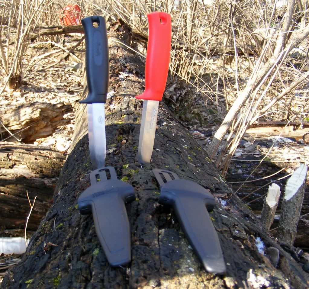

The first knife (the black handle) is the 780. The red knife is it's cousin in carbon steel, the Craftsman 640.
