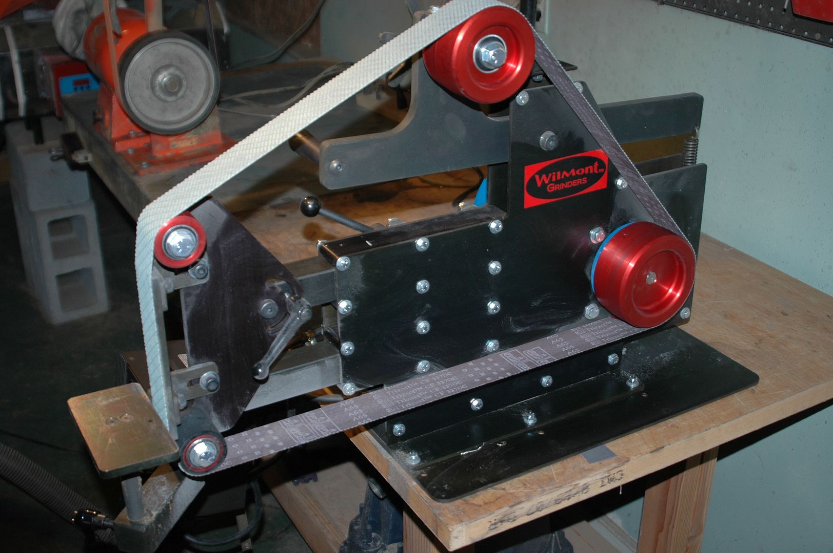

Pics

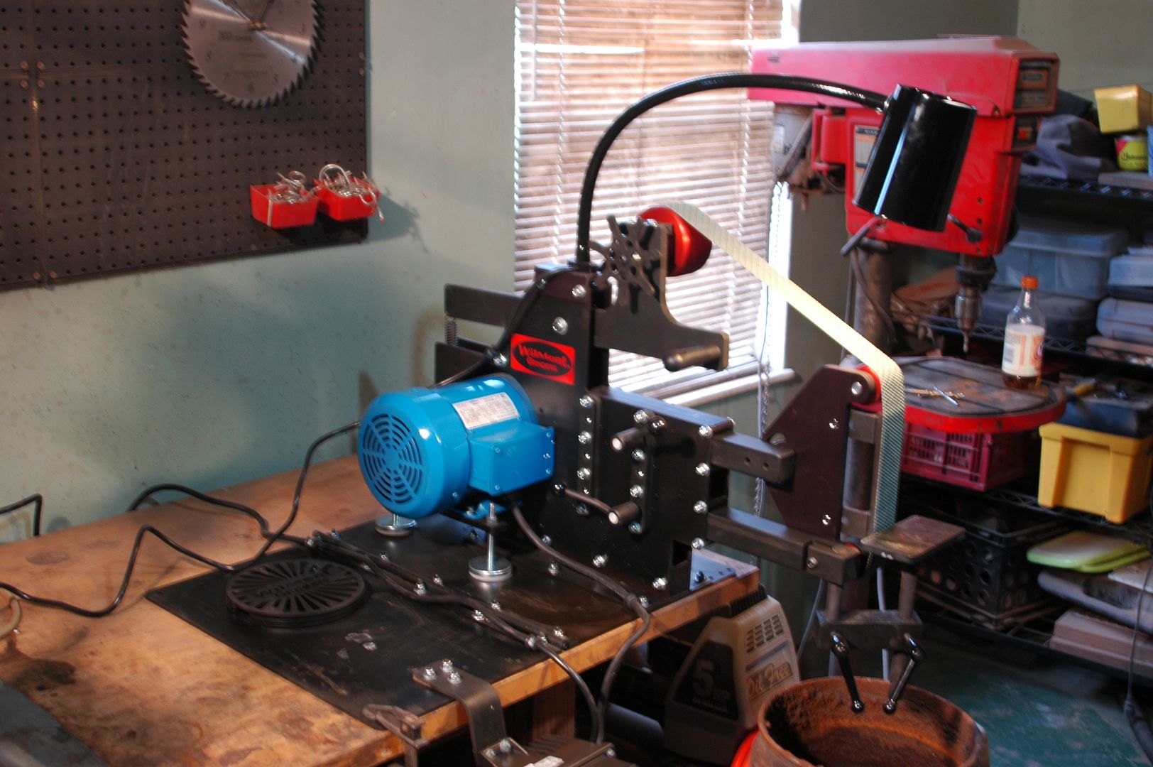

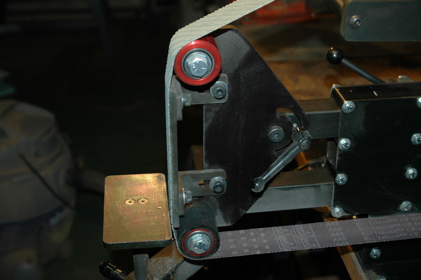

Left and Right side. It really is a good looking machine. All the metal is black and the wheels are anodized Red. One of the platen wheels are rubber so you can use it for choils and such.

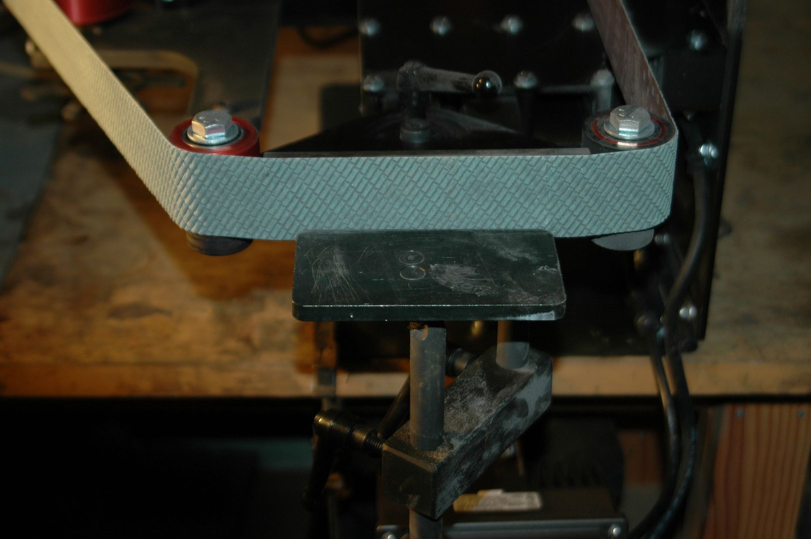

Wheels and Platen. The wheels are absolute quality. The platen is 7" long and is made from thick stock. I have glass coming for it.
The platen is adjustable so you can move to fit your grinding style. The lever is easily turned and holds great.

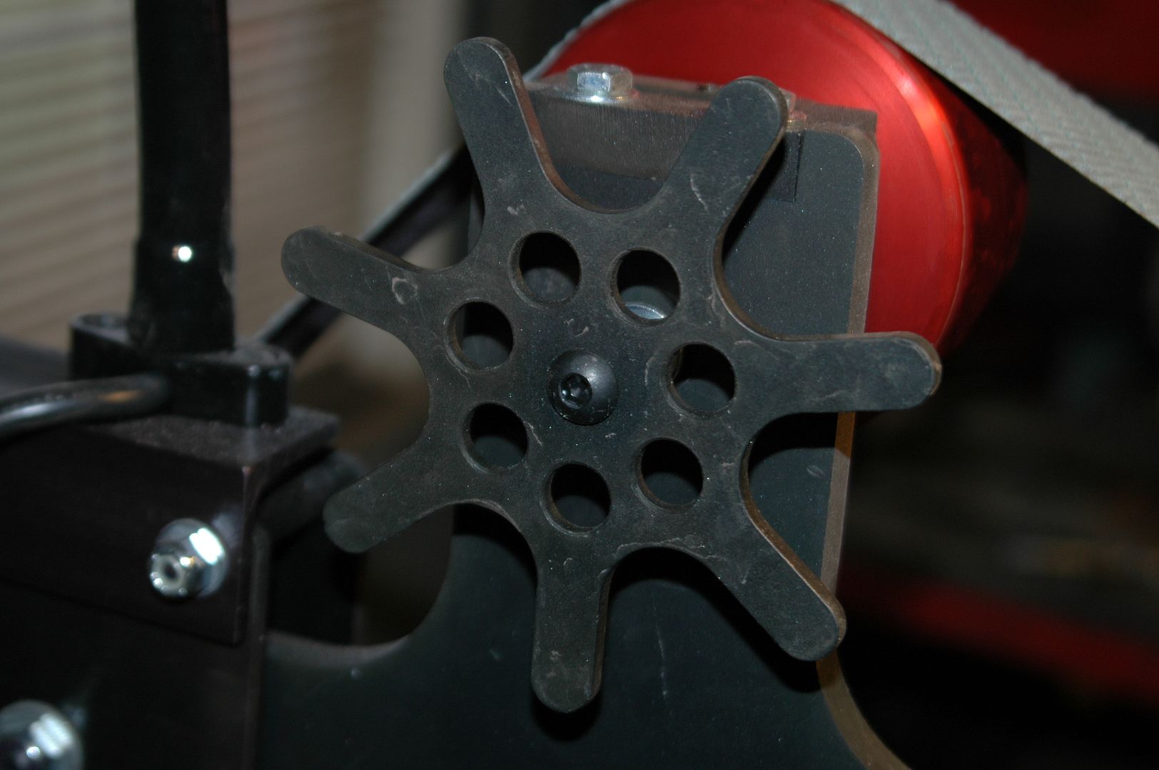

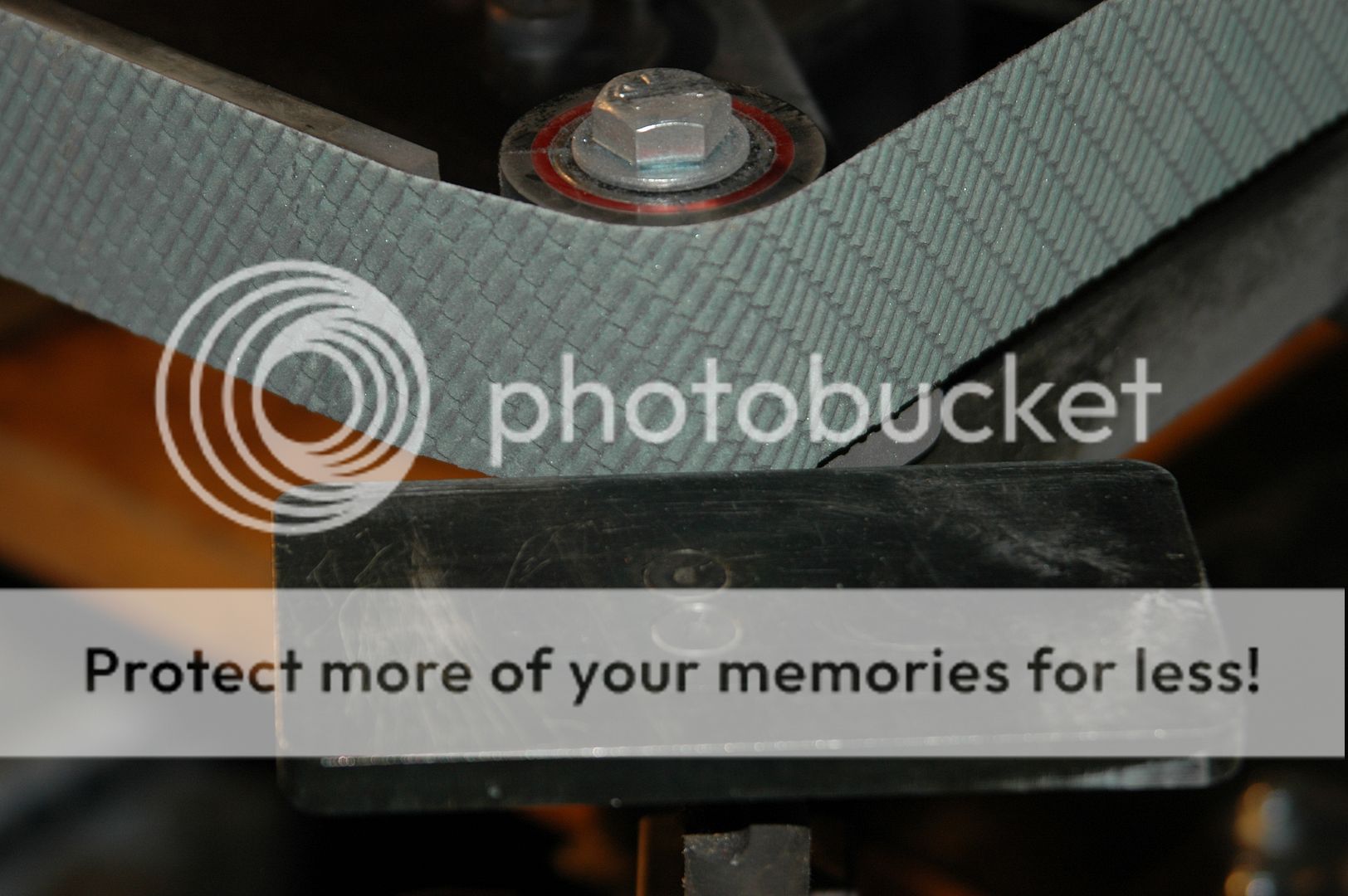

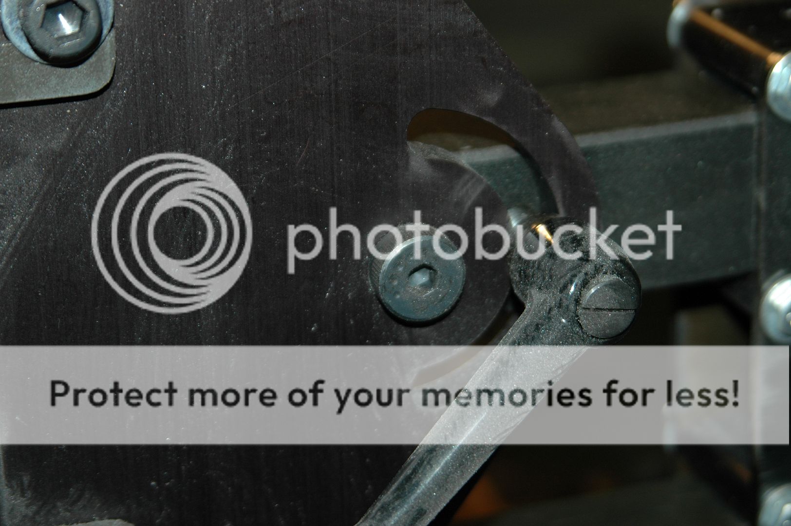

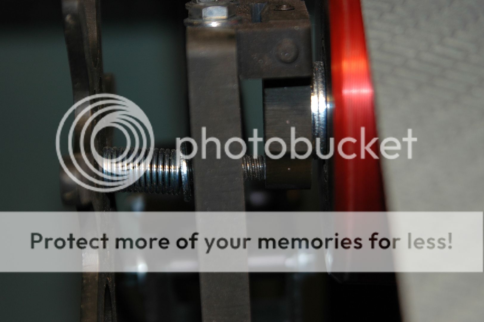

Tracking assembly
The tracking is great. Slight adjustments are available with the turn of the star. Contact is solid between the screw and adjustment plate. The star is just plain cool!

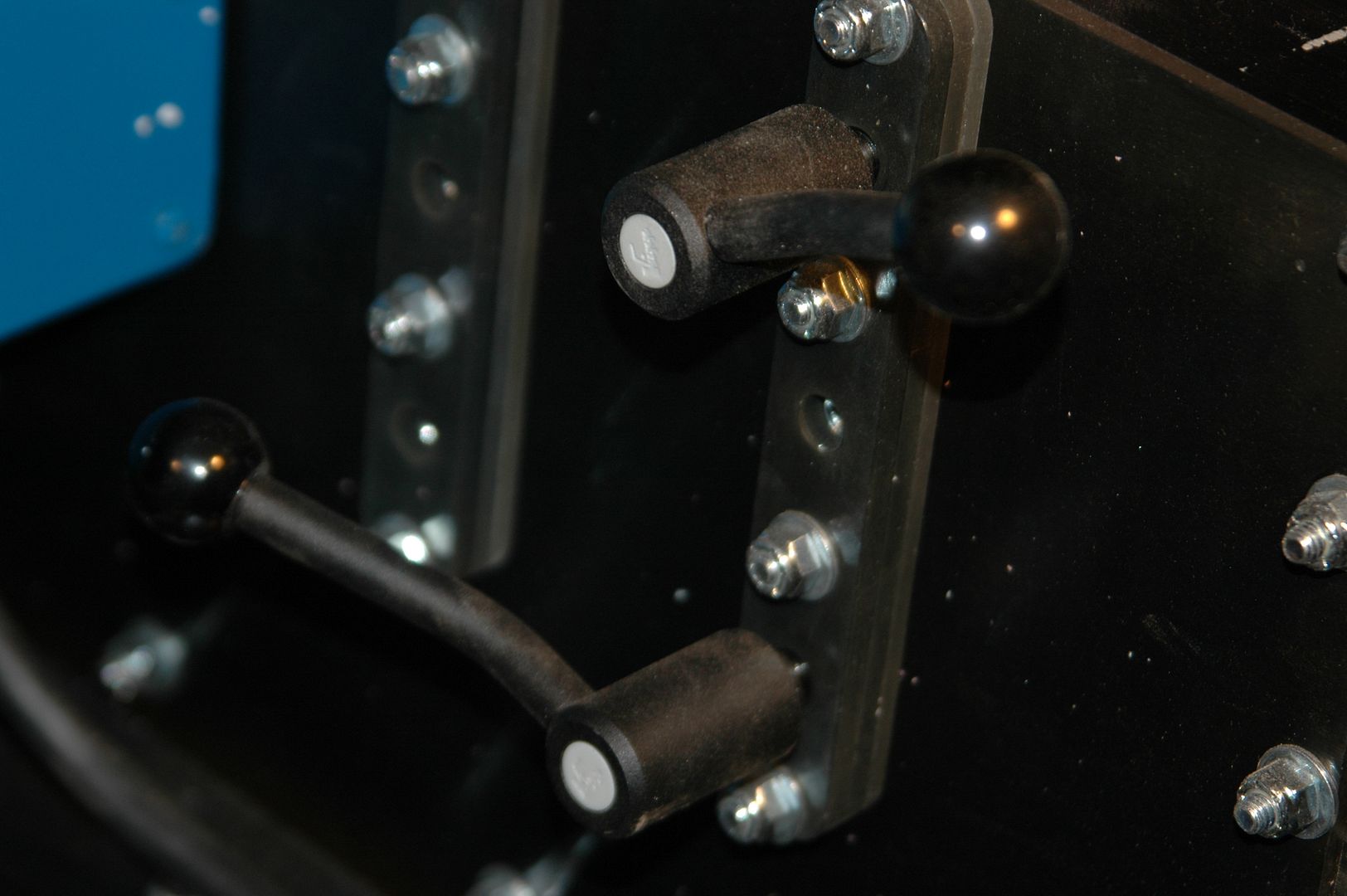

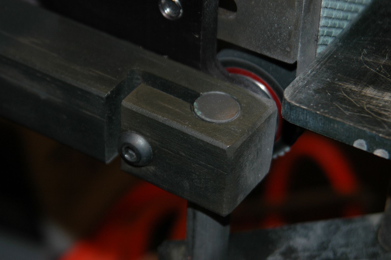

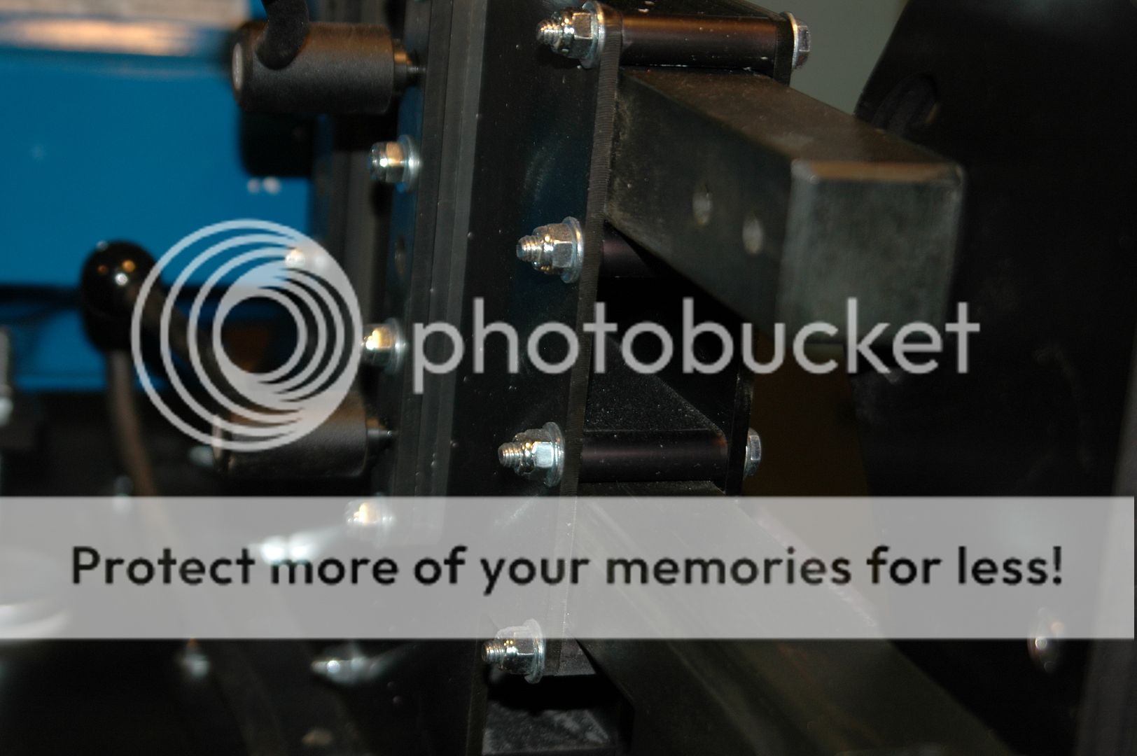

One of the neat things about this machine are the tooling arm slots. It allows versatility in horizontal and vertical work. All arms are locked down with beefy angled levers

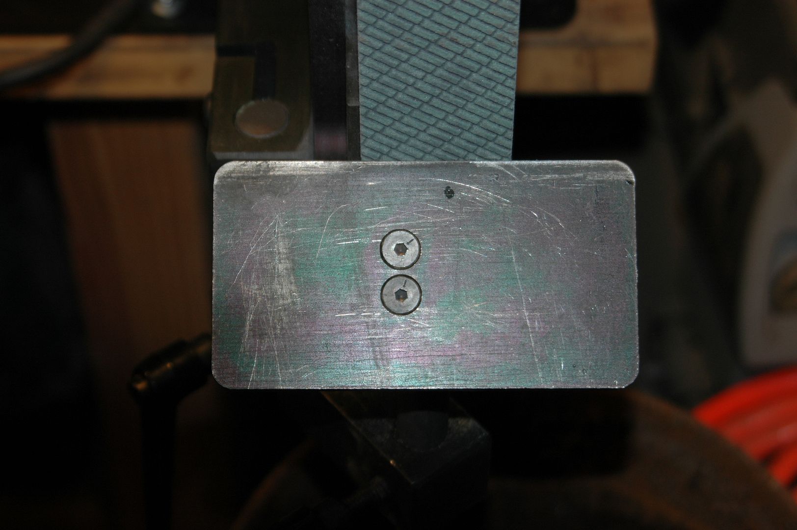

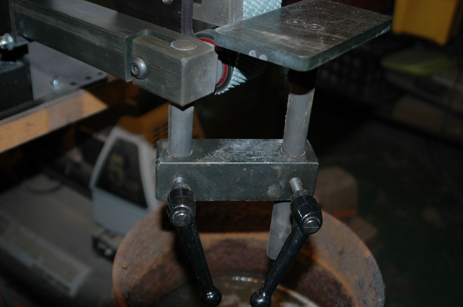

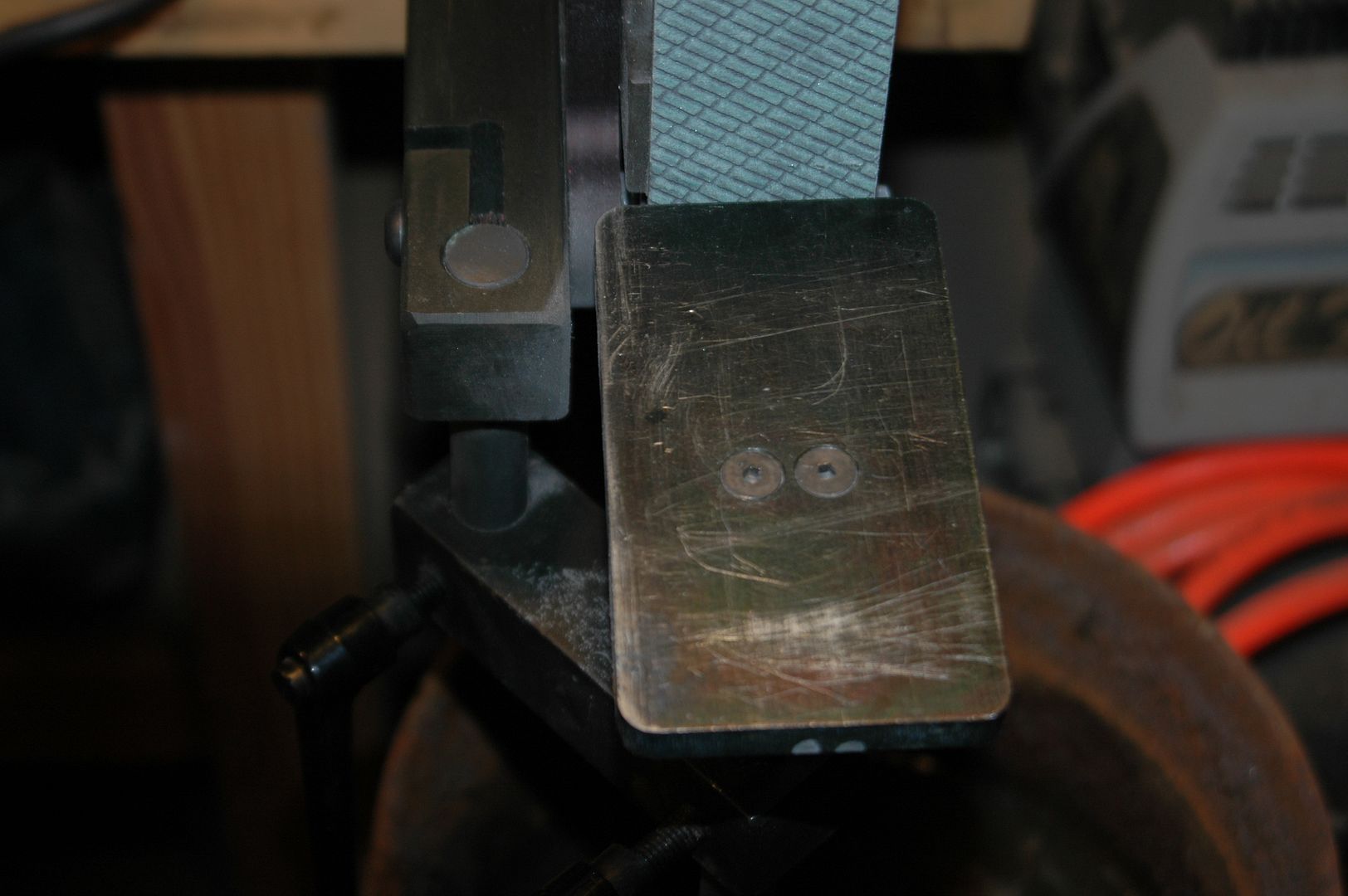

IMO the star of this grinder is the toolrest. It is so versatile and solid as a rock. I was initially a little skeptical with the round bar used but it is not an issue. The rods fit real tight and are locked in by a bolt that closes a relief cutout on the tooling arm. There are also levers to help with fast adjustment. This thing is awesome.

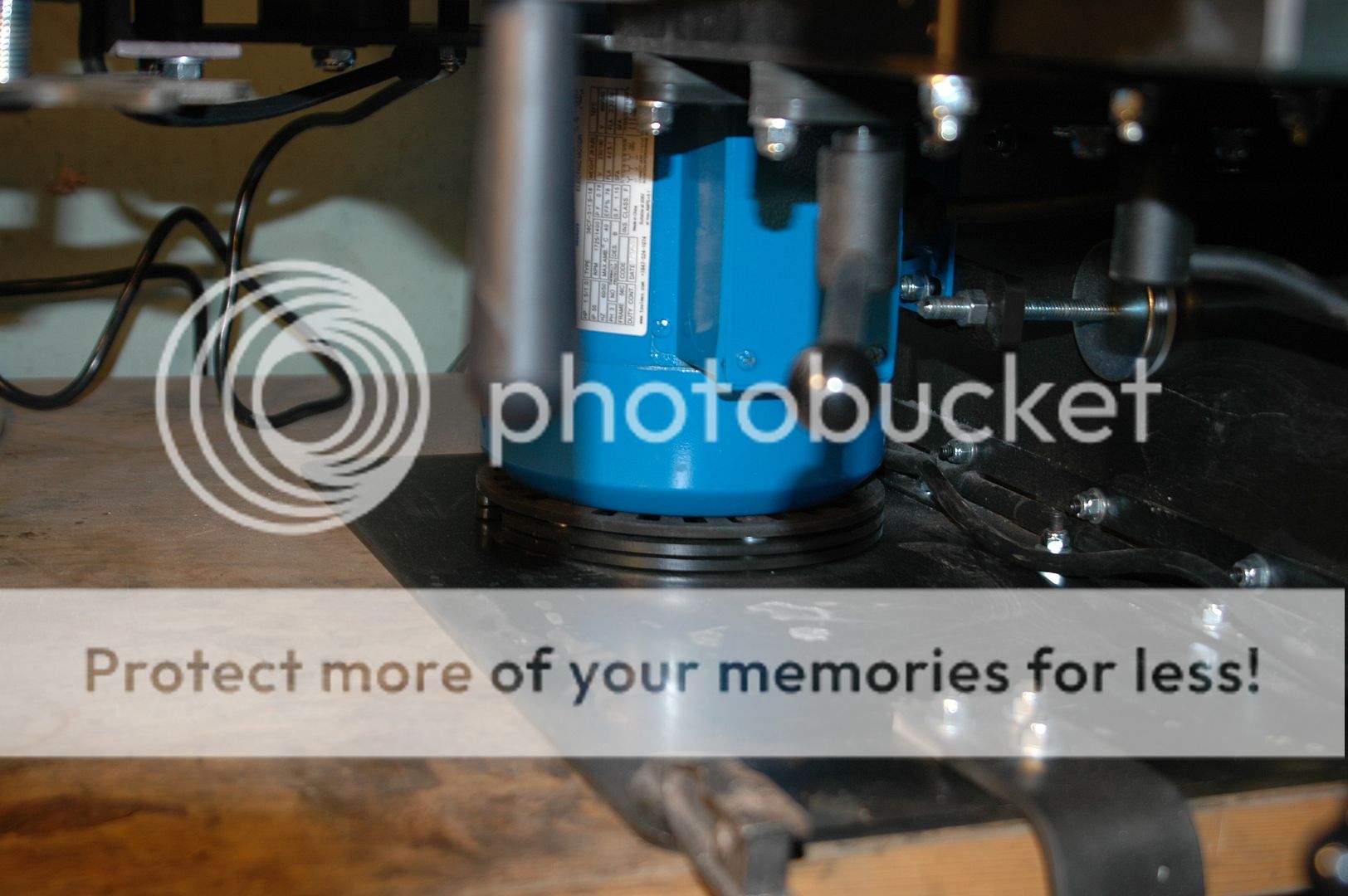

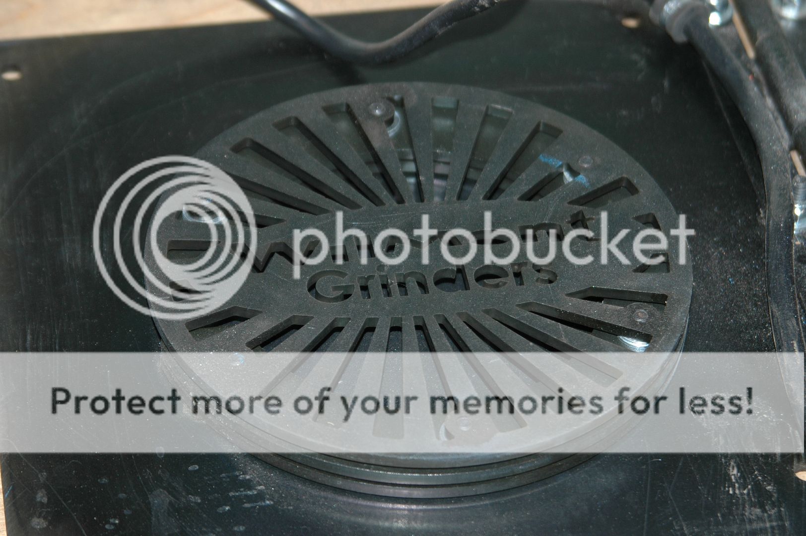

I was excited to try out the horizontal grinder. Ive never used one before and it was one of the reasons I chose this machine. It comes with a flipping base plate system with a cool motor mount that allows air flow. Its not hard to flip but it is heavy. A handle would make things easier. Wow, I should have gotten one of these along time ago. So much versatility and options. I don't have my small wheel attachment yet but will be getting it soon. I will review that when it comes as it is a neat system. The toolrest really shines in this position. I will eventually order a second toolrest so I can use different sized wheels and two toolrests at once. The arm slots will allow that.

All in all this is a great machine. I can't imagine anything more versatile. It will allow me to be much more efficient which is huge being a part time maker. The only thing I would like to see is a handle of some sort for flipping. Again, its not hard but would be easier with a handle. Anyone looking for a grinder should give the Tag a serious look. Great machine, fast shipping, and a seller that truly cares about his product and customers. A+ in my book!

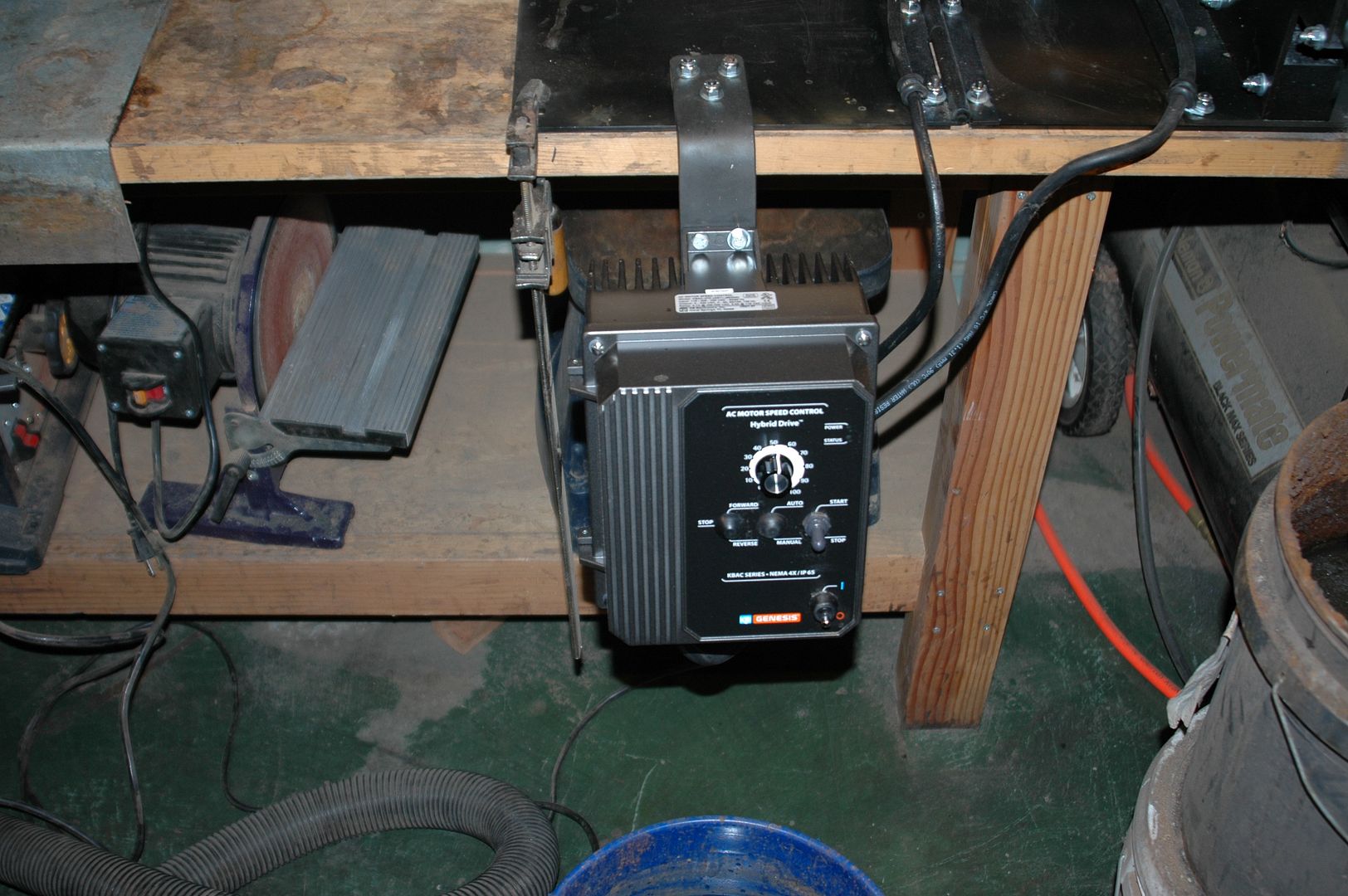

Woo nice man! I just put mine together last night. I put a 3hp motor and a kbac 29 on it.. ;D
I had planned to build another from scratch, but I'm happy I decided to just buy the TAG instead. Even though I've used one many times before, I could never have made it as nice myself. I also see so many ways Wilmont has refined the newer ones versus the one my buddy has, which is from a couple years ago. I mentioned to CW about a handle for flipping also, my motor is *HEAVY*, I'm sure our feedback will be well received.

1) Put the 2" contact wheel on the top instead of the bottom, that'll allow you to do minor profile refinements without moving the tool rest or loading in a larger wheel. These used to ship with two of the red "idler" wheels, but I think Chris has started to ship all the flat platens with a contact wheel for this reason in particular.
2) Adjusting the flat platen to sit more flush with the edge of the contact wheels will decrease noise from the belt riding over the platen edge, that's how I like mine, but you may have reasons for it being the way it is, so if so, I understand. Just thought I'd mention it.
Another thing I plan on is making up a batch of tool rest top plates, with radiuses cut to match different contact wheel sizes for up close work in horizontal. Two screws to change them out, would be pretty quick.
Thanks man, I never even thought of that. The platen was actually just installed for the pics! I had it off convexing some knives last night. As for the noise, this thing is real quite. I was expecting it to be much louder.

I agree with Javan's points like putting the 2" contact wheel on top. BUT, about the multiple top plates thing... If it's not too much hassle, I'd suggest making the round stock attachment for each one as well. Normally removing two screws is as simple as simple does... until you are talking about 2 screws that are full of rusty grinding dust! ;)
I used to attach my tool rest giz-wizzes with screws, until the day I spent an hour with Kroil and a tungsten point trying the clean out the allen heads in order to remove them :eek: :grumpy: After that I decided to just make separate tool rests.
