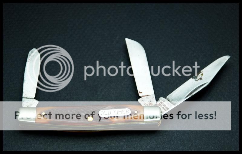

I whined about my loss for about a week to anyone who would listen and then got on with life. About a month ago a friend came up to me at a club shoot and handed me an Old Timer he had purchased at a gun show for $8. Needless to say, I was overjoyed at his generosity. The newcomer was a little bit worn so I set out to spruce it up. Here's the knife as I received it.

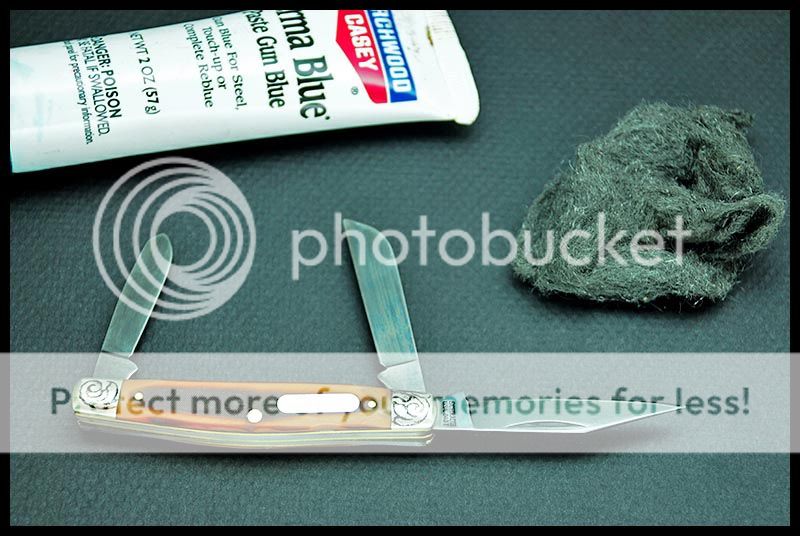

I used my Lansky to reprofile the main blade and then sanded the blades to a satin finish. When I got done they looked pretty good but I was worried they would rust easily, so, I went ahead and gave them three coats of cold blue. Here's what it looked like after the bluing was done. I could have applied additional coats but this renovation was already taking much more time than I anticipated. Any more patina would have to come from use. In this shot you can also see I filed off the Old Timer stamp and did a rough sketch of some engraving for the bolsters.

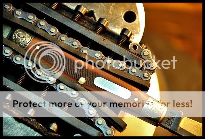

Here's the knife in the vise with one bolster done and the main lines on the second cut using a magnifying visor. Next step is to use the microscope to clean up initial cuts, shade the leaves and put in a bit of background.

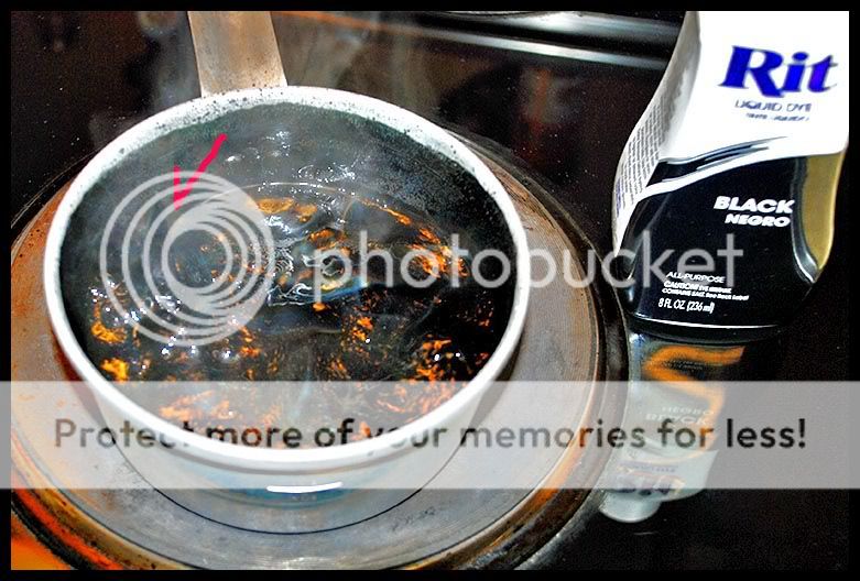

With the engraving done, I fired up the stove and boiled the knife for about ten minutes in some black dye.

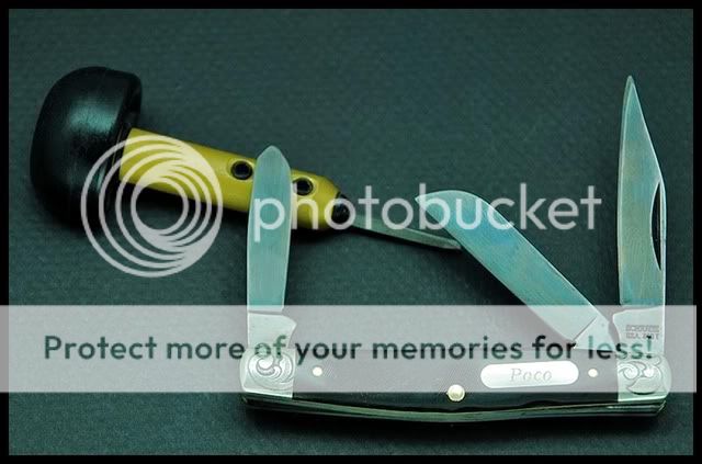

And here's the finished knife. It's not perfect but it will have to do for now. With over 7 hours in it, my efforts at renewing my new-to-me daily pocket carry was not unlike a feller putting a $400 saddle on a $5 horse. Still, there's not another like it in the world and that's got to count for something. :D

Awesome.... I love the engraving , and that contraption you have on your vise , what is it ? Looks very useful for knife modding :) I did not know you could dye Derlin !? I have three or four Old Timer pocket knives in various configurations.

Contraption is a jig for knife engraving, it's adjustable in two planes and adaptable to odd shapes. I didn't know you could dye it either but seemed like it was worth a try. Unfortunately, all I could round up was an old partial bottle that was a bit "clumpy." Next time we're in town I'm snagging a new supply and give it another go.

I don't think I've ever seen anyone dye delrin before. Can you tell if it made the scales swell at all? I've been having thoughts about maybe trying to dye a Sodbuster orange...

Kozak6: As far as I can tell, the scales did not swell and I boiled them quite a spell. I would say, give it a try. If the orange doesn't work out you can always redo them in black.
