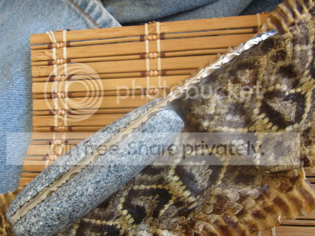

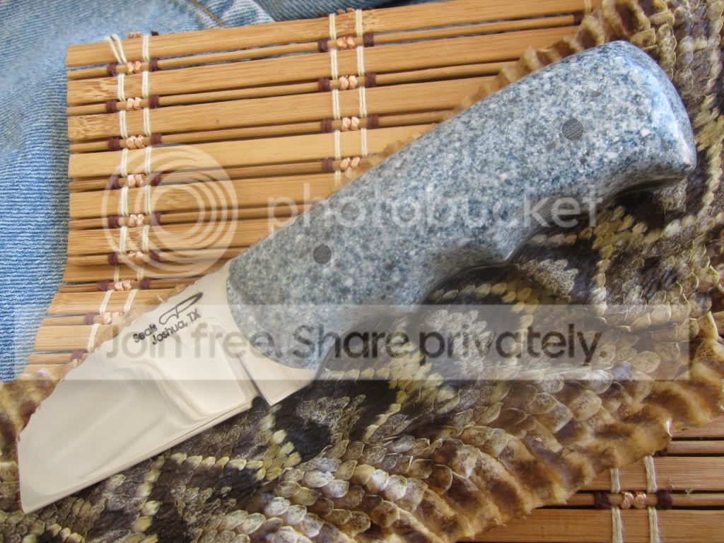

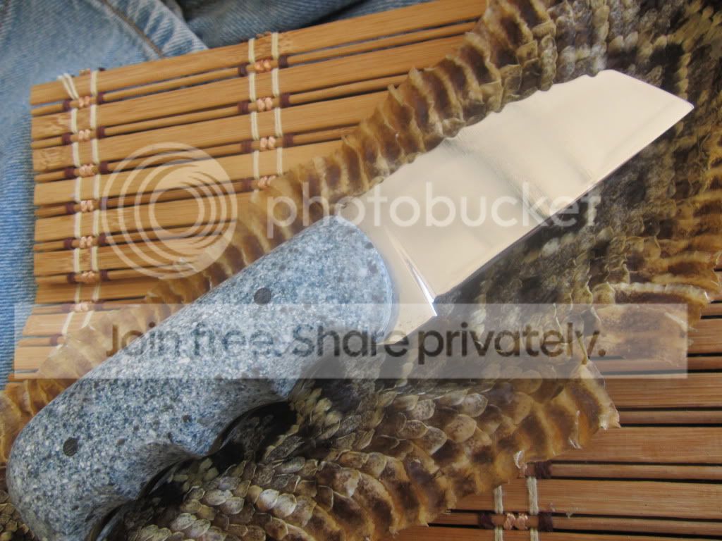

richardj gave me a very ugly piece of steel to play with about a year(maybe 2?) ago.If you've been around here awhile you know about Richard the sharpening with paper wheels guru and all around pretty darn good guy.He makes knives from Used John Deere 1075 that was not only hardened by Deere,but Ohio corn patch work hardened for lord knows how many years.Well,i avoided that piece of steel for months,tried grinding on it a few times without making much headway.Did i say Richard insisted it was best to grind it without annealing it?Yea.And its very very hard?OK,well with the help of 36 grit Norton belts and quite a lot of time i finally got the thing finished.Oh,yes,it was about 3" longer ,but it came up with a crack when i quenched it at heat treat.I beat the tar out of it around the shop a few months before deciding i had enough meat there to make a knife without a crack.Well,it turned out pretty good i think.If not the prettiest girl at the prom ,she's sure a hard worker!Ive chopped up a few pine 2x4's with it and could have quickly reduced my oak work bench to kindling,but luckily came out of my chopping daze before getting too far.Anyway,thanks richardJ ! And im ready for another chunk of that ugly steel anytime you get some extra!

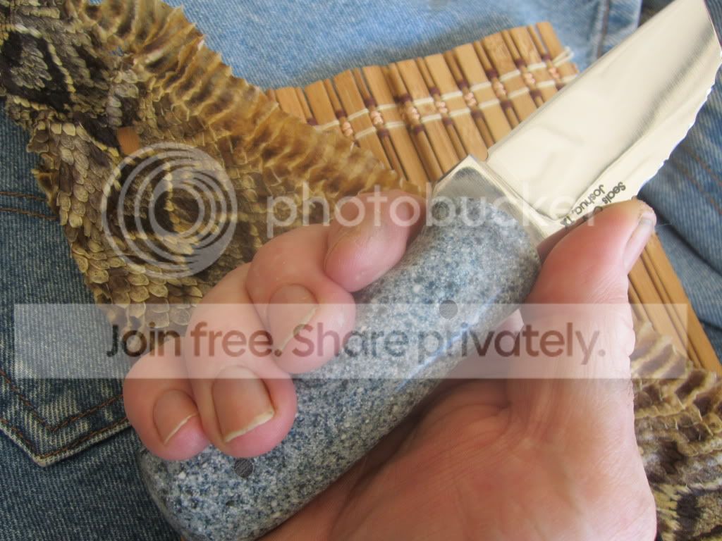

Thanks fellas,Specs..lets see...Knife is about 7"oal with a 3" blade tip to scales.Thickness at the spine is .155.Flat grind.Granite corion scales(that counter top stuff) and micarta pins.Bit of a chunky monkey,but it feels good in hand with the grooves.

I like fatter handles on a working knife. Easier on the hand.
