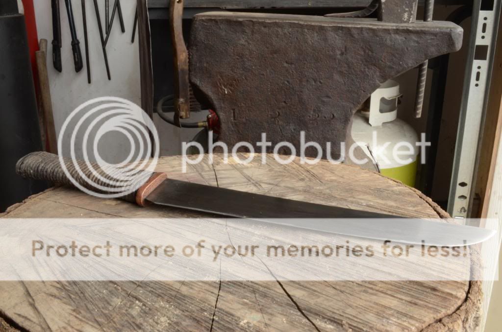

I've gotta' ask--what's up with that anvil? Looks like it's missing its horn!![]()

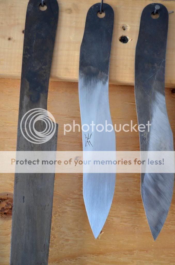

The white is 4000gt and the yellow is 8000gt.What grit is he using there ?
Yup, I used to spread the rumour about Grant's march and knocking the horns off to cripple opposing forces..... but that story turned out to be BS. I guess the simple explanation is that the horn/body junction it the weakest point and some just break off with heavy use. Not as interesting. That anvil has been dated back to the Early 1800's.I've gotta' ask--what's up with that anvil? Looks like it's missing its horn!![]()

The wet paper does a great job of extra fine stropping.I've never seen the paper-on-the-stone thing before, thats a cool idea. Would that produce a finer finish than a plain(no compound) leather strop?

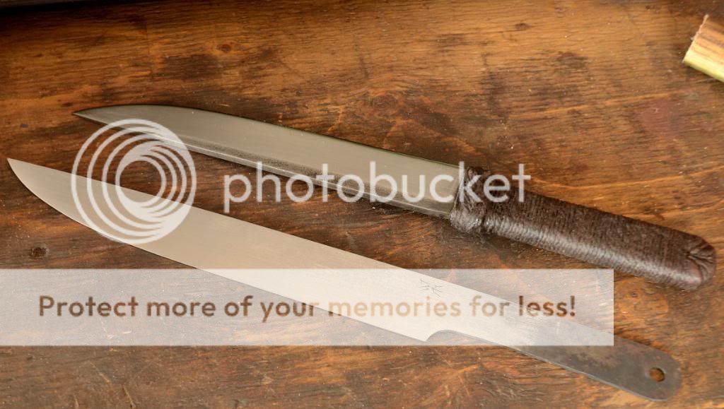

Thanks TF... I think the mousepad is good for touch-ups but it can change the geometry over time. This is mostly due to folks pushing down too hard or lifting the spine... OR not starting out with a true convex, in the first place.I think many knives, with the 'mouse pad and sand paper' method end up with a large shoulder right behind their edge that makes for a sharp edge - but a poor slicer. The rocking action you see Rick doing takes that edge off and makes the whole shoulder and edge a true convex.

Very informative. These blades look fantastic.
