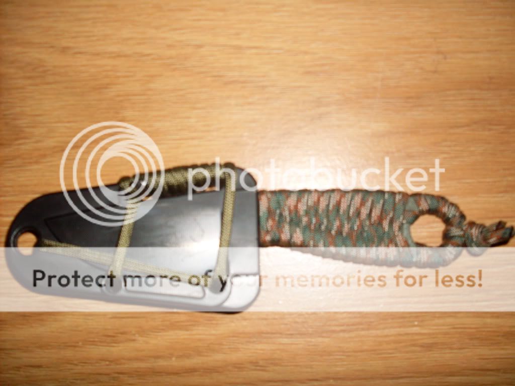

Thought id put this up here so that other people who dont want to spend the extra cash on a tek lok or whatever you where thinking about buying, have a cheaper alternative for more carry options for your IZULA.
1 piece of paracord about ?? feet long is all you will need.

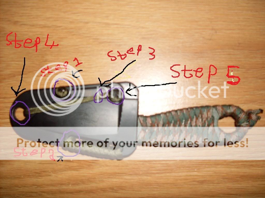

Make sure you have the knife held the same way as i do in the picture. Sheathed and blade facing away from you. Will make it easier to follow the step by step instructions
Step 1) From the bottom, push the paracord through and tie a knot. Burn it to prevent fraying.
Step 2) Take the paracord and bring it under the sheath and through the gap [ ] it has in the sheath and over so that you are wrapping it towards you. Do this until the end of the gap making sure you keep the paracord tight in the process.
Step 3) Pull the paracord under the sheath and put it through the hole directly opposite where you just finished wrapping.
Step 4) Pull it tight all the way to the bottom of the sheath and feed it through the large hole.
Step 5) Bring it up and put it through the top hole (the one you have fed it through already). Tie a knot, burn the ends and youre done.

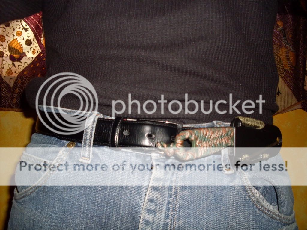

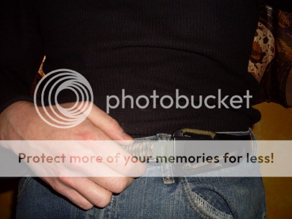

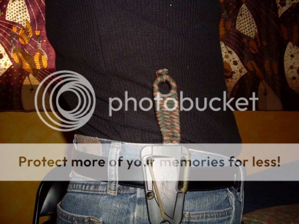

Happy horizontal/vertical/inverted carry. Just remember to keep it tight at all times and make sure you have solid knots.
