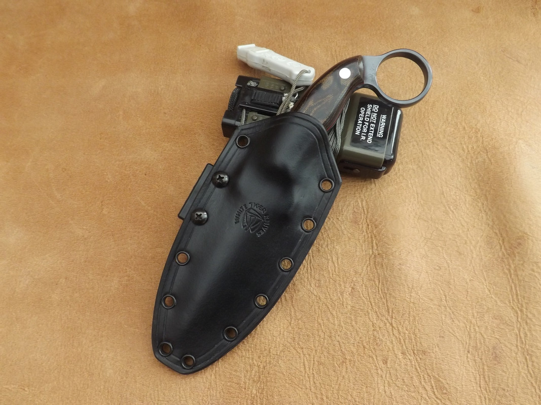

I haven't posted for a while gents, I've been pretty busy with other bits and pieces.
This dagger has a gun blued blade from EN-45, blade length is 95mm, blade width is 35mm at the ricasso, blade thickness is 5mm and the overall length is 220mm to the outside of the ring. The handle scales are python skin Micarta with red liners held with two S/S Corby bolts. The sheath is a leather wet moulded pancake style dyed black with Kydex rivets and a Tek-Lok belt clip. As always guys thanks for taking the time to look and all comments and critique very welcome.
