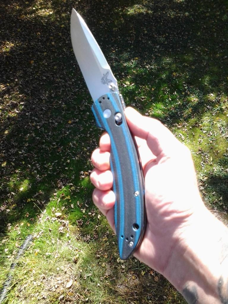

This is a Jade PM2 after simmering about an hour in Golden Yellow powdered Rit dye.
Didn't like the shade so.... Same knife after 30 minutes in Sunshine Orange Rit dye
It looks red inside and more orange in the sun.

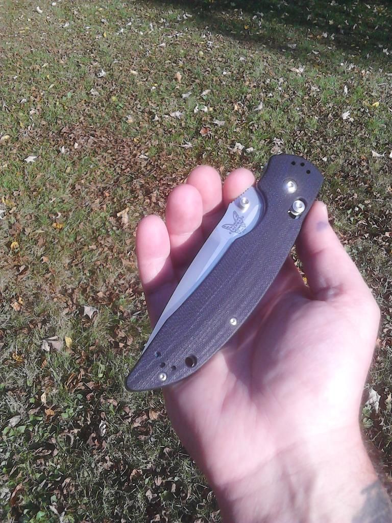

Here's a Benchmade 300 soaked in Sunshine Orange
Before color.
These are the only two I've ever dyed.
