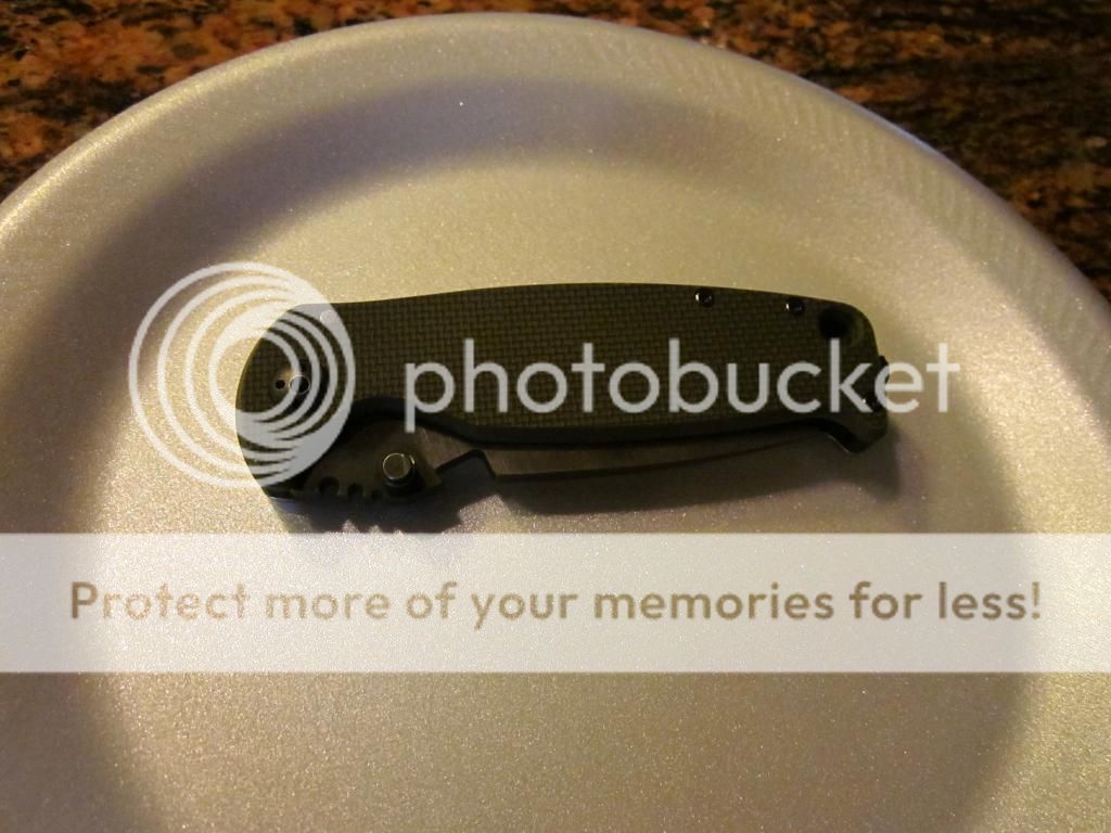

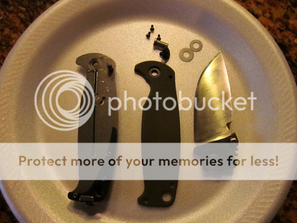

Start off with your knife you want to dye. This one being a DPx HEST folder 2.0 in green g10. (Black g10 will not take dye as for as I know for those that were wondering)
Take the knife apart. It's nice to have something to keep the parts in so they don't go missing. I'm just using a disposable plate.

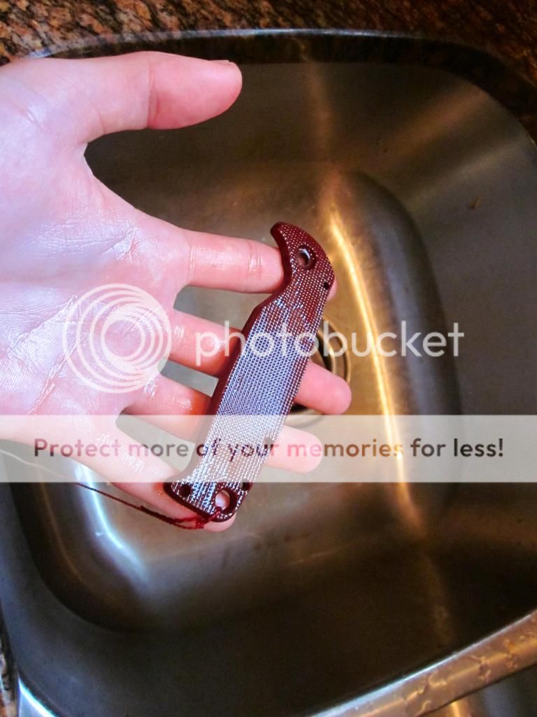

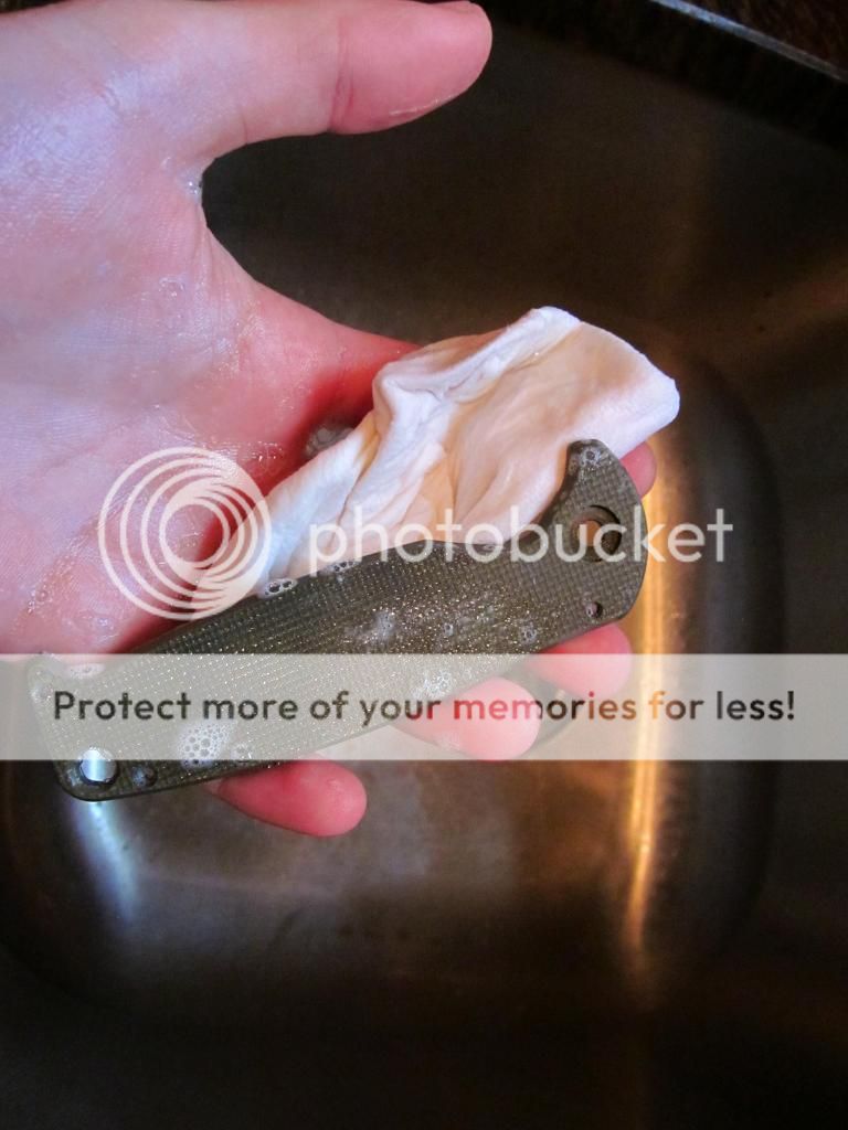

Make sure you wash your scale. Oils from your hands and dirt can interfere with how the dye takes so give it a good scrub.

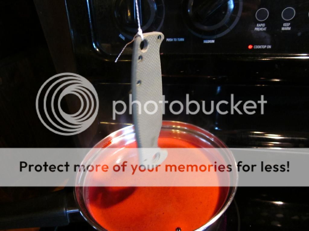

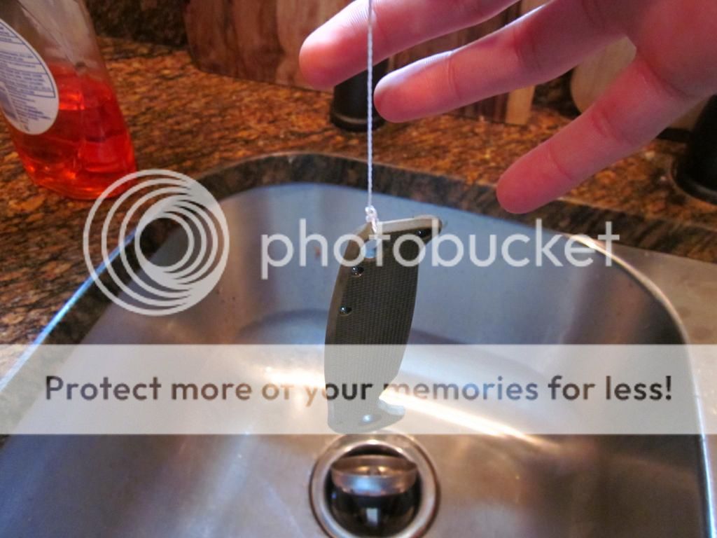

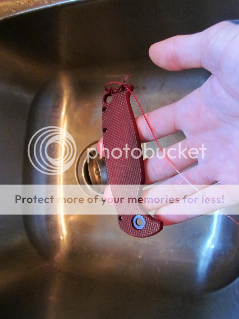

I like to attach a small string through the lanyard hole of the scale so I have something to hold on to while the knife is in the dye. I'm using 550 paracord guts but you can use anything really.

I add the scale when I can hear the water just start to boil. You don't want it boiling a bunch. try and keep it right at that pre-boiling point.
In the dye. This is where a lot of peoples methods differ. Some say they keep it in the dye over night or for an hour. It only takes about 5 minutes altogether in the dye to achieve a nice, even color. Your experience may differ.
After being in the dye for about two/three minutes, I take it out and rinse it off with cold water and check the color. I could have stopped at this shade but I figured I'd throw it back in there just because.

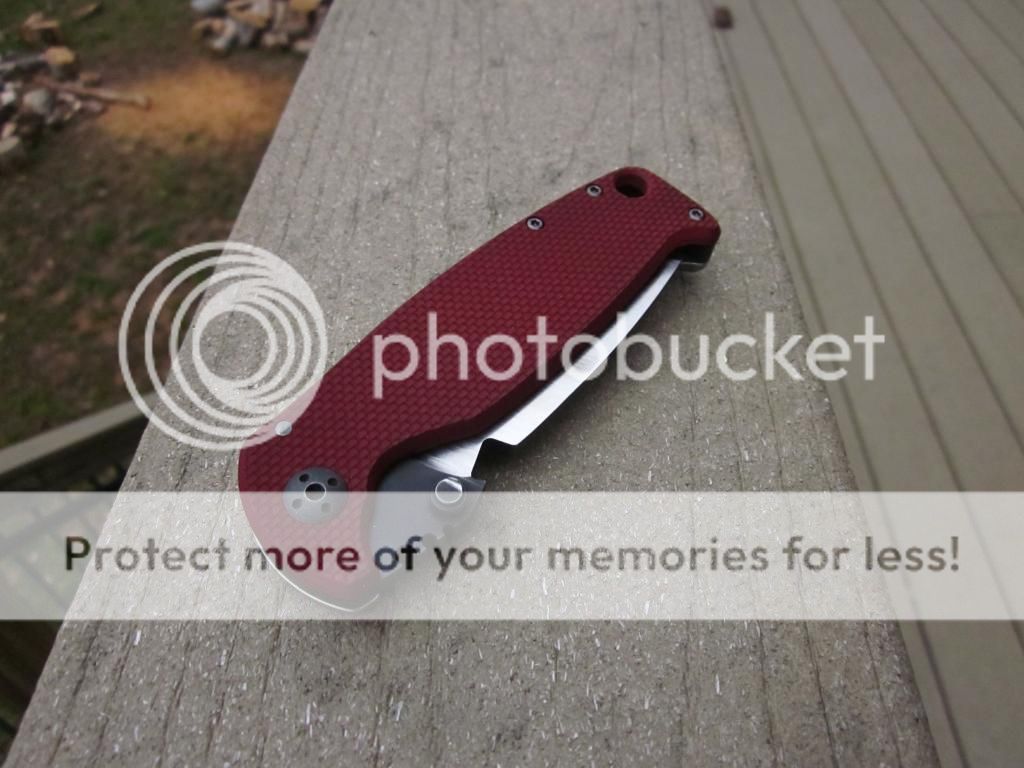

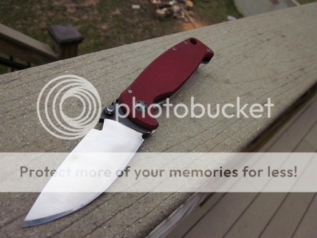

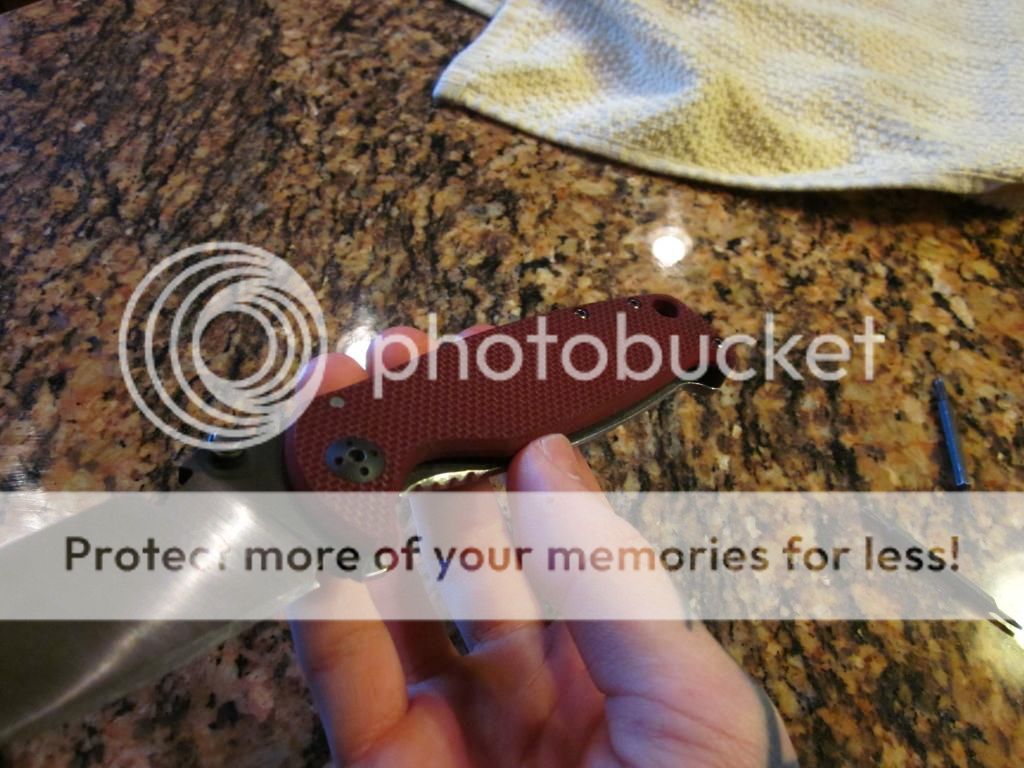

Here it is all finished up. That darker area in the lower middle part of the scale is just wet. I missed it when I was drying.

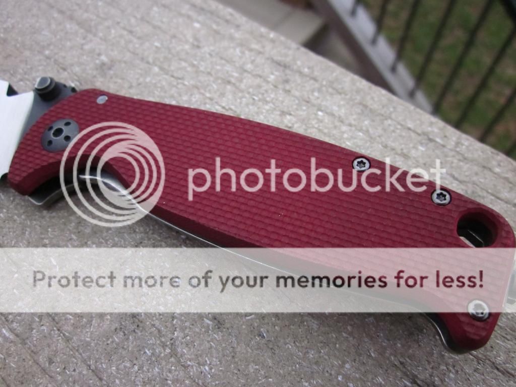

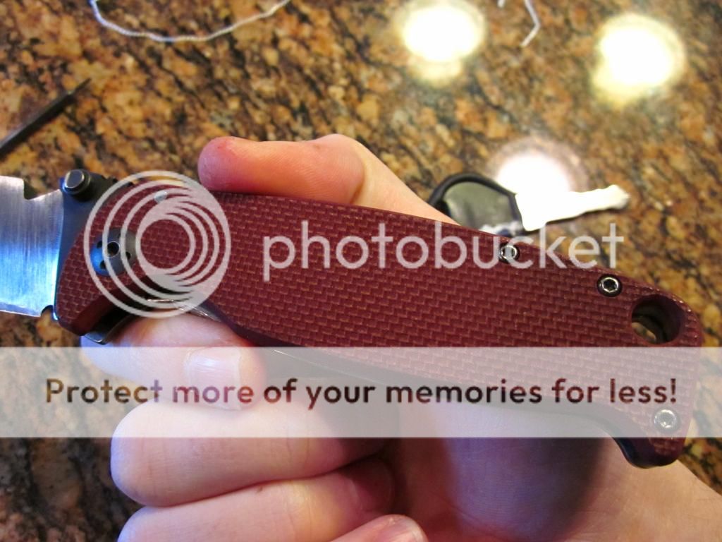

HEre she is all back together.
EDIT: Here are some better pics.
