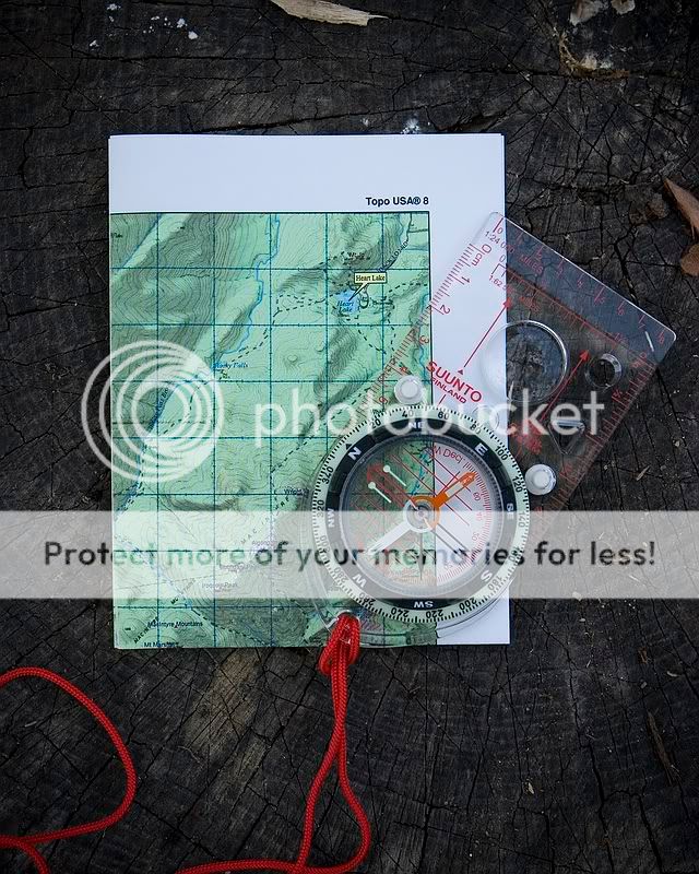

I like to carry my maps folded in 1/4. It is a small size that I am actually willing to hold. At 7.5 minute scale, you can walk quite a distance on that much space. When I move off the page, I just fold again.

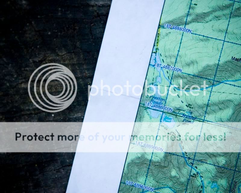

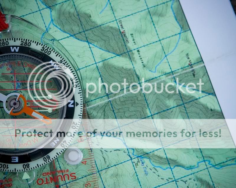

So, my first test was to fold over and over again on the same line. While you can not expect any map (including original USGS ones) to not deteriorate along that line, I at least wanted to make sure it was on par with normal paper. You see the wear line.
It seemed no better or no worse than regular paper.

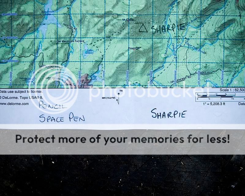

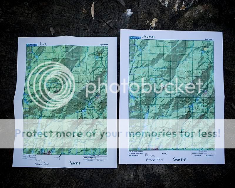

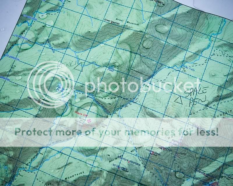

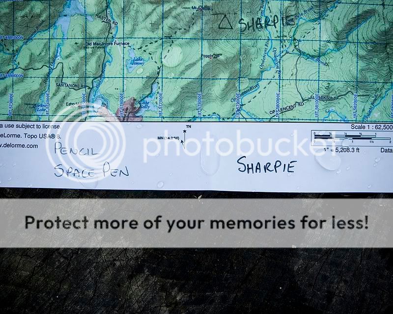

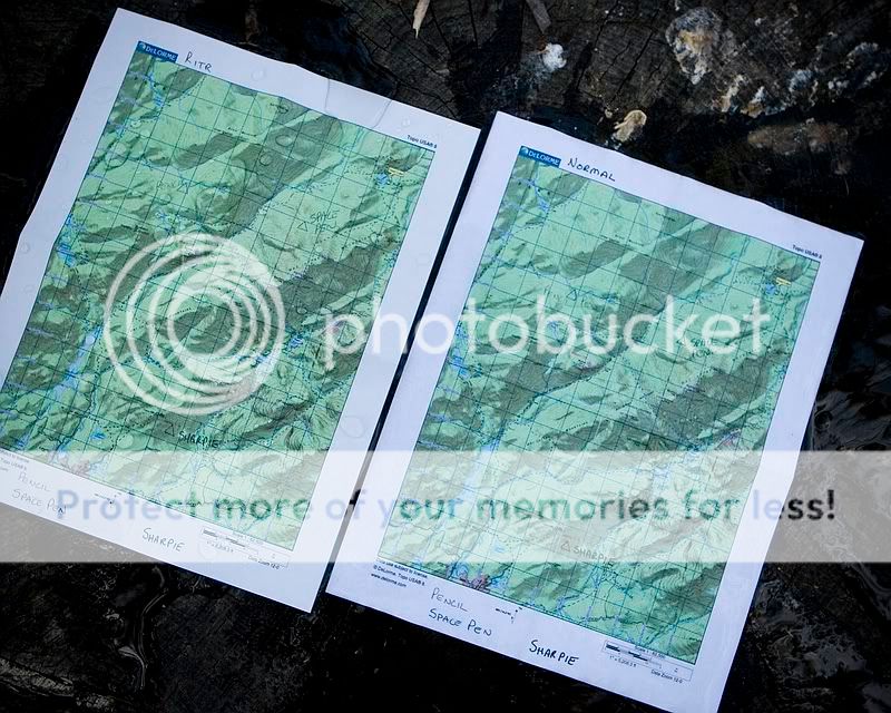

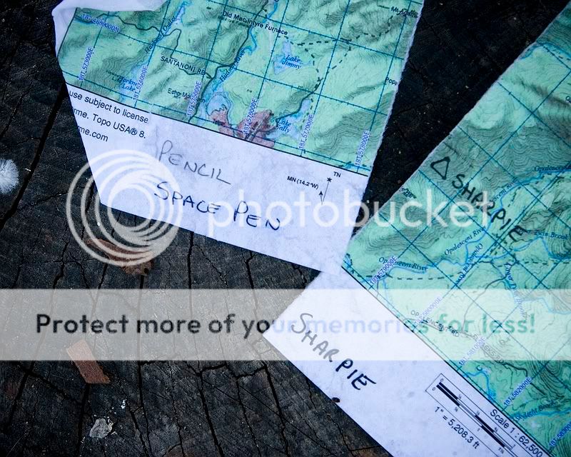

Now on to some testing. I took two maps, one on RITR paper, and one on normal paper.
On each I wrote on them in pencil, space pen, and a permanent sharpie.

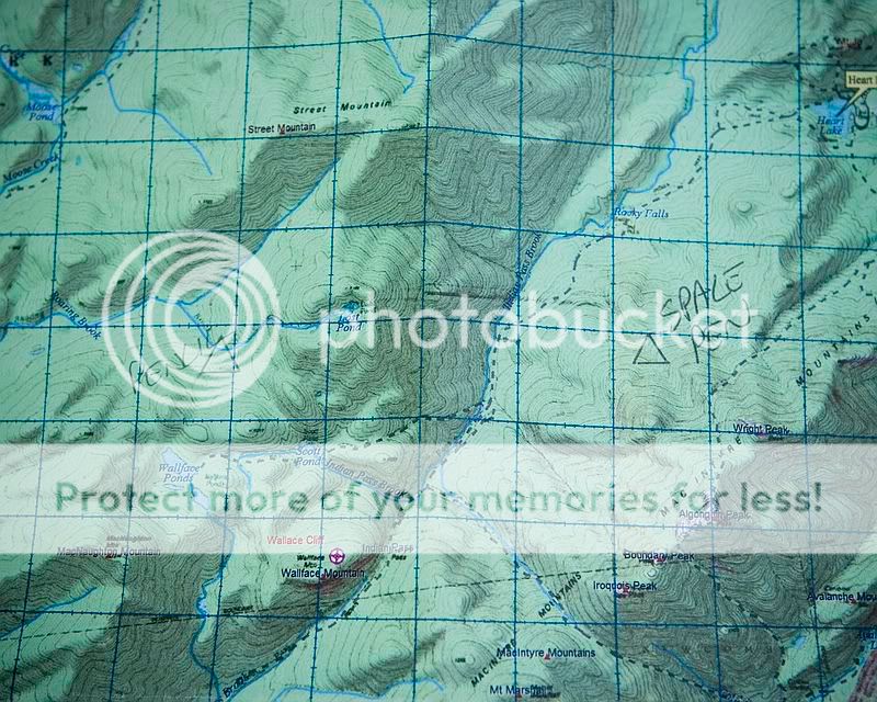

I did that both in the white space and the printed area.
First, I did a simple water pour. Pouring 1L of water of each and seeing what happened.

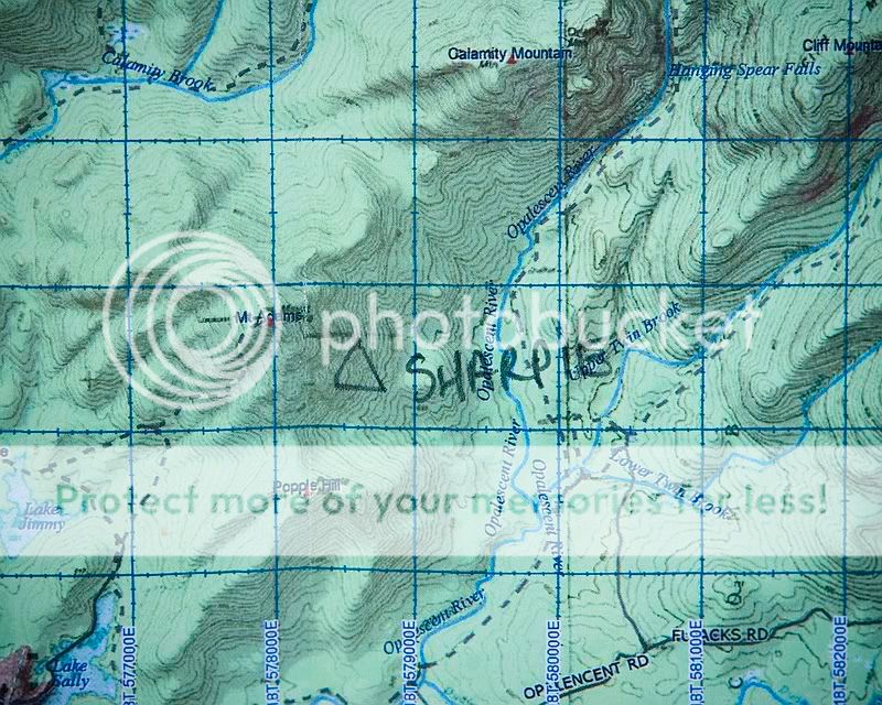

Close up of the RITR paper.
To Be Continued......
Markings were not effected on either.
The RITR paper actually felt no different. It still had its "stiffness" about it, and really nothing seemed to have changed.
The regular paper was already limp.
You can see it looking saturated.

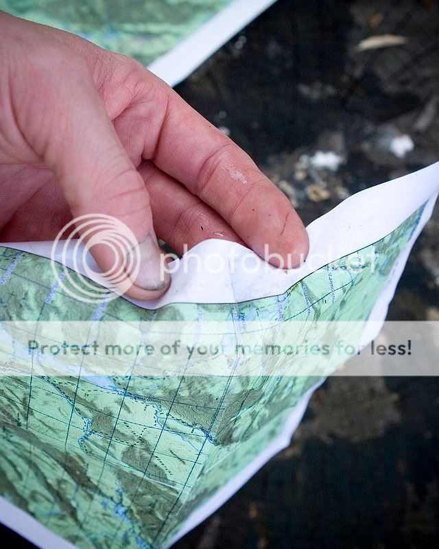

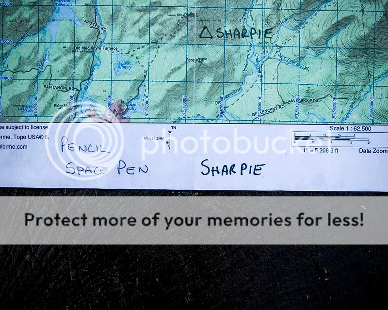

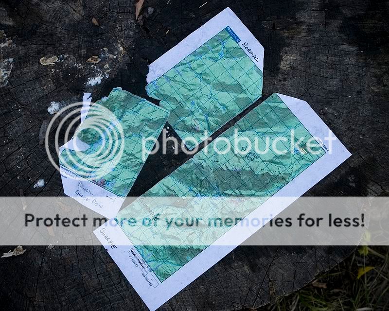

Next, I submersed both together in my sink for 30 minutes.
The regular paper did not make it back out alive : )
But, it is interesting to note that there were no issues with the markings at all.
I assumed one of the selling points of RITR paper is that your writing will be preserved through all kinds of conditions. Instead, it seems like there was no issue with marking on either paper, but rather a matter of the paper itself surviving.

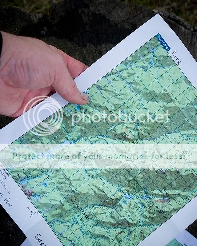

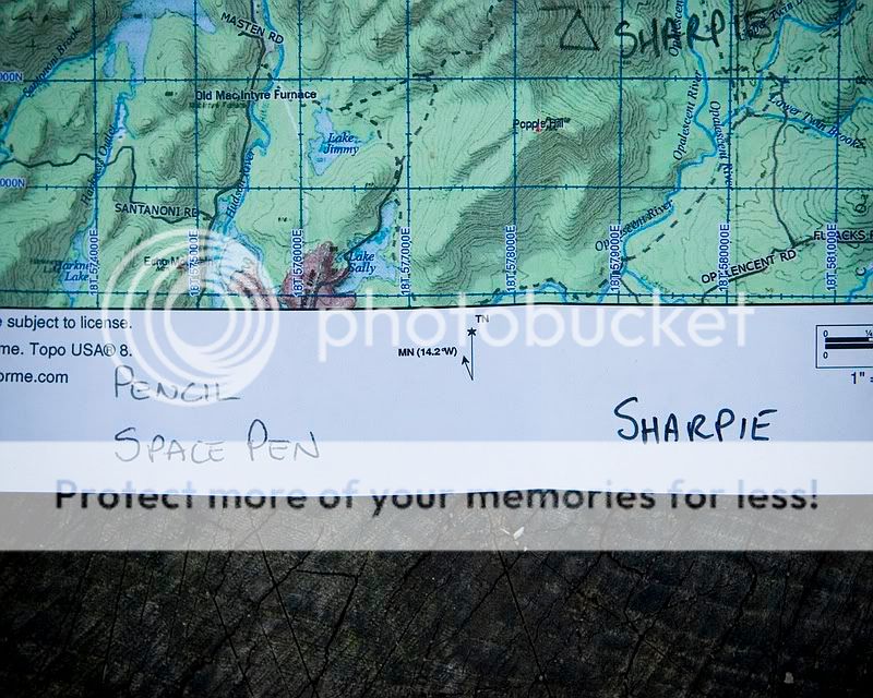

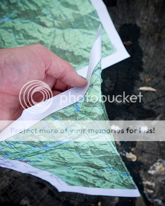

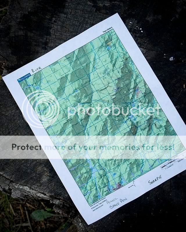

Now the RITR version.
After the soaking, it did not feel as stiff as it did before, but it didn't feel fragile either.
All of the markings looked perfect.
While it was in this wet state, I folded it over and over along the same line. It was the movement that killed the regular paper, and I figured if this stuff was going to have a weakness, this would be it.
But, it did that just fine. You can see the crease where I folded it, but certainly no damage, and no tearing.
