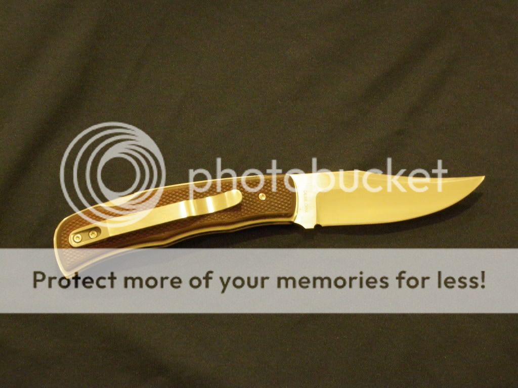

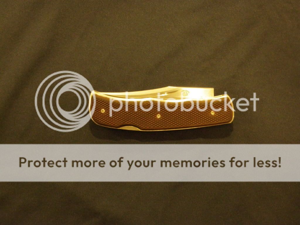

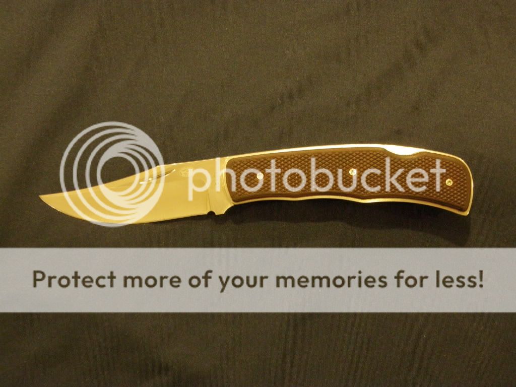

I have been hearing great things for a while about the CAS Hanwei- Rock Creek Knives, and in my limited experience they seem mostly true. I havent seen much info about this knife so I wanted to get this out there.
Recently purchased the Rock Creek- Teton lockback for under $40, and I'll say it now, I am happy with my purchase.
I'll post some pics and give some of my opinions about the knife, please feel free to comment ask ans any questions.

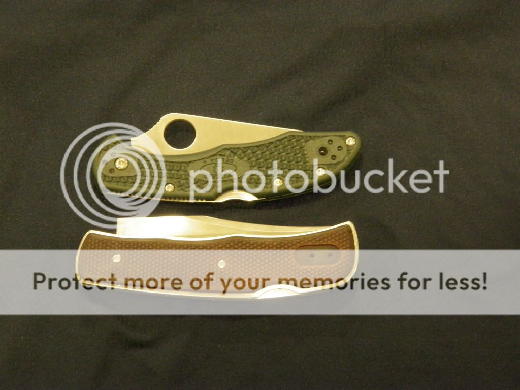

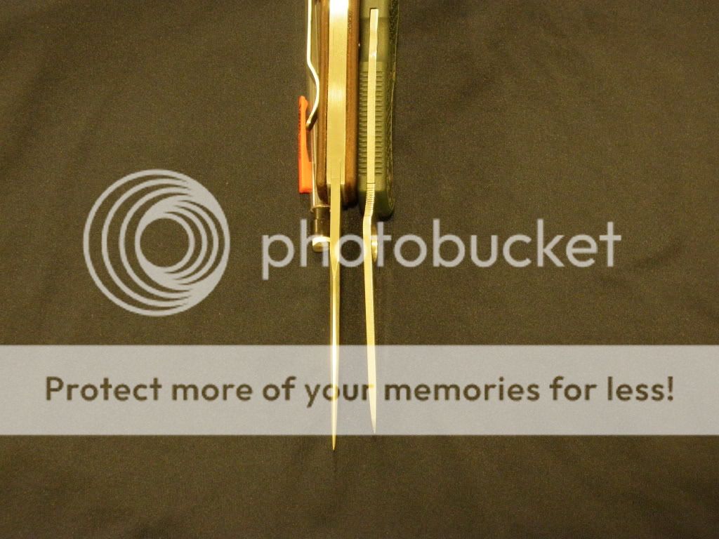

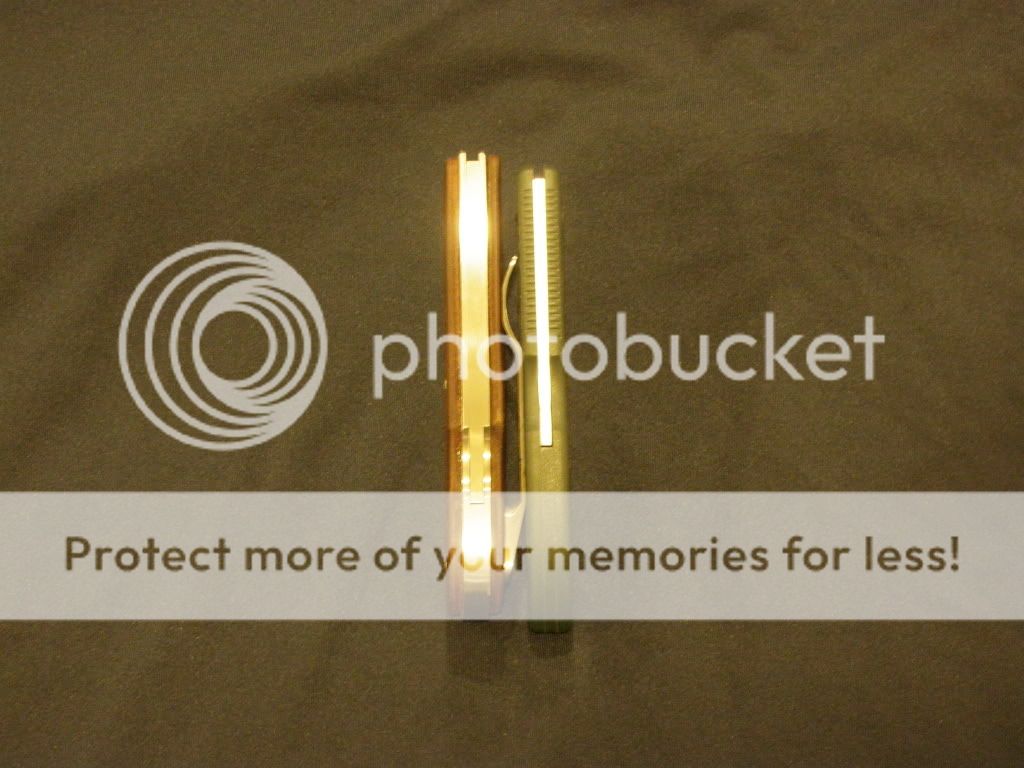

Firstly size is very similar to the Spyderco Delica for reference, except the Teton is quite a bit thicker.
It's somewhat heavy at 4.4oz on my scale, but not too bad on this style knife and the liners are not at all skeletonized, I believe they are stainless steel.
The knife is extremely comfortable in hand and through extended use I think most would find it very comfortable. It is even very comfortable to choke up on the blade.
The knife opens very smoothly, and there is no need to use the nail nick, a light grip on the blade is all you need, and with some practice one hand opening is not an issue.
My only comfort gripe is that in the closed position the exposed bottom of the blade is a bit sharp, a little bit like the old Paramilitary by Spyderco (Now corrected in the Para2). However, since this knife is only tip up right hand carry this does not seems like a major issue because your hand will be coming at the knife from the other side. But, if you like to carry the knife in your pocket, without the pocket clip, this may be an issue. And, the hole left without the pocket clip in is not that obnoxious.
Again this knife is only tip up right hand carry, lefties beware.
The knife clipped does not burry that deep in the pocket, and the clip is overly large in my opinion, but it is of nice quality and would not destroy your pants.
The handle scales are leather, which is a first for me in a folder, but I like them allot, they are very similar to wood, but have a slightly nicer feel, they are textured and give a nice grip.
There is no jimping, but the ergonomics offer a veery strong grip so I do not think that is necessary.
The lockup side-to-side is solid, however, there is a slight back and forth wiggle which I find in most all lockback (Delica included).
The in handle retention is very good, you cant shake it out.
The steel on this knife is HWS-2K which I believe is a proprietary steel made by CAS, I don't have much use with is yet, but it came pretty sharp, and not much time on the strop gave it a wicked edge, don't know what is compares to or how it will hold up, but I believe it is stainless.
Specs. All taken by Myself with A ruler and a Digital Caliper
Overal Length 7.6 inch
Blade Length 3.4 inch
Cutting Edge 3 inch
Blade thickness 3mm
Handle thickness 13mm
Weight 4.4oz
And please, anyone with experience with this knife, or similar, especially any knowledge of the steel please chime in, and feel free to ask any questions or comments.
