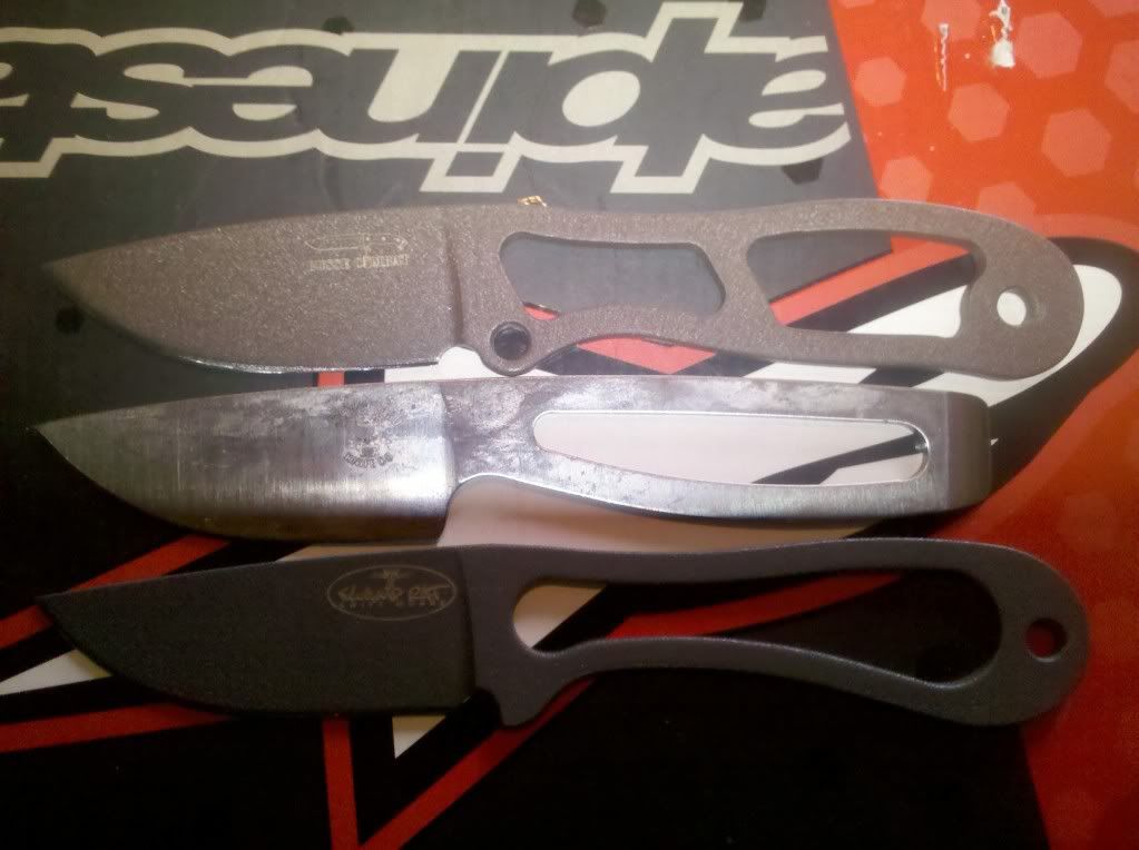

This is the only comparison pic I have. For processing that deer the RS and ESEE 3 went head to head and the RS was more comfortable and held its edge alot longer.
