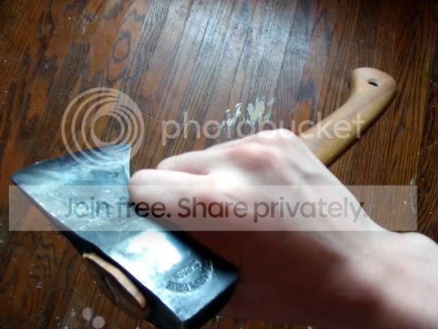

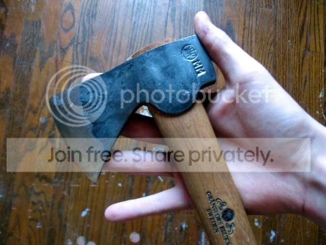

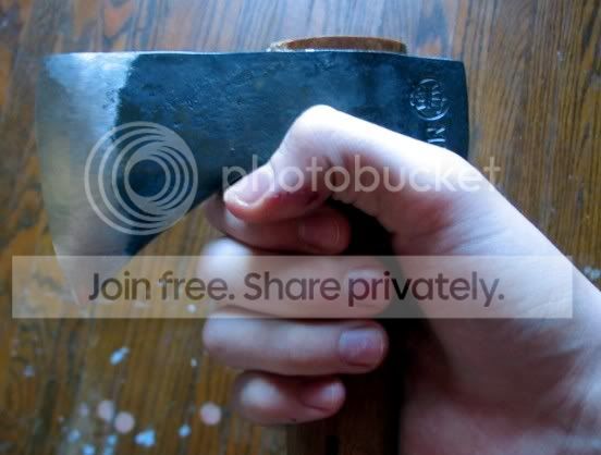

I do like the looks of the GBs that have been mentioned, particularly the Wildlife Hatchet. I had looked at the Wetterlings, but I think I would prefer something with a rounder eye so that the handle can be gripped easily right up by the head.

The wildlife hatchet from GB can be choked up very well, I'll get some pics up in a little while. ;)

Well here are the sorry excuses for pictures.
As you can -hopefully- see a high grip is capable with the WH from GB. :D
Thanks for the pics wabajack. I think you did better than you're giving yourself credit for.:thumbup: The GB is moving up on the list of contenders. I still want the Roselli, but not 'till I have something else more suited for general purpose use first.
