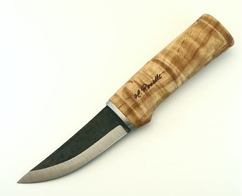

Here are pictures. The Grandfather...the short "chubby" one is mine. The other two are stock photos...haven't got my camera on 'em yet.
My Roselli Grandfather
A Roselli Carpenter
A Roselli Hunter (Erapuukko)...the handle is 5 full inches for scale.
