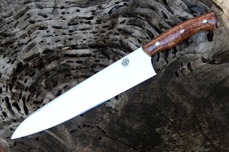

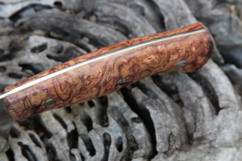

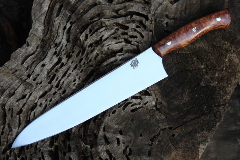

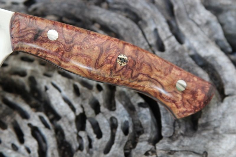

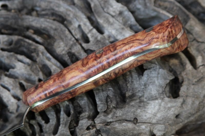

Time for some shiny stuff! Heres a stainless 9.5" Chef knife with rosewood burl handles. These pictures dont begin to do this wood justice.

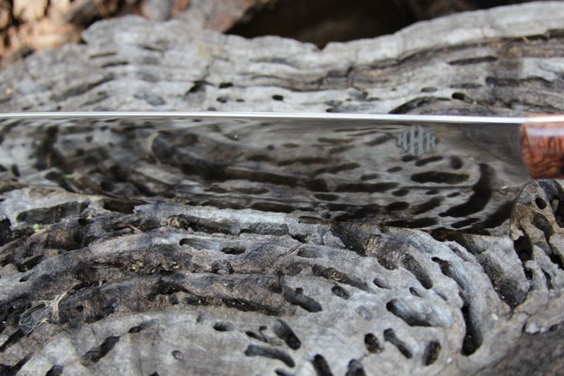

Blade is CPM154 Rc 61, 244mm, 9 1/2" on the edge. Heel height is approx. 52mm spine above the heel at 2mm tapering to the tip.
Thanks for looking, as always, comments and critiques welcomed.

The handle is Honduran Rosewood and its natural. The blade specs are listed above.
Nice one Randy. Love all your knives, but I do tend to favour ones like this - clean, crisp design but still very classy thanks to the rosewood burl and mosaic pin
Thanks much guys! The design has a Japanese influence. and makes a great working tip. Just my opinion, and from other pro chefs and guys that work all day with a knife seem to like the lower tip and a somewhat flatter profile. Thanks again its great to hear from you all!
