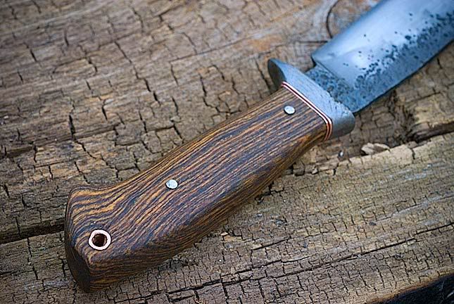

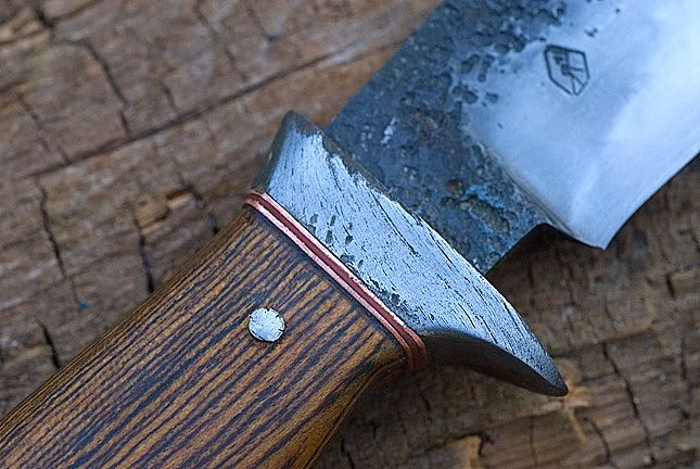

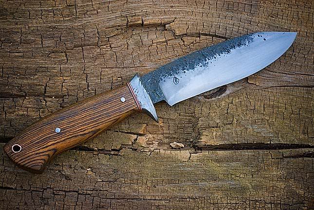

Here is a 11" OAL hunter forged from Aldo 1084, hidden tang with morticed, book matched scales of Honduran rosewood, peened stainless pins, peened copper lanyard tube, wrought iron guard with a half twist during forging, pitting and vice marks left in and etched in ferric chloride. Some clay on the spine for the quench.
