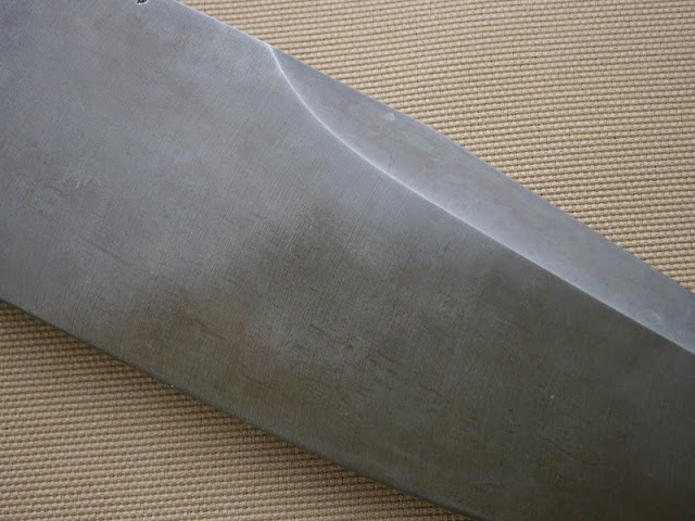

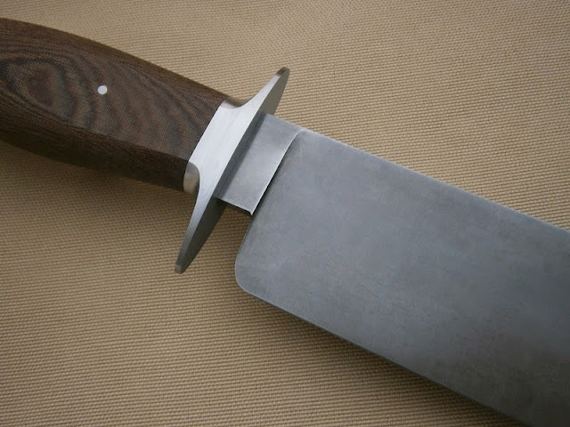

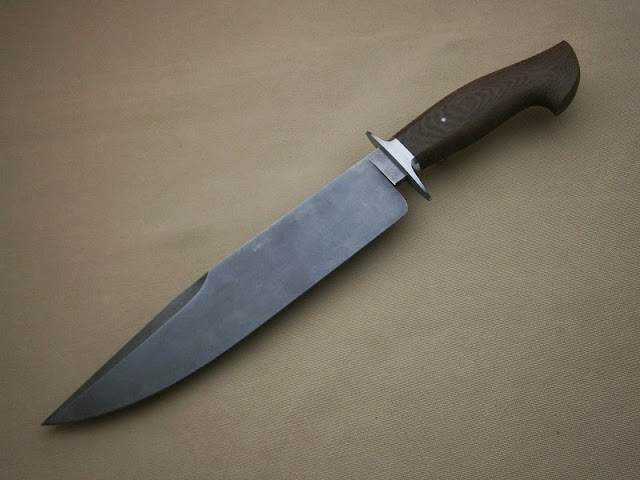

I finished this one a while ago, but forgot to post it here.
The blade is forged 1084, machine finished and etched, with a sharpened clip. The handle is brown canvas micarta, and the guard and pin are 416 stainless. OAL is 15 7/8", with a 10 1/2" blade.
Thanks for looking.
I dig the finish; I always feel bad scratching a good finish when I start to use a knife but this begs to be used and looks like it could handle anything that came its way.
Great job - what width is the blade? looks pretty massive contrast between handle and blade.

I can't tell from the photos how is the distal taper from the guard down ?
Thanks mate. I don't have this knife anymore, so I can't measure it, but I'd say it's just shy of 2" wide.
Thanks Joe. Any distal taper on this one is so minimal that it's unnoticeable; The real taper begins at the clip. Even without radical distal taper, it feels very lively in the hand.
You're in the zone mate. If I were about to fight and the other guy had this, I'd run!!!
